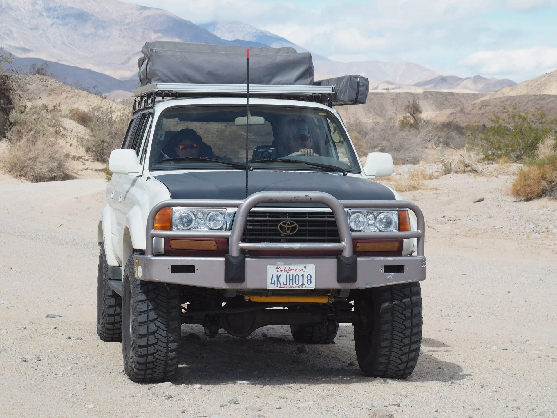

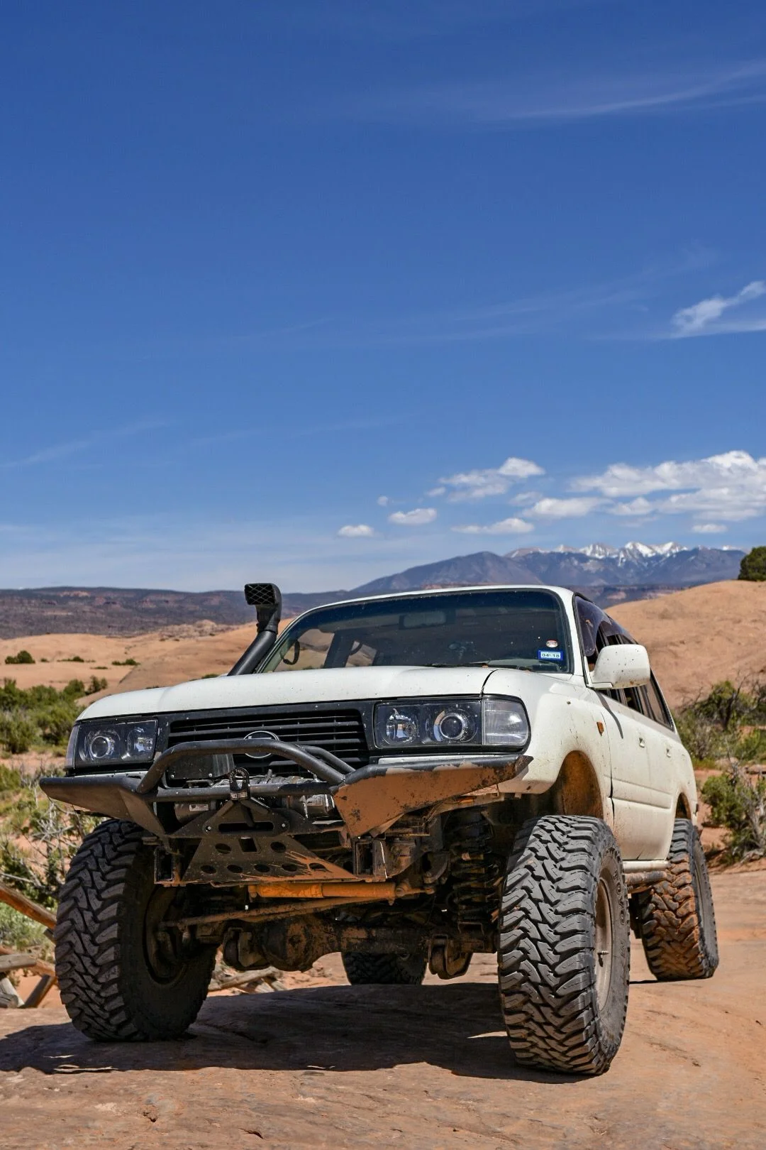

They look a lot like the ones that came on mine, but with the housings blacked out. The brand is Sonar, i don't know the part numbers for it, but I do know that when I looked into them, I couldn't find any information on them. They were installed in Japan.
full
full
That's with the HID kit installed.
They have low beam projectors in them, the halo rings and little bottom LEDs can be lit up too, so they're a bit on the blingy side. They were DOT approved, but the light cut off was backwards and I had to flip the shields so I could run them on north American roads.

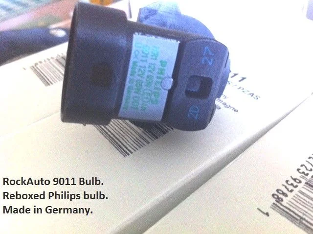

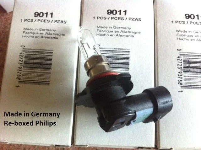

Thanks for the heads up on the cheap Rock-Auto bulbs. 6 of these just landed on my porch as well and are also labeled as Phillips bulbs. I'm looking forward to a night-test soon.
Did yours come in a big Ol' honking box? Sheeeesh... Rock Auto must have lost money on just the packaging.
HUGE box...stuffed full of filler, bulbs inside of another smaller box that contained the white box the bulbs were actually in. You would think these things were radioactive or something. Maybe they hire ex-drug smugglers to package them? ;)
ha, yeah same packaging only some of the little white boxes were directly in the large box and a few were in their own individual brown boxes as your's were. I went ahead and ordered 6 bulbs to have a few spares on hand since, I'm guessing the low beams won't last too long, and I assume that all of the intermediate size boxes wouldn't fit so they unpackaged some of the bulbs to get it all into one big box.
