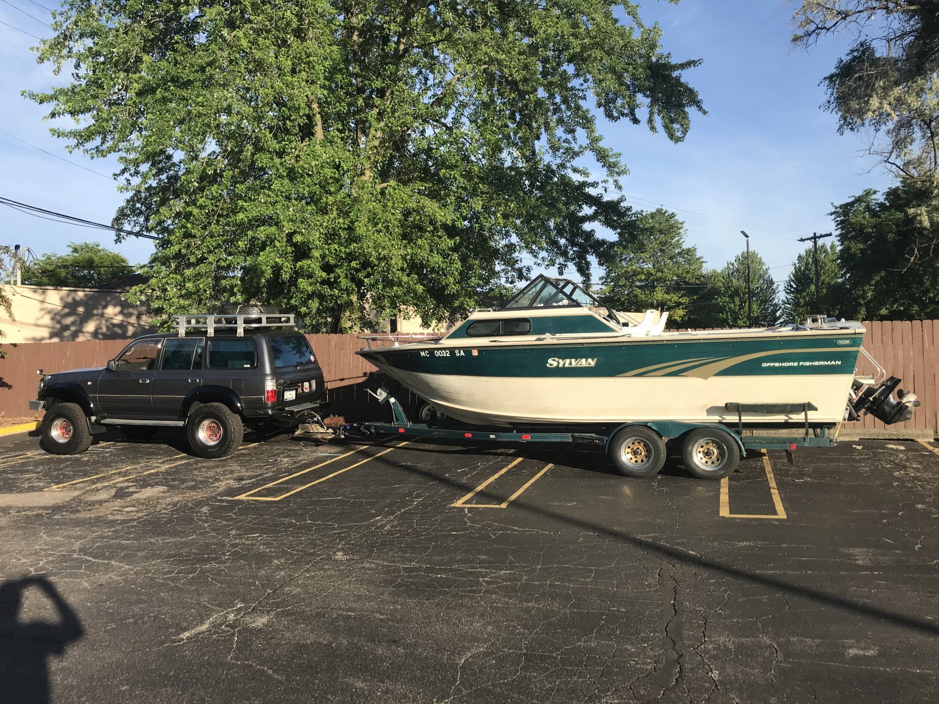

I drove from Clover, SC to Detroit, MI today and bought a boat 23' boat. It is aluminum, so it only weighs about 2400 pounds. The ol' HDJ81 pulled it pretty well back to the hotel. The real test will be on Thursday when I pull it back to South Carolina.

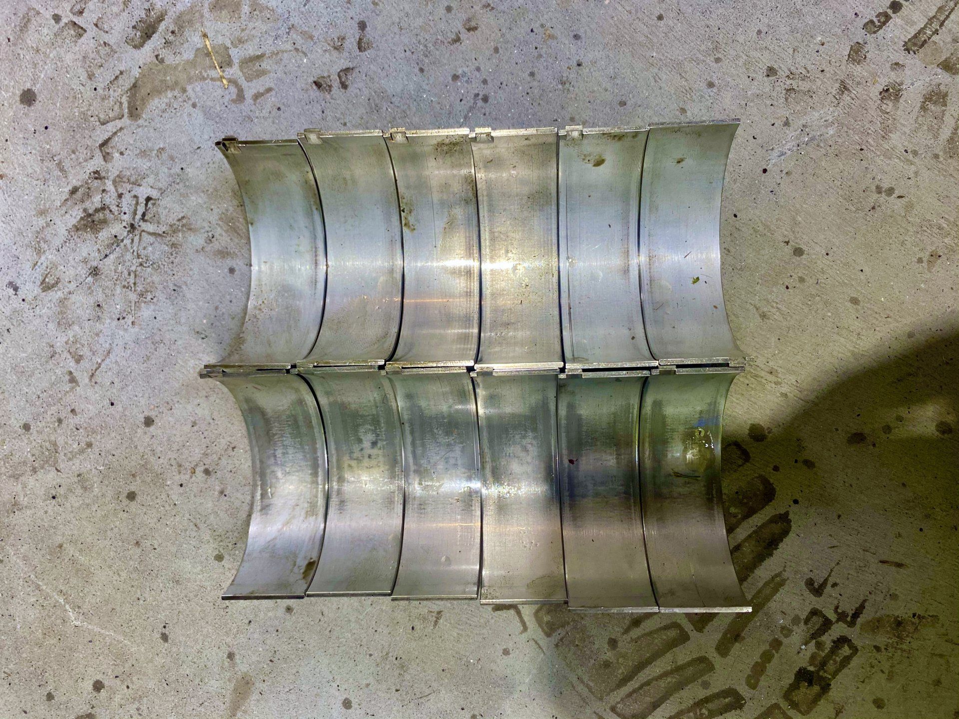

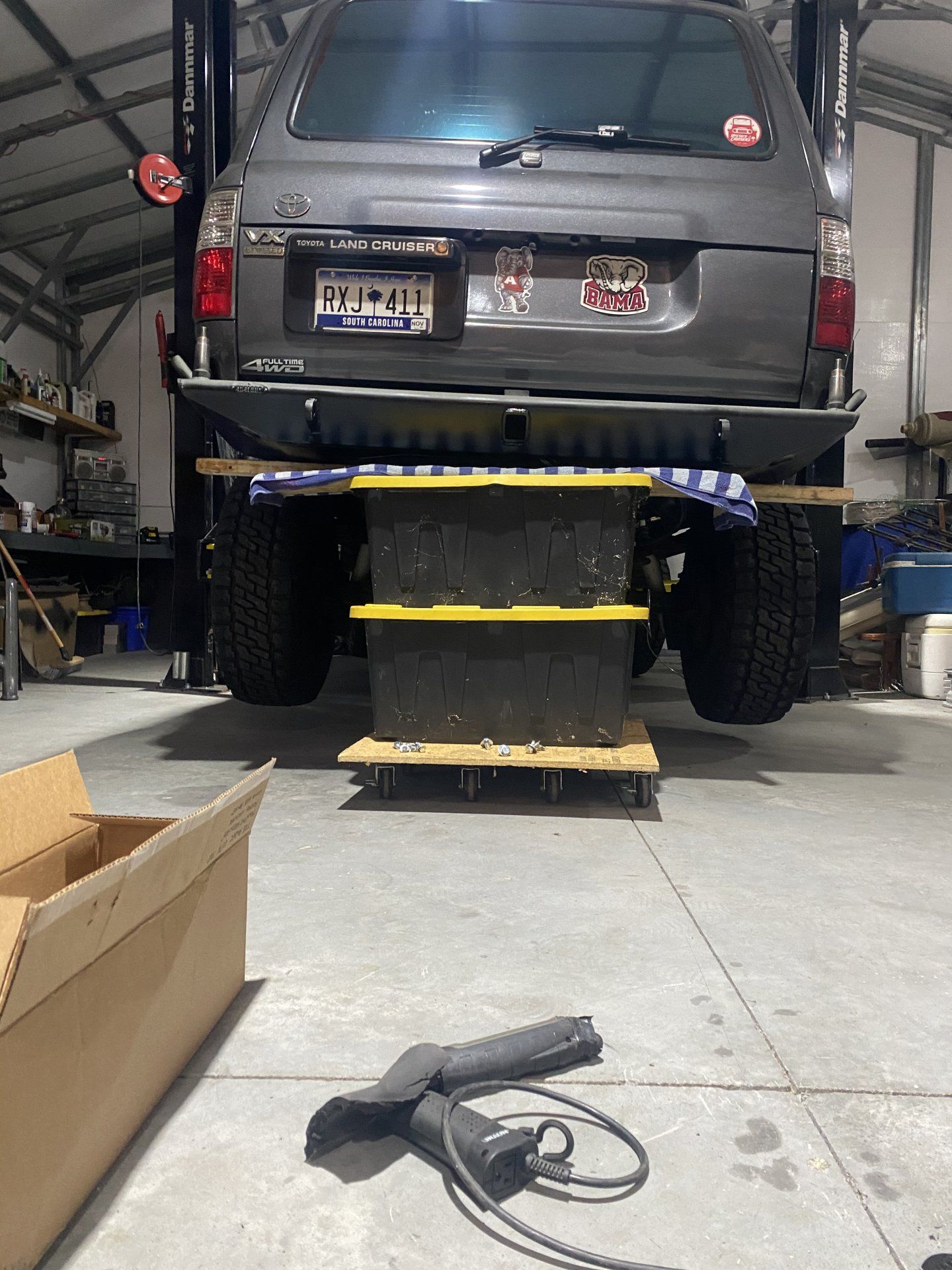

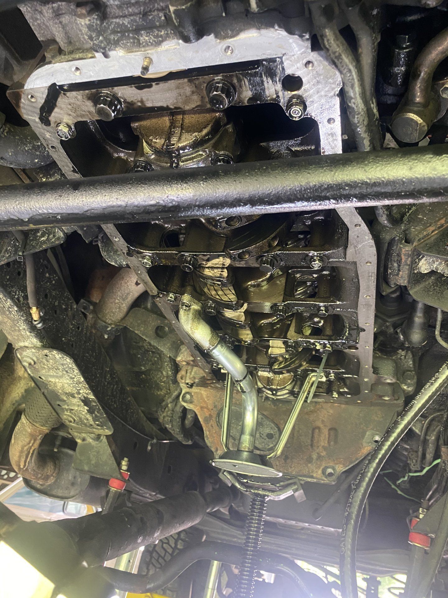

This morning I installed a new set of Big End Bearings into the ol' 1HDT. I don't know when they were last changed, so I bit the bullet and changed them out. It was a relatively easy job, and was done in about three hours from start to finish.
The old bearings didn't look that bad....
The oil pan was clean with absolutely nothing on the magnet. I am feeling pretty good about the internals of the engine after having a look inside. Over the next few days I will be replacing the water pump and timing belt.

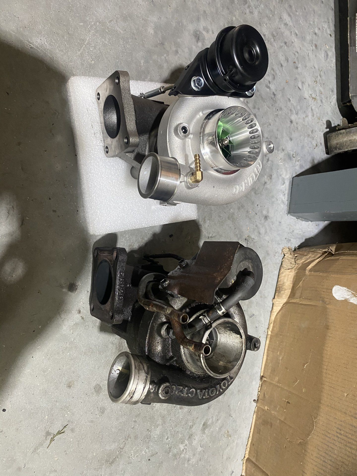

This morning I ordered a G-Turbo Grunter Extreme turbo. Rhys was very helpful.
The G-Turbo Grunter Extreme turbo is in and working fine. It is maxing out at 17PSI without adjusting anything (reference for boost is past the intercooler at the intake manifold, and not at the turbo). EGTs seem to be lower, but I will have to tow with it to be able to compare apples and apples.
I can honestly say that replacing the turbo on this thing was the biggest pain in the butt that I have undertaken in a long time. The G-Turbo is a direct drop-in conversion. I don't know if I would have been able to do the job without my two post car lift... I probably could have done it in half the time if I did not have nerve damage in my left hand (thank God that I am right-handed).
Ten hours and about a quart of blood, but it is in!
The sad part about installing such a beautiful piece of engineering is that nobody can see it, once it is installed....

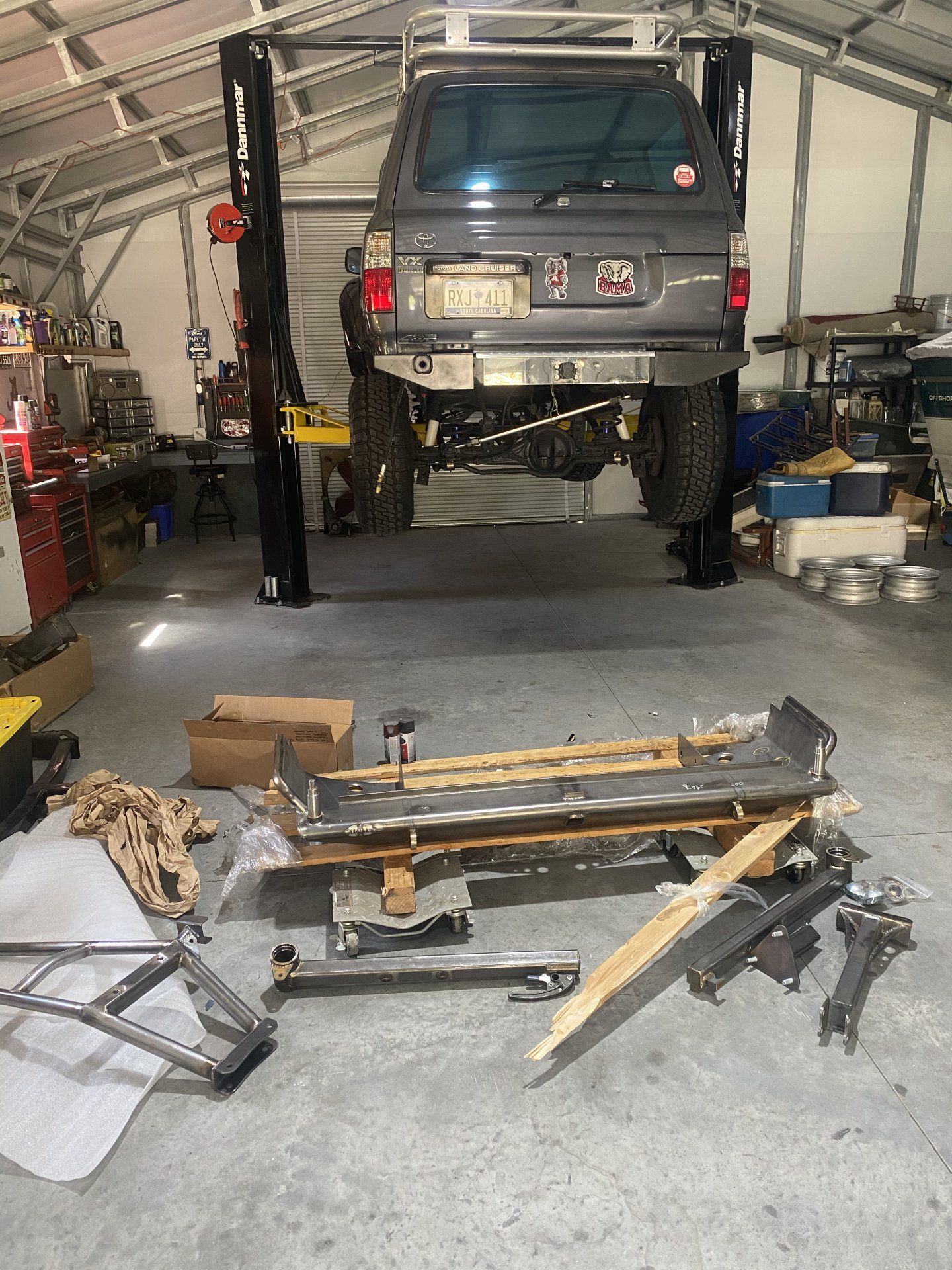

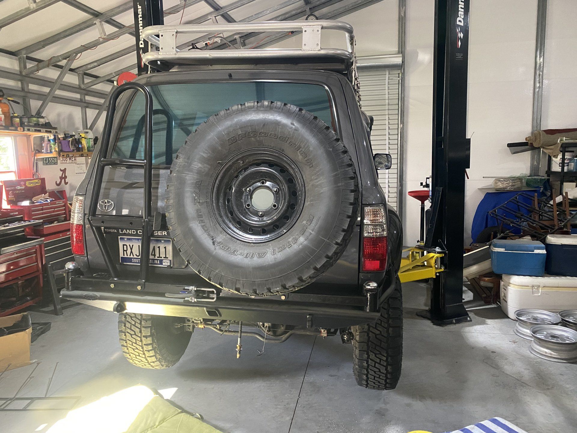

My 4x4 Labs bumper finally arrived. It looks great!
I can't wait until I'm off the clock so that I can get started...
