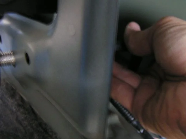

Pic 1: The bolt
Pics 2 & 3: How it should NOT(?) be done. Do NOT use your hand to hold the bolt/nut up behind the panel as I did. I had to get a socket wrench(?) for the allen(sp) bolt after I lost two allen wrenches in the body panel. :crybaby:

Impression:
I've had them in there for almost a week and I have felt pretty good about what I have done.
They catch whenever they are yanked or whenever I'm decelerating quickly. The kids like them and most importantly, I feel (much) better about having the safer seatbelts there for them.
If you do not make the same mistakes I've made and have the proper equipment to do it, this mod shold not take longer than 1.5 to 2 hrs, max!
