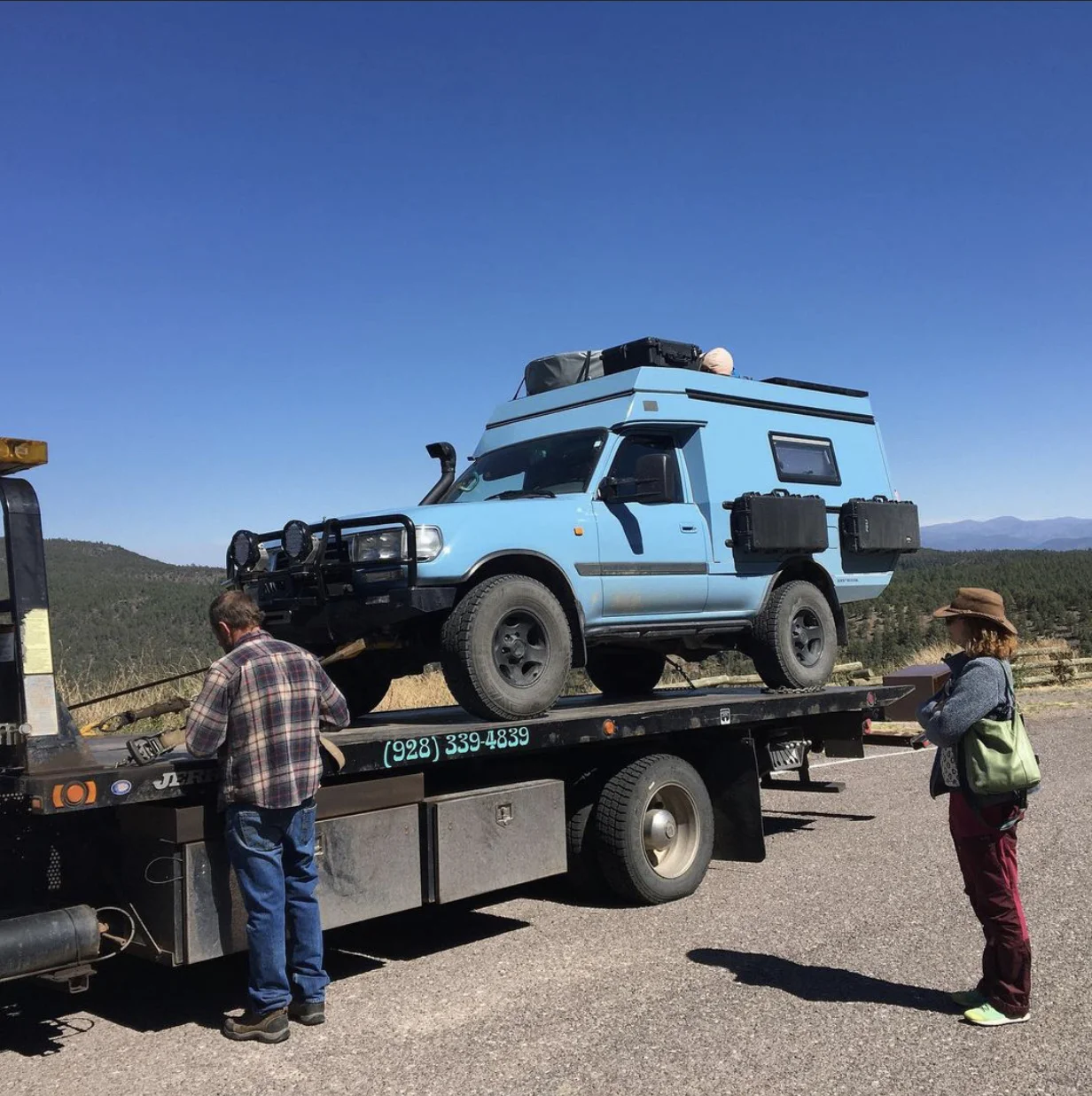

I know @wngrog hosted these guys and is aware of their situation, but I wanted to post up on here to see if anyone can help them out. Really cool couple with a killer 80 series camper conversion with a previous HDFT/A442F (manual converted to auto as I understand it) has fried some wiring. They're stranded in the Phoenix area with the dash pulled and tracing fried wiring. They may need a wiring harness or may need just some wiring help.
You can reach them on IG @ 2machenblau.de Or reach out on here and I'll try to link them into this thread. Tag anyone that might be able to help.
As I have it from them on the sequence of events:
- stopped at a viewpoint, engine & AC running.
- took pictures, wants to drive off.
- when switched from P to D we noticed the AC\Blower not working, dash completely dark and no gauges working beside the fuel.
- Guage fuse 10A was blown
- replaced it and blown again after 2s in the 2nd key position.
- a shop in Alpine AZ towed us and started the investigation, used a 30A fuse in the gauge socket. not sure how much of the discovered damage was caused by this.
- then we removed part after part from the IGN line but still blowing.
- engine will not start as the 12-24v timer relay needed IGN too
found a melted wire behind the fuse box and removed today the dash completely to discover more melted connectors. these connect the dash harness with the engine bay. not sure how far this damage leads. dash wiring has several melted spots.
- root cause still unclear.
- ABS connector in engine bay is melted too.

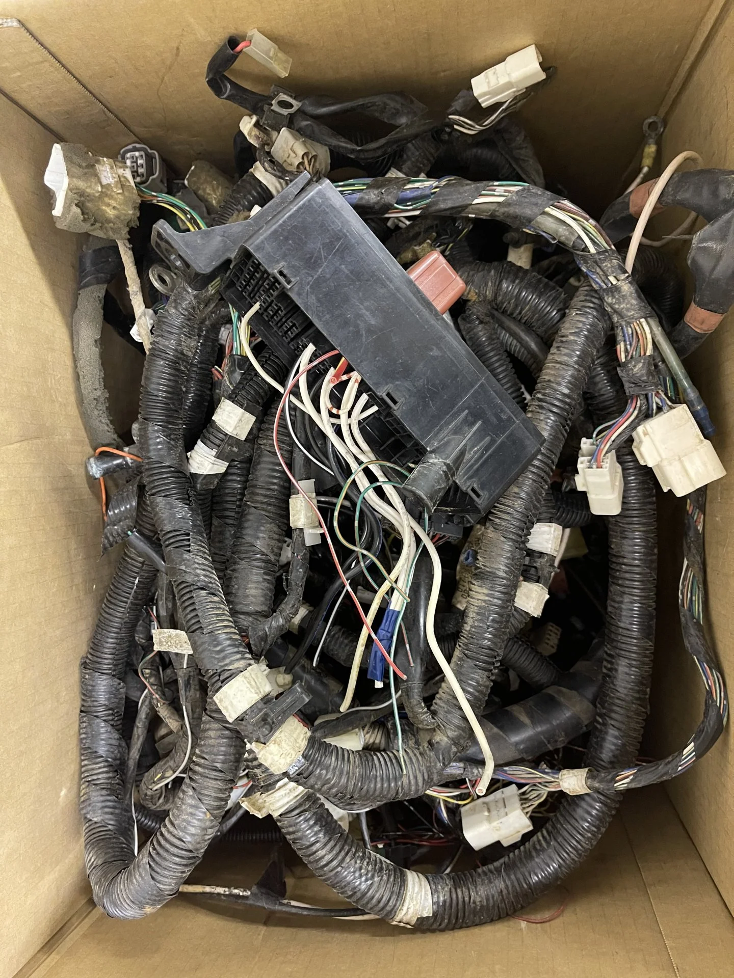

If they could get it up here to Boise, Idaho we can trouble shoot and fix it. I can tell you/them right now sourcing an HDJ80 wiring harness (dash/engine bay) in either RHD or LHD is going to be difficult. IIRC they are both NLA in RHD and LHD. @Onur am I right? We do have sources for used. Best bet is to fix what they have unless it is completely wasted.
We have all the wiring diagrams for 1HDFT and HDJ80’s. I have a guy working for me who is a wiring wizard and we can definitely set them straight but they would have to get the Cruiser to our shop. On top of that it could take some time to fix and cost a fair amount.
Happy to help if they can get it up here, also willing to help with and even arrange shipping of the Cruiser to our shop.
That is the best we can do. 🤷🏼‍♂️
Cheers
Yeah, all of those harnesses are all long gone.

While in alpine a jump start was attempted to the secondary battery. At some point in the truck’s history the fusible link off the main battery was replaced with a pair of standard wires; I’m not positive as to whether this caused the bigger problem we’ve encountered, but it is suspect.
As of now, we have discovered severely burnt wires in the dash harness, going into the AC system, going into the ABS under the hood, as well as the fried fuse block wire, and portions of the transmission swap wiring harness which was run in parallel to the dash harness as well as tapped into the main dash harness in a couple spots.
Whomever did the transmission swap pieced the truck together as best they could, but not in the most logical or polished fashion. A harness goes to the transmission TCM, which is mounted in the secondary battery box in front of the battery, to the core support, then branches off and goes down to the transmission.
In addition to this, other issues have been described, such as the engine temp climbing a couple times, as the gauge climbed towards red. A quick inspection of the cooling system has found a few leaking hoses, an aged radiator and heater valve, and an aged radiator cap. Coolant is not in the best condition. No further inspection to the rest of the vehicle has been performed at this time.
So far on this trip, they’ve had issues with the alternator as well as either the brakes or a knuckle stud. I only caught part of this story, as they told it to someone else so I cannot confirm which.
The dash harness is not completely removed yet. I’ll know more tomorrow, but the question of what other issues lie where we can’t see them still remains; so far we’ve seen damage to the engine compartment wiring and dash wiring, but how far does it reach to other areas?
