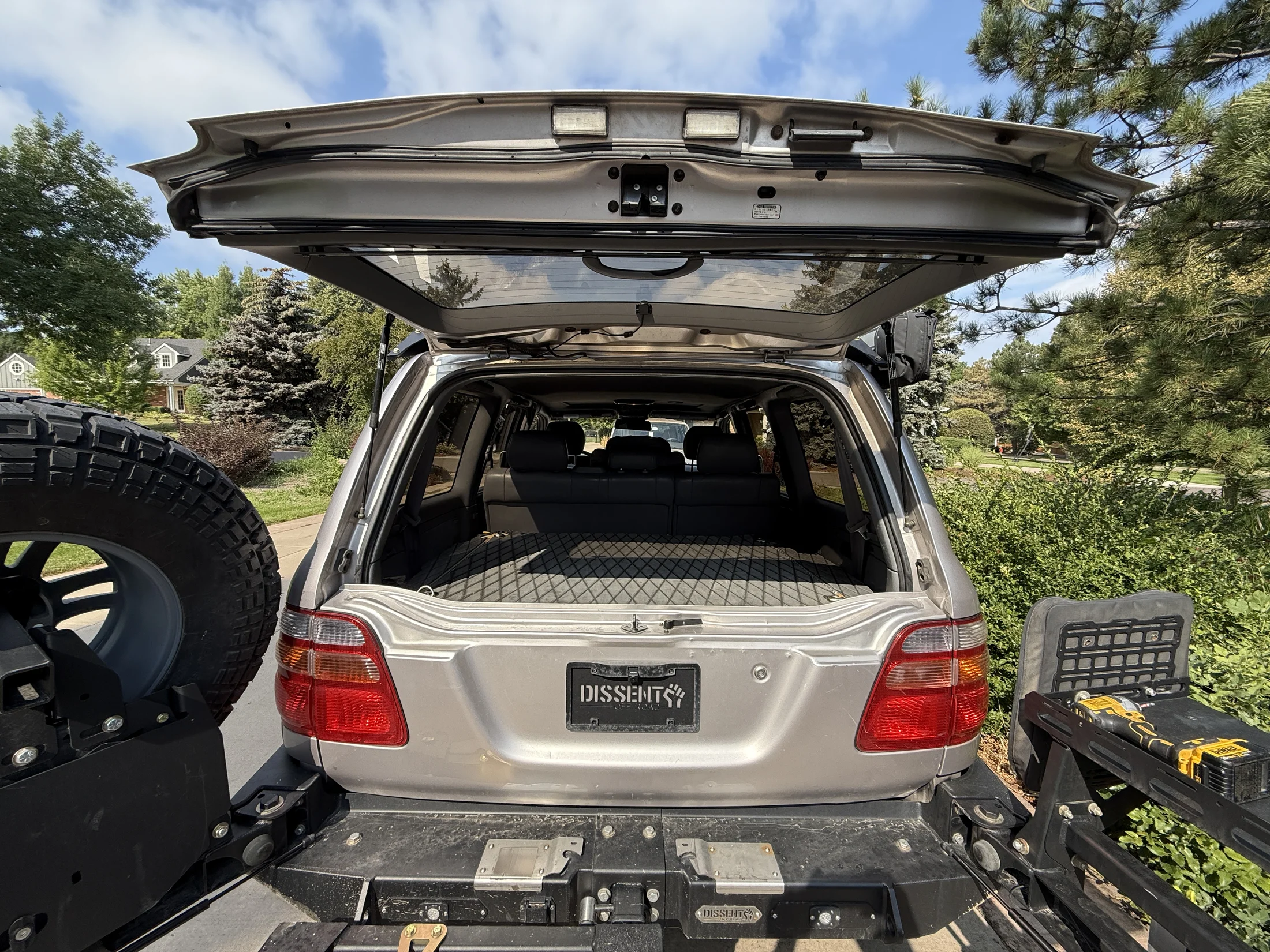

I hadn't opened my hatch for a couple days then went to and found this. -see videos- Does anyone have any ideas how to go about this? I am not even sure where to start on this.
I was unable to get it to open from the inside too, I can hear the door mechanism unlock.
No major changes since last time I opened it. All street driving.

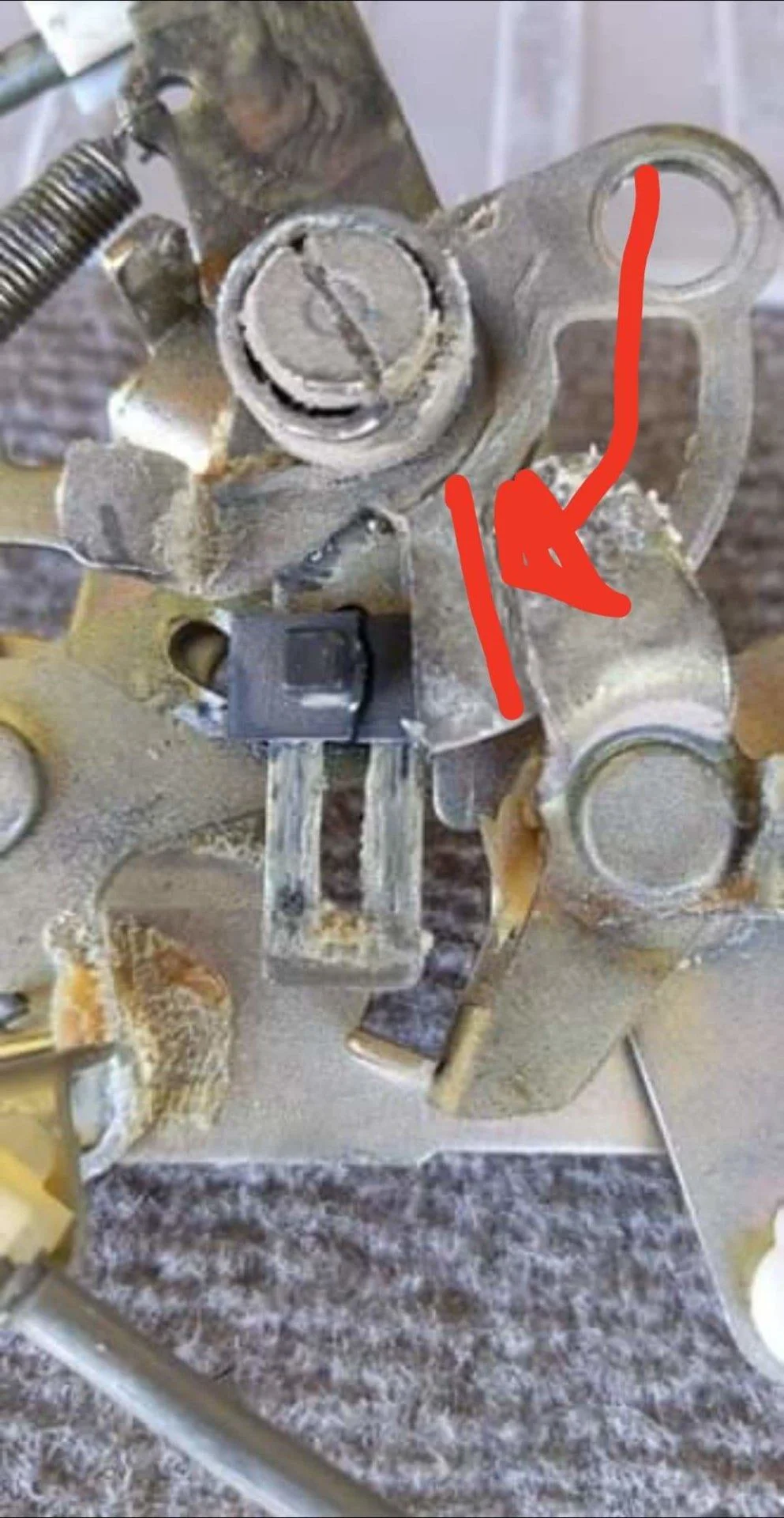

So I pull the carpet and those cables were connected. I ended up pulling the handle and I was able to see the cables responsible for releasing the hatch.
The cables are connected and do what they are supposed to, but all of the sudden they don't have even travel to release the latch.
I'm thinking I need to pull the plastic surround off to gain access to the opposite end of the cable to see what is affecting the amount of pull it gets when activated by the handle.
At this point, I'm just documenting for anyone else that has this problem.
The latch release mechanism has this small plastic piece and I noticed it was not going as far as it needed to. Upon inspection, the plastic had cracked and just flexed on the later part of the motion.
Going to try some super glue. I'm not seeing any other way to replace it other than the entire assembly.
This is the replacement part:
Upon reinstallation with the superglue, the mechanism broke again after only a few uses. I am going to try either epoxy or some kind of bolt/nut/washer combo to see what will work. I'll update again for those who may have the issue in the future.

I had this problem and was not going to spend that much on a new latch mechanism, so I 3d modeled the clip & 3d printed a handful out of ASA. Fixed the problem for about 10 cents.
Would PETG work? I have a ton of it, but I have not printed with ASA. Thank you for the .stl!
I used PETG for my try and it is still holding strong after a few weeks, had a buddy who could print ASA so I got a handful. did 100% infill and sent it worked great.
