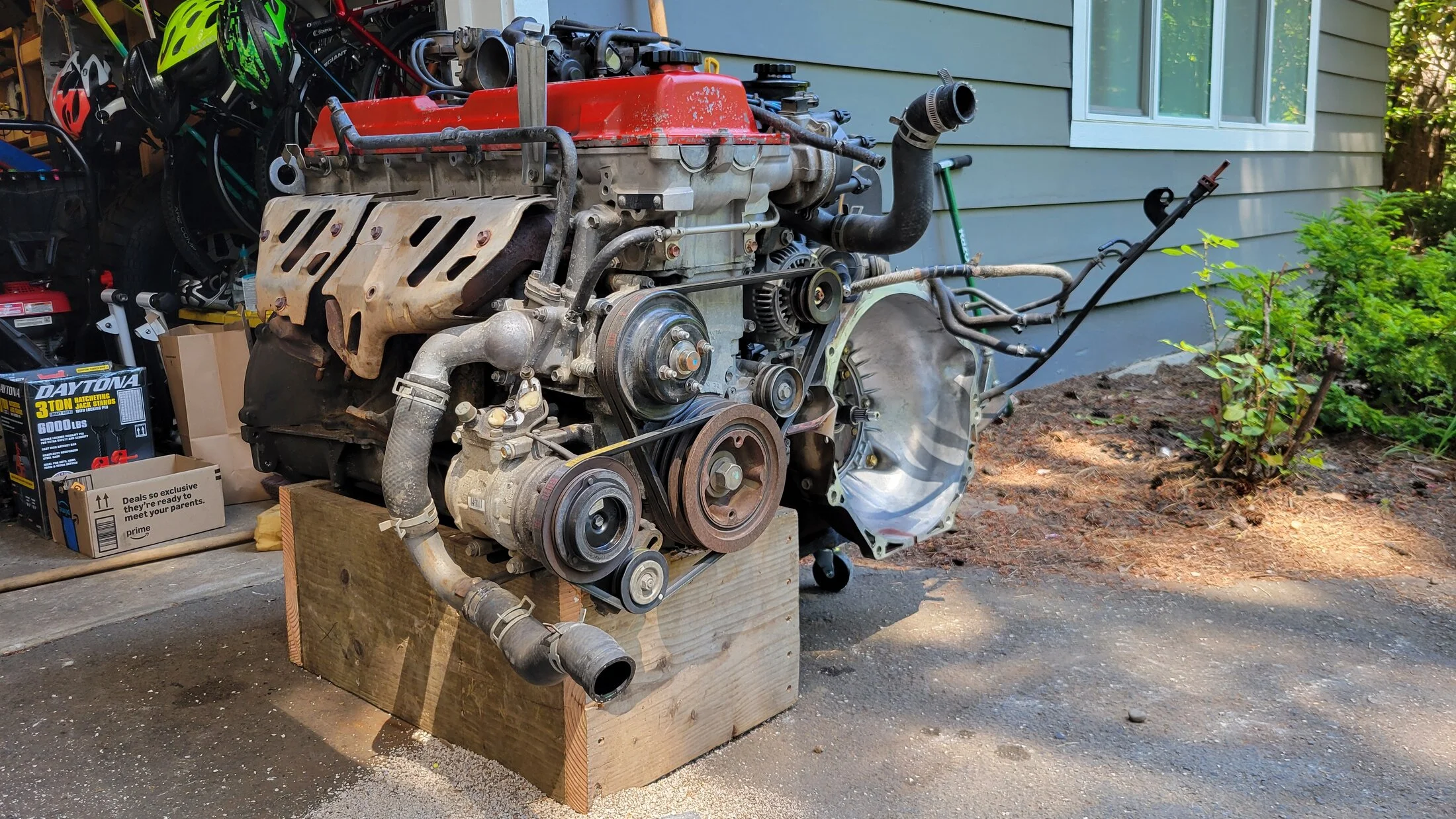

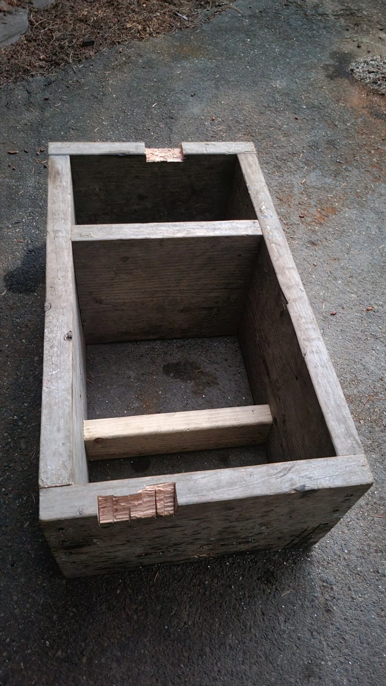

I build one recently thinking that the engine will be stored for a long time, but it sold withis 2 days. The cradle was built out of 2x12 lumber. Pan or crank sensor not toucking anything .

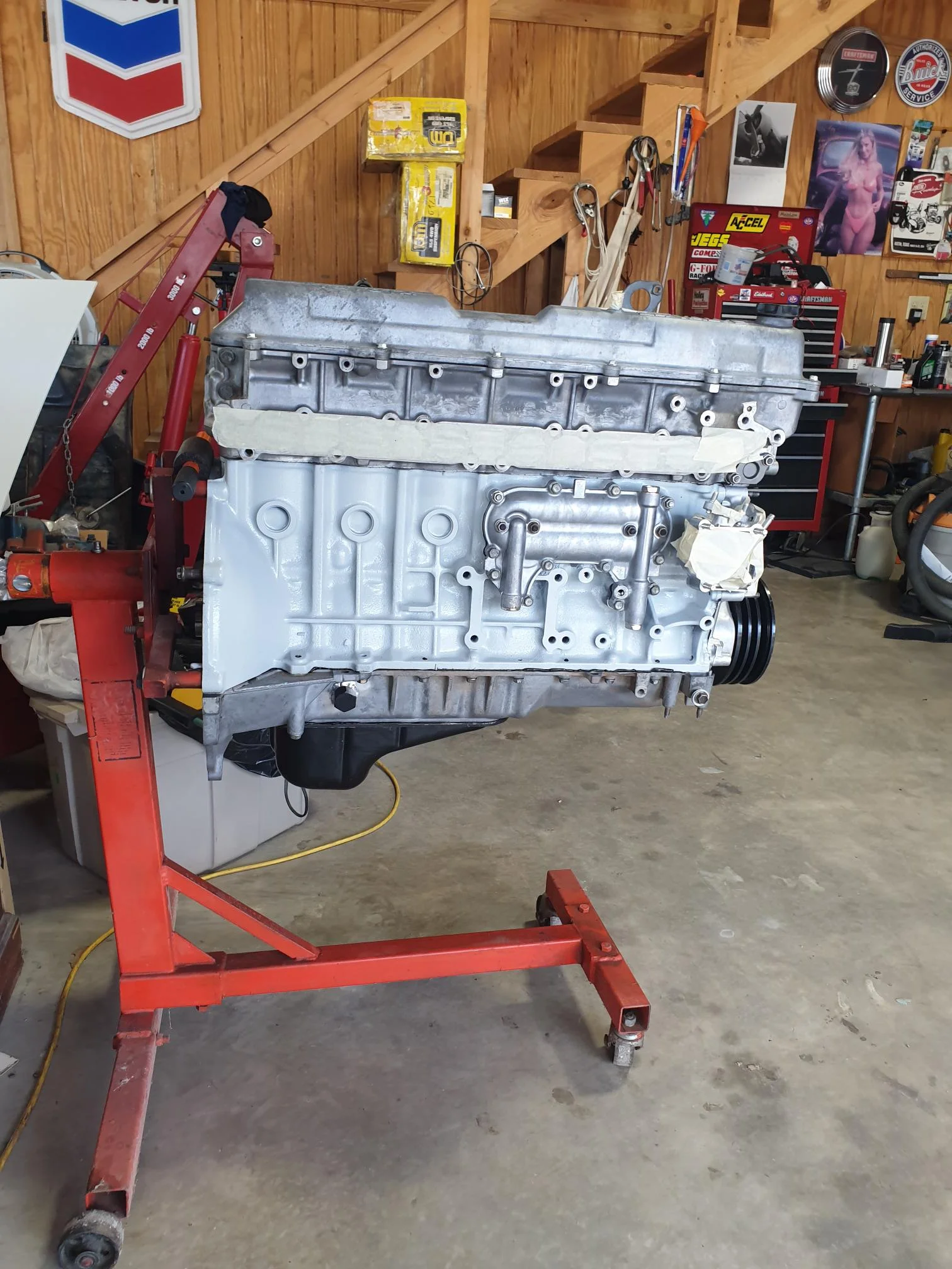

I put mine on an engine stand that we use for BB Chevs, Olds and Ponitacs. It will move a long block around but there is no way I am hanging all the manifolds on both sides and going to trust it without lengthening the stand. We had to weld the brace above the gusset at the bottom of this stand decades ago to support 455 Pontiacs. The length of our blocks places a lot of weight over the front wheels on this stand.
