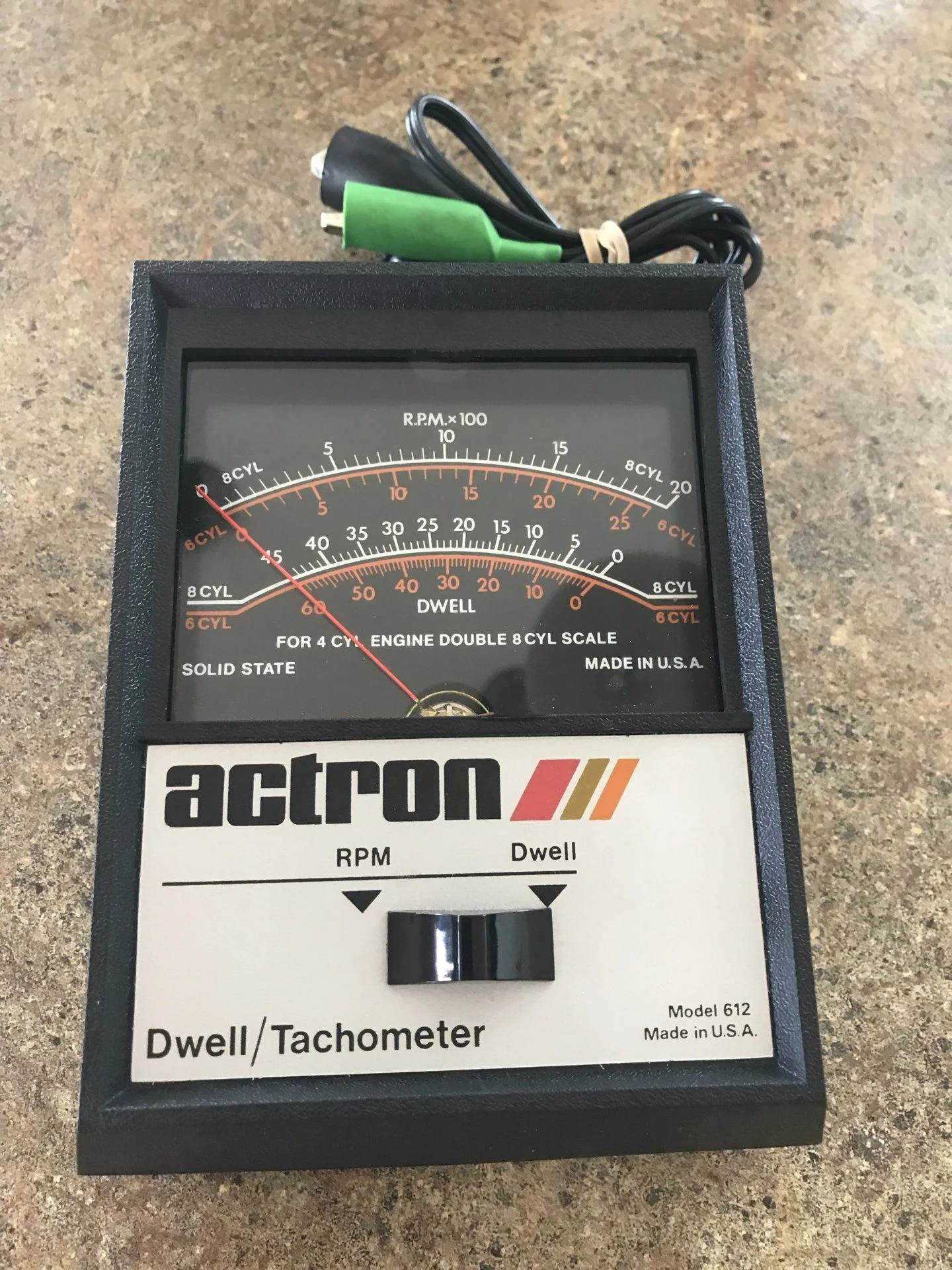

When @65swb45 was here, he noted that the distributor shaft has some play in in, and that this may be responsible for how poorly the truck runs, rather than the carburetor. He said to sort out the distributor first. He asked me, "Do you have a dwell meter?", to which was my immediate answer, "Nope." So, I ordered a dwell meter. It's on the way. I have no idea how to use one, and only a vague idea of what 'dwell' is, but I'm not gonna let silly details get in the way. Mark suggested I tackle one thing at a time, and to go after the distributor problem first.
So . . . . . I'll check and adjust the dwell, I guess, and try to get it where it needs to be. Mark, where does the dwell need to be? I know I know you said write this down and I didn't, so I hope you'll tell me again.

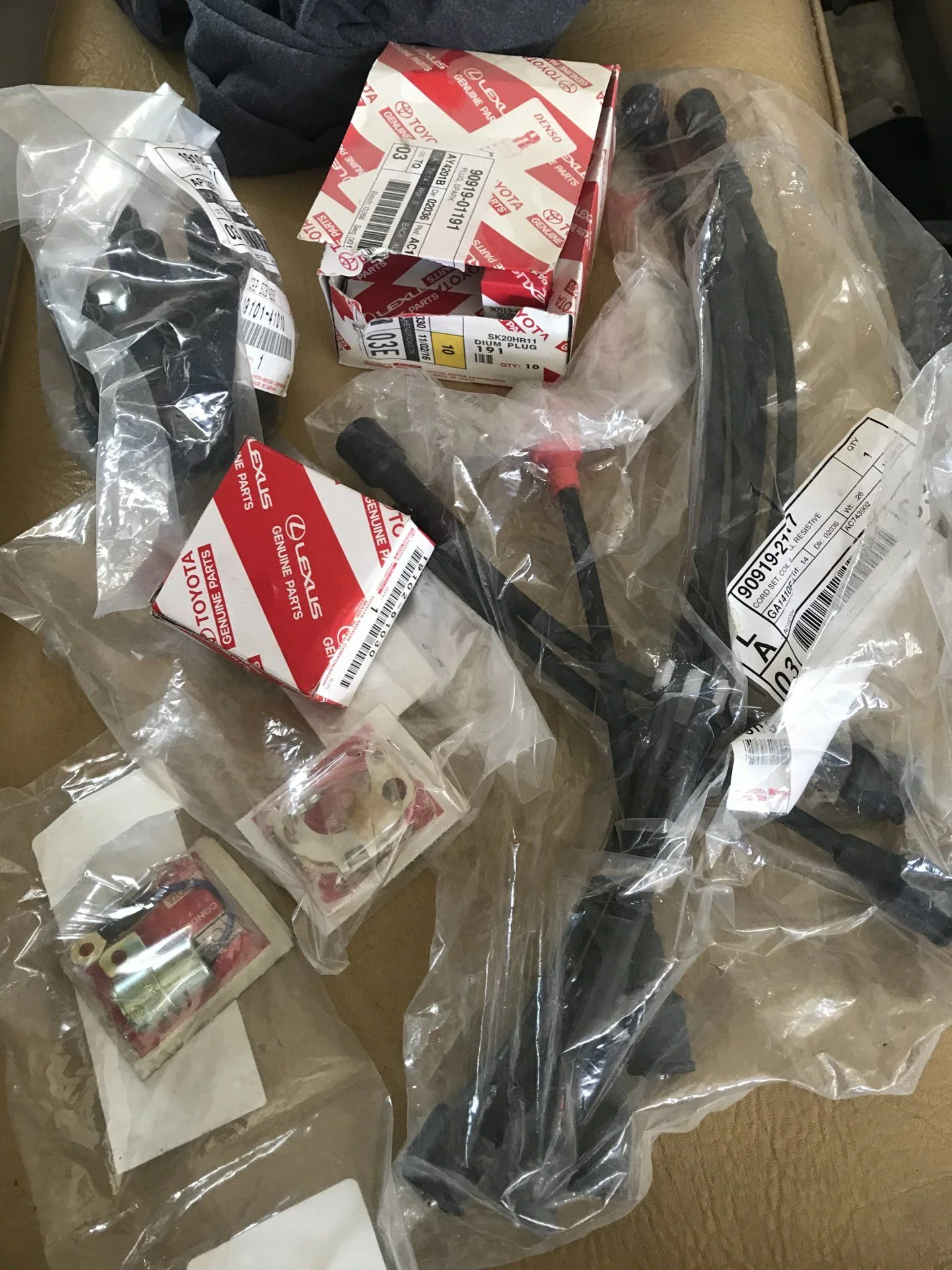

I looked thru all of the parts I bought a while back, and I have new plugs, new plug wires, new coil wire, new rotor, new distributor cap, new points, and new condenser. Mark, shall I replace all of these parts now? Before I check and set the dwell? Or after I check and set the dwell?
Or shall I replace these parts one at a time, checking how it runs in between each replacement? Or maybe not? Or maybe it doesn't matter?

If memory serves dwell should be 40 to 45 degrees.
38-41.

My dwell meter arrived.

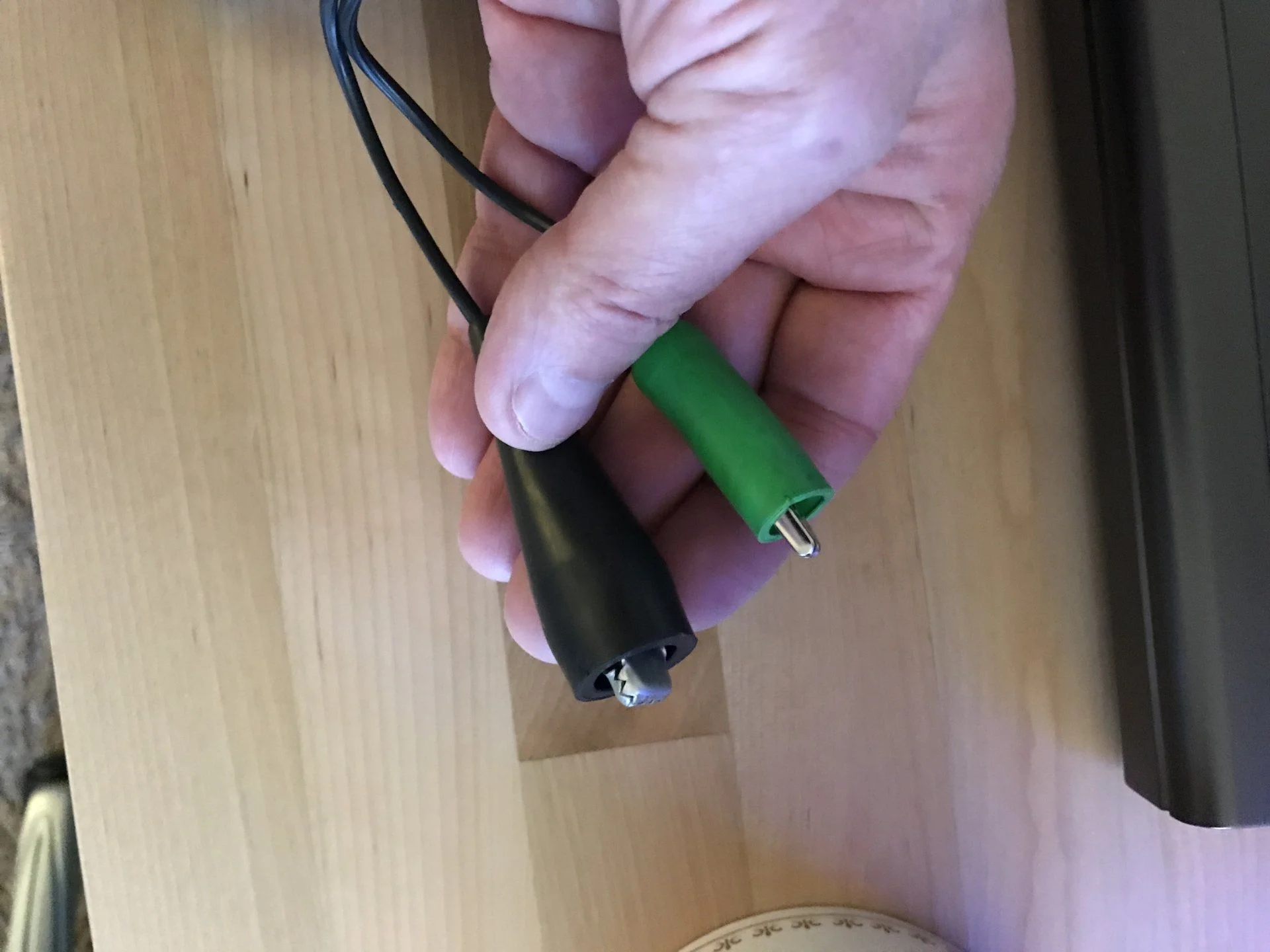

I have the worst-running FJ40 on these boards, bar none. It takes a few shots of starting fluid to get it to start, plus revving and feathering and fiddling with the choke knob. After a few minutes, it will idle erratically. Sometimes it dies. It's really bad. I've driven it a few times recently. It runs horribly. I hardly know what to do. When @65swb45 was here a few months ago, he suggested I focus on the ignition, specifically the dwell. So I have a dwell meter, and today I am going to check the dwell. Here's some pics . . . .
I think the green is supposed to be connected to ground.
The other has to connect to the negative side of coil.
