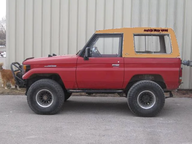

hard top for ragtop 70 series

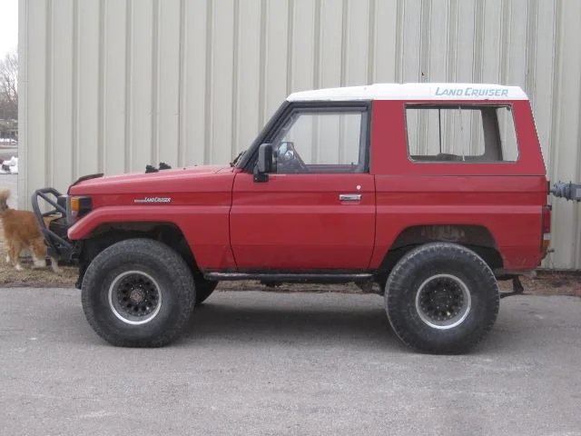

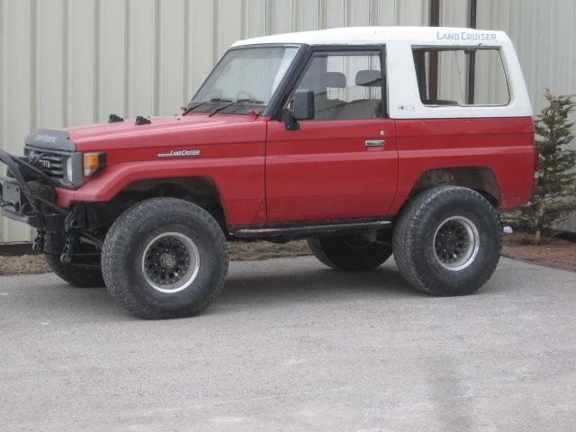

Cool, I guess the original side glass will fit? you wont be able to open the windows as wide though.
Every time I see this truck I want to build half doors for my 74. Love this project and that beast of a Troopie you have going! Congrats.
the side glass out of a solid top 70 will have the frame cut 3" in length so yes, the windows will not open as far as stock.
I could cut that sucker as long as "off white" wood putty was available at the local hardware store. I assume they still make 1/8", 1/4" and 1/2" wood putty.:) Heck, off-white duct tape may even be available.:)
Rear windows are over rated.

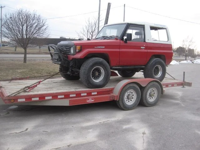

picking it up from Gozzard

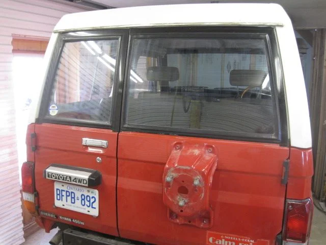

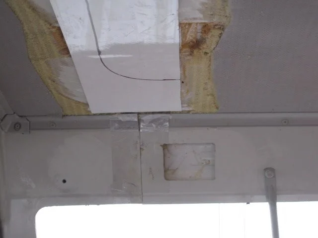

the outside looks really nice, the strengthening patch will be hidden behind the new headliner when it goes in.
the seam from the outside.

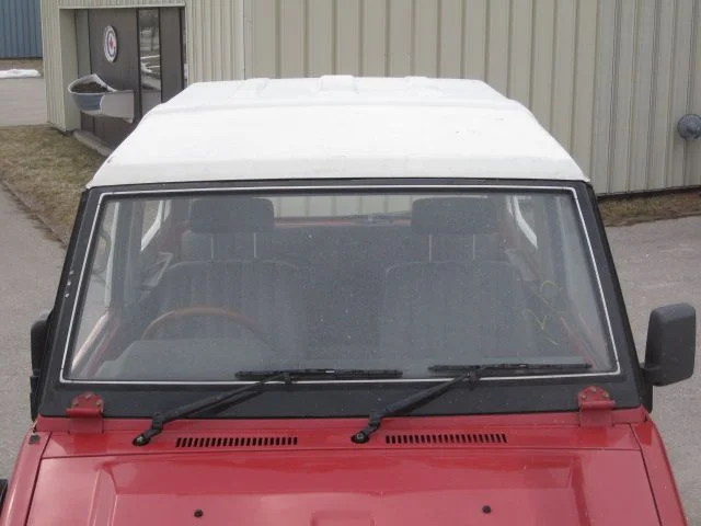

more pics of the top from the top...

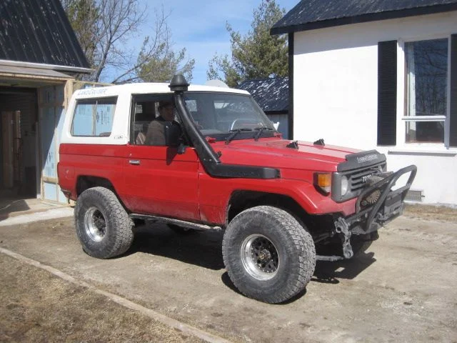

loaded for the ride home

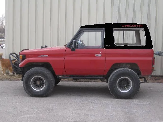

keep it white, i think the white goes well with the red.

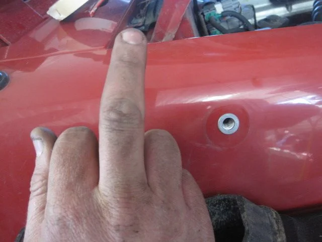

replacing the alloy pop rivits with nutzerts as well as the hidden nut needed on the fender ...

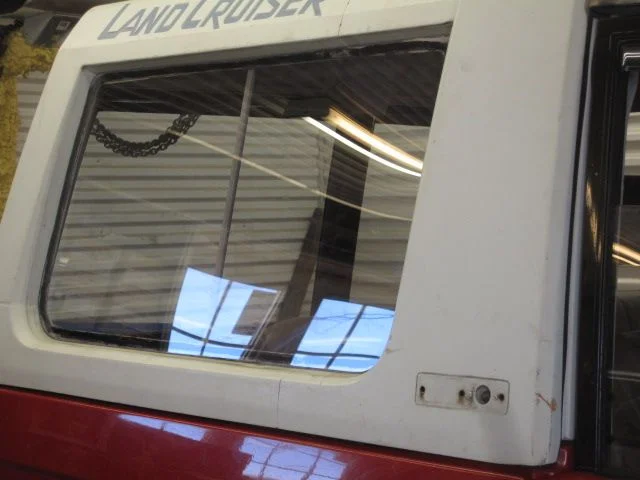

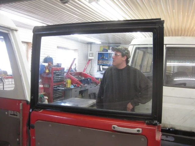

the BJ70 windows are too tall so i have a set of BJ74 windows on order from John at Radd Cruisers. Nice guy to deal with and very happy with the switch from my previous supplier of parts.
lexion glass as temp fill ins since i have a wheeling run next weekend.

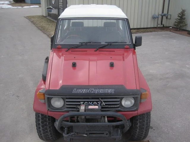

finished for now till i decide on the paint and get the windows modified to fit the shorter top.
Mitch coming back from the test drive.
