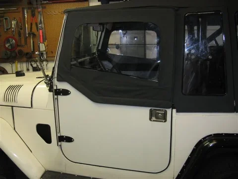

More with the wing.... 1st is in progress, 2nd is finished.
I lengthened the actuator rods with square brass tubing. The door handle is mounted, where the window handle was mounted originally, with nutserts from the top part of the door.
The lock works. Kinda dumb maybe, since there's no window.
In the top picture you can see three holes I drilled to mount the door panel. In the bottom picture they have the original plastic inserts in them.
All the hardware I used, besides the brass, is Toyota OEM.

Maybe this year after a rear bumper, spare tire rack, rock protection, rust repair...Missed this, sorry. They aren't heavy at all. The tops are 3" muffler tubing. The only issue is how long it takes to make them, and my crappy door panels. The driver's side is still not finished on the inside. I just mounted the outside handle.Maybe this year after a rear bumper, spare tire rack, rock protection, rust repair...

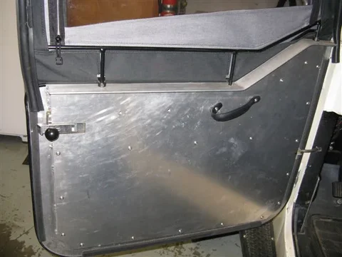

Here's my doors. A work in progress
Other side
