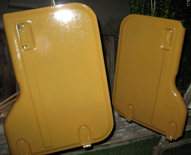

Eric and I got together one day last week and got working on this year's half door. :meh: I took last year's home with me for some finishing.
The door panel came out like sheot. The lock and door handles came out great though.
The door itself is more solid than the original door since there's no window rattling around inside.
I lengthened the actuator rods with square brass tubing. The door handle is mounted, where the window handle was mounted originally, with nutserts from the top part of the door.
The lock works. Kinda dumb maybe, since there's no window.
In the top picture you can see three holes I drilled to mount the door panel. In the bottom picture they have the original plastic inserts in them.
All the hardware I used, besides the brass, is Toyota OEM.

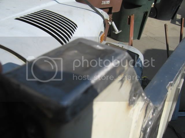

Here is my first attempt.
I did em for a mudder that is also in my club.
Im doing another set, but he wants to cut out the interior panel and skin it with steel.
My issue is, how to affix the steel skin at the top, have it look nice for him and his wife (most important) and save my sanity.
Chicago
He also had some NASTY rust on the bottom that I replaced.
It WAS NOT FUN, but it came out pretty well IMO. I was happy with it.
Had to get a lil creative with the break.

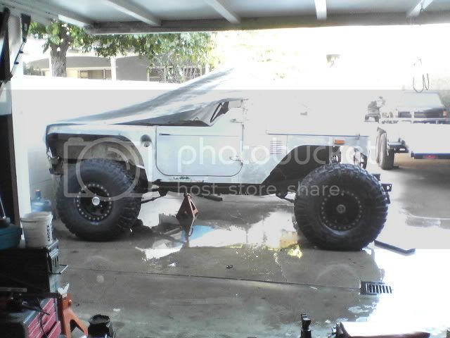

Cheers mate. Been working on them on and off for months so not sure how many hours are in them. To many. And still heaps more to go i imagine.
uted: frikken brilliant!
Those are awesome! Do the windows just roll down that far, or do they simply stay up?
Dan
Thanx. Windows will be able to be open or closed, still working out some sort of catch to keep them up. Vent windows work same as they did before.
