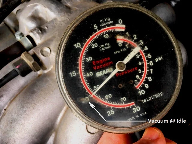

Pull the hose from the intake and with engine running, check for proper vacuum at the port.

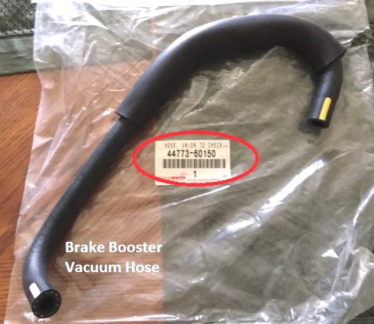

IF the hose is cracked anywhere, replace it. And if you end up replacing the Brake Booster, install a new hose as well.

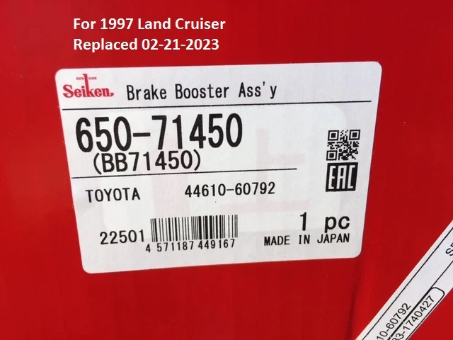

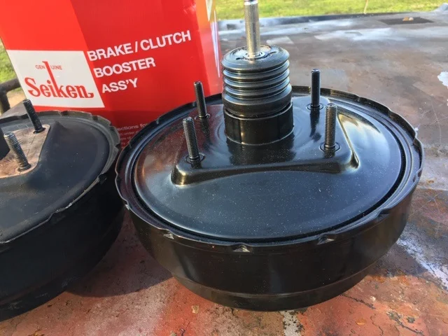

Thank you, Instead of Cardone, I decided to bite the bullet and will be ordering Seiken 44610-60792 from Cruiseryard.com for $565.99 including shipping and both gaskets.

The Seiken I received from Cruiseryard did not specifiy if the plunger was already set to the right height. I purchased a special tool off ebay only to confirm that the Seiken booster was setup perfectly out of the box.

As far as I understood you correctly, reading should be about 20 with engine idling? Should it be more than 20 if I increase RPM to about 2000?
Normal vacuum would be between 18-22 Hg (at idle, engine in park, engine unloaded). Naturally aspirated engine.
Increasing engine rpm (engine unloaded) will raise vacuum (assuming no restrictions).
IF you have restrictions in the exhaust system (plugged muffler or broken down CAT) then you would see a decrease in vacuum pressure.
An engine under 'load' will also exhibit somewhat less vacuum which is normal.
