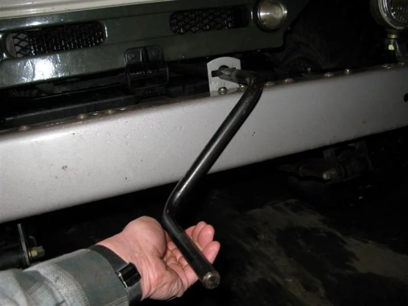

So who's used their hand cranks? How did it go? Is there supposed to be support somewhere in the front for the shaft? I'd go look but my 40 is inaccessible at the moment.

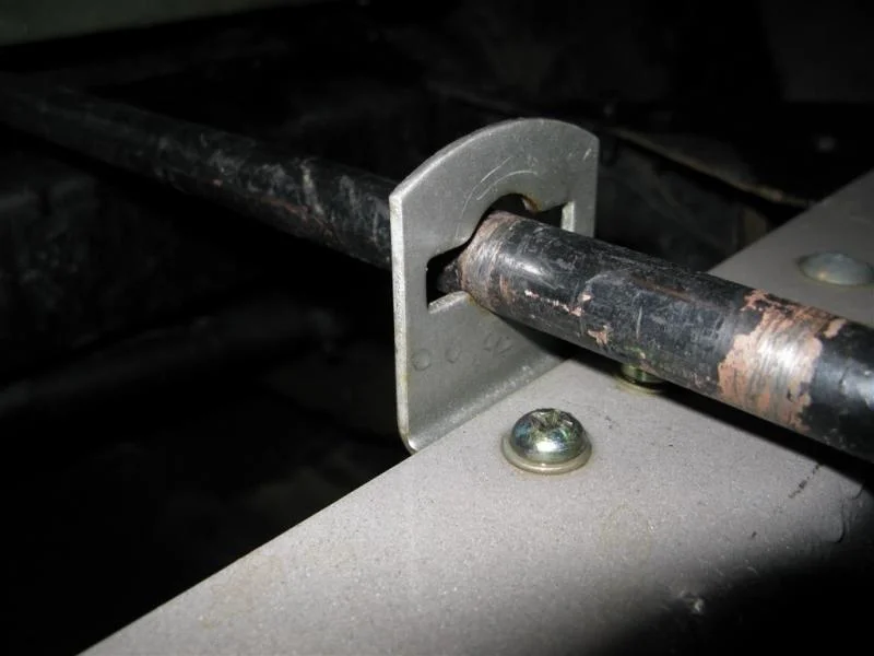

This is the proper bracket.

any other shots of that bracket?? My 40 has a horrible abortion of a front frame, was used as a plow truck (!!!) in CO... And is there a factory procedure described somewhere for using the crank? My factory literature is sparse as yet. :D

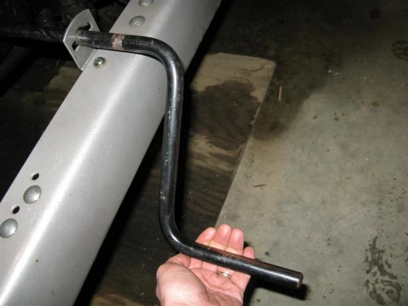

Tranny in neutral, key on, thumbs underneath, at about that angle with the crankshaft tight and give it an upward flip. (I'm one handed there for the picture but I use two).
It's easier if the engine's already warmed up so you don't have to worry about priming the engine if you have hand choke and throttle.
The lower part of the "L" bracket fits UNDER the bumper. Guess it could pull off with a big jerk. ;)

The crank spits out when the engine starts, and I've had it fly 5 feet in front of the truck so watch out. Usually the bracket grabs the crank teeth, but not always.

It prevents the handle from spinning once the engine starts but the nut design will not stop the handle from rotating backwards and possible breaking your bones if the engine rotates backwards. It will kick out of the nut once the engine starts in the correct direction, but not if it fires backwards. Interesting point in this post in that when the engine does start and it pushes the handle out of the nut the handle might come way out of the nut, a new danger I did not think of. Still would like to see a video of it starting with a hand crank, I say doable but dangerous.
it hardly pushed out when starting the few times i did it (6" +-) ....as long as you have the crank guide on the bumper, danger is minimized. there's a bigger danger if you try to start in wintertime :rolleyes: but its not the starting process thats so dangerous...its the stupidity of doing it on an icy driveway :meh:
edit: i forgot to mention ...its also a good idea to put alil wheel bearing grease on the end

If when you flip it you don't quite make it over the hump it will definitely kick back on you. I've had this happen. This is why you don't wrap your thumbs around the handle.
I've also had the engine spit the hand crank much farther than 6 inches. That said, the bracket makes it nearly impossible for the hand crank to end up on the road in front of the vehicle.
But with those precautions (not wrapping thumbs and not standing in front of the crank) I don't think it's particularly dangerous.
