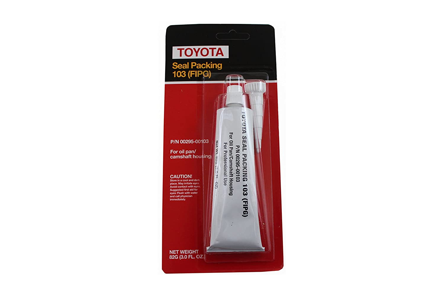

I picked up an LX450 a few months back and it had a burning oil smell. Figured it needed a valve cover gasket so I cleaned everything up to try to pinpoint the leak. Turned out the head was cracked. I took @pinhead's advice and smeared some FIPG on the leak. Been about a month now and no leakage.
Fuggedaboutit. Those cracks are bupkus. Unless the crack went through into a high pressure oil line, I cant imagine any significant leakage. You might try cleaning it and putting a coat of FPIG over them.

I was fine with using the FIPG, worked for me for almost three years and then the head gasket blew so the head had to come off.
My point was that after removing the head there is no way I would reuse it without getting it repaired, and to me that means welding. Not saying Loctite or JB weld wouldn't work but not a risk I would want to take if I was reworking the head.

@TomH curious how you got the FIPG to work. I tried and it seeped past it. I tried to clean it very well. Used brake cleaner even. Let it sit for a day or two. Used compressed air....then applied FIPG. Didn't work. Maybe I just got unlucky. What was your method?
You know, maybe I'm imagining that it worked. Maybe it slowed the leak a little. I suppose what really worked was whenever I started smelling burning oil I would grab a rag and wipe the head down to keep the oil off the exhaust manifold.
