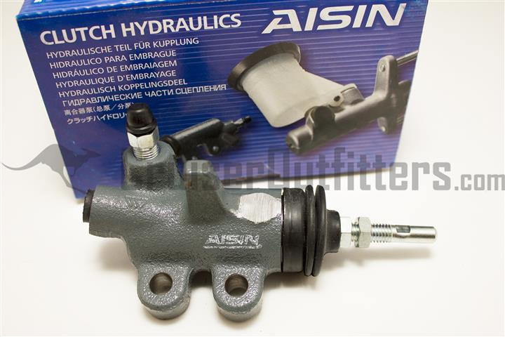

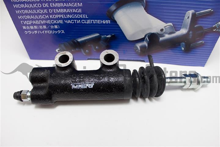

When I did the H55 swap on a friend's BJ60, we had 2 different bellhousings that had different bolt spacing as matt suggested above. The differences in can be seen below from cruiser outfitter's page:
Clutch Slave Cylinder - $37.50
AISIN High Quality Japanese Cylinder
(Fits HJ4x & HJ6x Applications, call for specifics)
Part# CSN60091N
(Fits BJ4x & BJ6x Applications, call for specifics)
Part# CSN60110N
That second one is for a 3B bellhousing, completely different for from the 2F clutch slaves. There are two different FJ60 2F clutch slaves though.
We had one of the top slave cylinders above on a 3B bellhousing as well. It seemed odd, but we hodge-podged it together and it worked.
The picture above shows the early model siave cylinder.
31470-60081 (Used up to 4/85)
Your part number is right, but that picture is not. That’s a 3B slave. Completely different.
