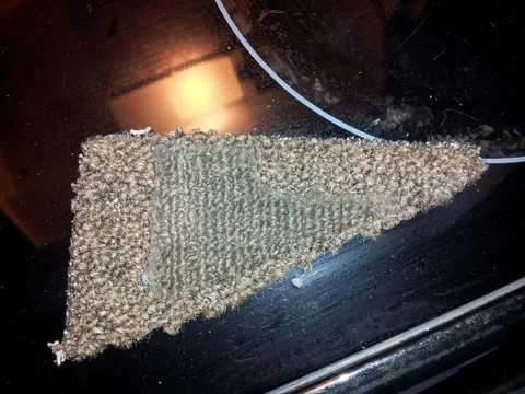

The carpet came from home depot and cost about $15 for a 12'x3' piece. It doesn't match perfect but its pretty close, and since I only needed about 2'x3' I have a lot left over.
Top piece is the factory stuff bottom is home depot
