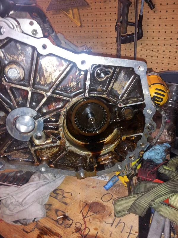

Now its just putting the split case together. If you are using the H42 with the extension you will need to get some new bolts that are shorter to mate the split case to the toybox.
To make putting the split case back together easier be sure to put it into 4wd so that the gear is held into place by the front output shaft. Per the FSM make sure the gears are on the front of the case and slide everything together.

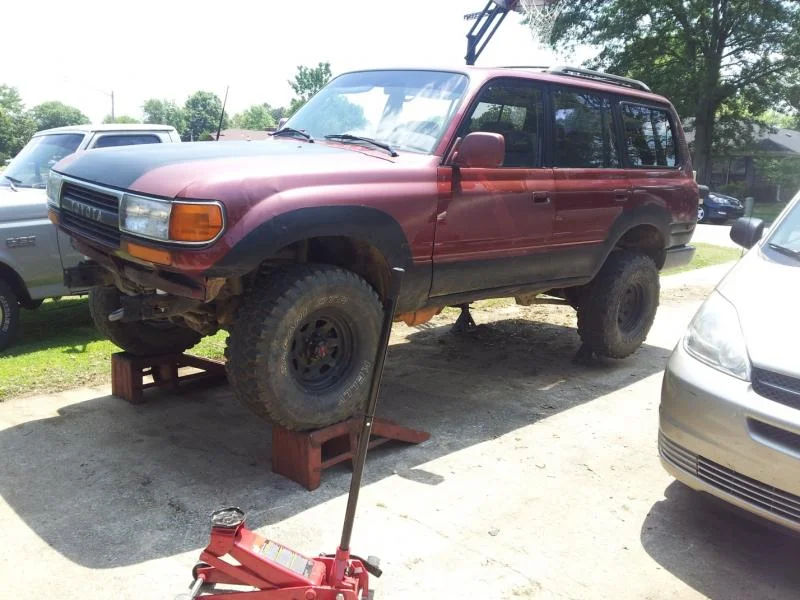

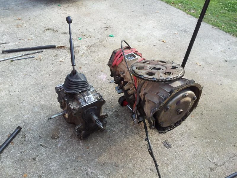

Now its time to throw all of this in the truck. It took me by myself a very full weekend to put the transmission, split case, toybox, and rear driveshaft in so that I could drive it Monday morning. Since then my brother and I dropped the whole setup again to change to a new H42 with a better 2nd gear synchro, it took a lot less time and was much safer with 2 people.
This is a pretty straight forward deal, but make sure you have a good transmission jack or really good cribbing because that auto tranny is HEAVY. This actually took longer to pull than almost any other part of the job it was nothing hard to do it’s just a lot of bolts and connectors.
With the Auto out you can bolt up the bellhousing and align the clutch, the good thing is now there is plenty of room to work with the transmission out of the way.

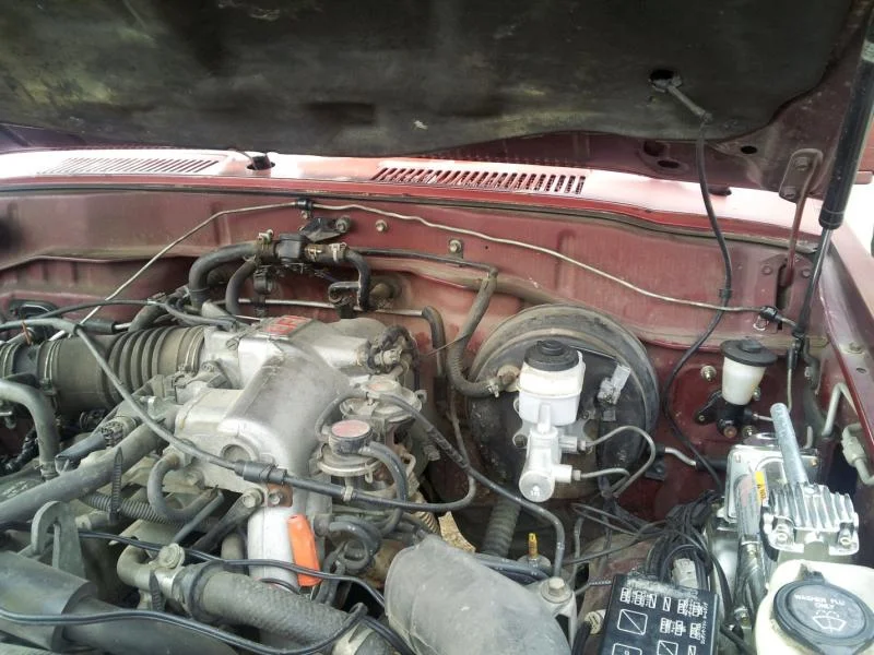

With the body lift the clutch slave cylinder clears with about ½” to spare. I went ahead and ran the original fj60 clutch line at this time. This gave me plenty of open area to fish the line down and find a good mounting point.
Lining up the transmission would normally be a pain since the tranny and transfer case have to go on as a unit or you have to put the split case together under the truck, but with theToyBox in there the transmission/transfer case will go together as 2 separate pieces. So I hung the transmission on the back of the engine and then bolted the ToyBox and transfer case to it. Now its time to brace this set up to the frame.

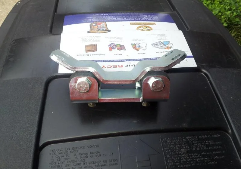

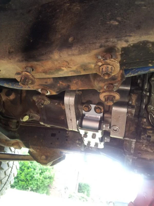

I have 3 different cross members one 80(bottom), one 60(middle), and one 40(top).
What I found when I got done was that my original FJ 80 cross member lined up perfectly with the bottom of the ToyBox and that the ToyBox has the original cross member mounting holes from the mini truck on it. But that none of the 3 styles of cross member mounts I had would fit it. I had a mount from my fj80 from the donor fj60 and from the other transmission + splitcase that had been thrown into the deal, I assume it was for an fj40. So I ordered the Heavy Duty replacement from 4xInovations http://4xinnovations.com/p-TCC1322.html and it was at my house in 2 days. This thing is pretty beefy fits perfectly and cost less than one from Autozone or Advanced. The same mount fits the 4 cyl mini trucks from 79-95 so if your finding parts in a junkyard these should be plentiful but not nearly as well built.
When the mount was bolted to the case there was a bit of a gap, but nothing a flat washer wouldn’t take out. With everything bolted up the front drive shaft flange is close to the cross member but has enough clearance to run without problem.

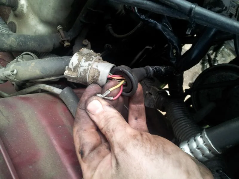

Before you drive it there are a few things that have to be taken care of. You need to bypass the neutral safety switch
and hook up the reverse lights(yellow and red wires may have stripes I cant remember)
These will be in the main harness that is left in the engine bay after you take the auto tranny harness off of it.
I originally had the NSS jumped in order to get it running but I have since go the cruise control working and this requires the NSS to be open. So I am trying to find a good switch to go behind the pedal as Mr. T would have intended but have a switch in the dash for now to open the NSS while the cruise is engaged and close it when I start the truck.

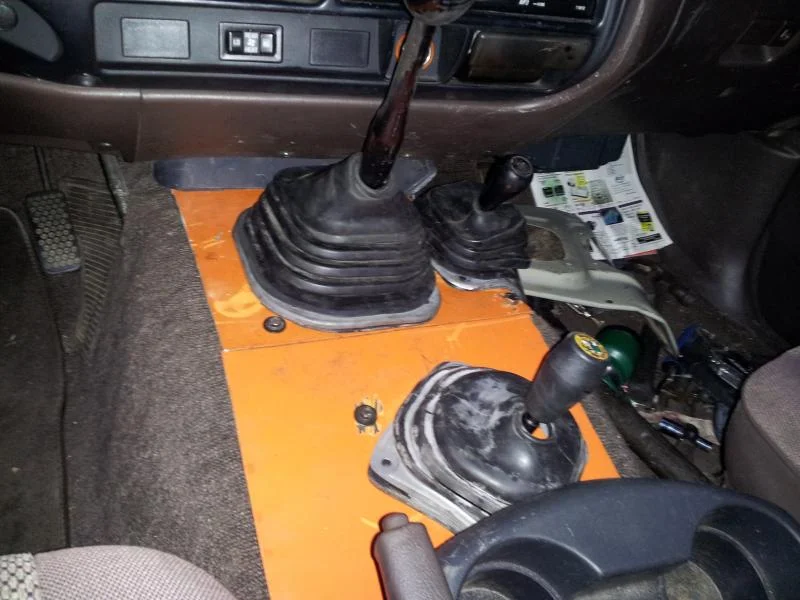

I went with a very basic interior covering the transmission hump with 16 gauge steel and then painting it black to blend in some. I also used some Gylon rubber gasket material below the steel to dampen rattles and other sounds.
I have since put some sound deadening on the hump and covered it in carpet to quiet things down a bit. The boots I used are from the 60 for the transmission shifter, a mini truck for the toybox shifter and an ebay special for the twin stick(not shown I was still being stupid and trying to work with one stick). I actually used an old pizza box from lunch that day as my template for cutting the steel and getting my holes to line up.

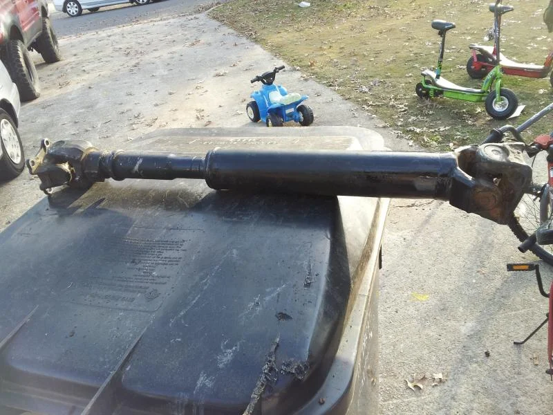

The last thing I did was build the front drive shaft. There are several write ups on the net about building your own shaft, but what you need is a steady hand, a ziz wheel, a good mig welder, your original front driveshaft and the flange from the 60 series that mounts to the split case. You ziz wheel off the original transfercase flange and then weld on the new 60 series flange in its place. My front shaft was exactly the same length as the old shaft, but I would double check with your setup to be sure.
The rear shaft fit but was a little more extended than I liked so I ordered a 1 ½” driveshaft spacer to go back there.
