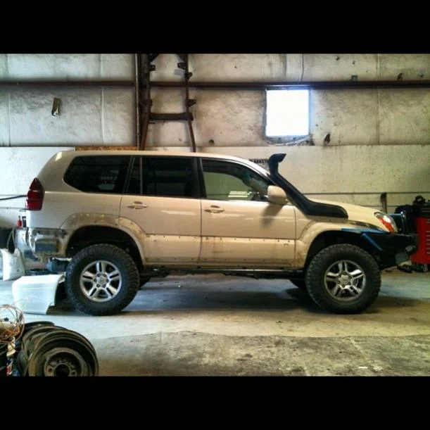

Brakes, tie rod, and wheel studs are done! Have a little radio troubleshooting today but bumper design starts tomorrow at ACC! ( plus a few other things ;))
Rear bumper is underway! ACC in ATL is doing the work and design will be in CAD so this will become a product for them to sell...stay tuned, rear bumpers for GXers will be on the market soon!
