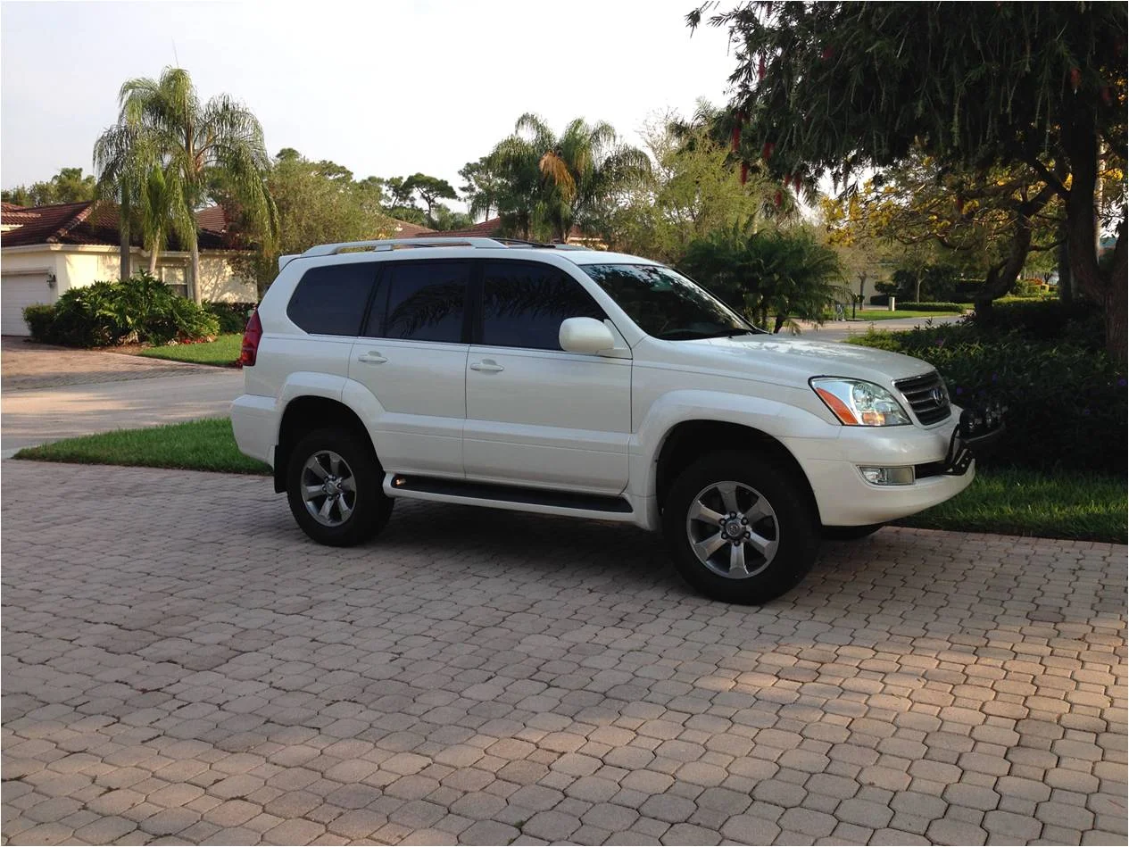

nice, those wheels look right at home on your GX
No trim pack, but I have a lot of extra weight :)
Thanks. Need to find some center caps with the Lexus "L" logo. Someone had some available a long time ago but haven't been able to find them again.
I plan to use my stock wheels for off road. Trying to find out if I can put 275/70/17 tires on them and not rub. Or if I need a spacer...
275s will be fine. 285s rub on the inner frame (Back) and sway bar (front). I just run them rubbing anyway :)
Looks good. Which ironman setup did you go with? Their "original" lift or the new foam cell pro with adjustable coil overs?
I got a somewhat mixed setup. I wanted the "regular" foam cell shocks in comfort (FEC), but Metaltech did not have them in stock for the rear. So the front is the regular white FEC shock and suffix B firmer spring. The rear is FEC Pro (black) shocks and the suffix B firmer spring. The pros in the rear are beasts!! As you probably know the Foam Pro shock is rebuildable.
The ride is good. It's a little different in that it can seem a little "jouncy" over some bumps versus the stock suspension, but when you hit heavier/harder bumps or holes, it soaks them up much better than the stock airbag suspension did.

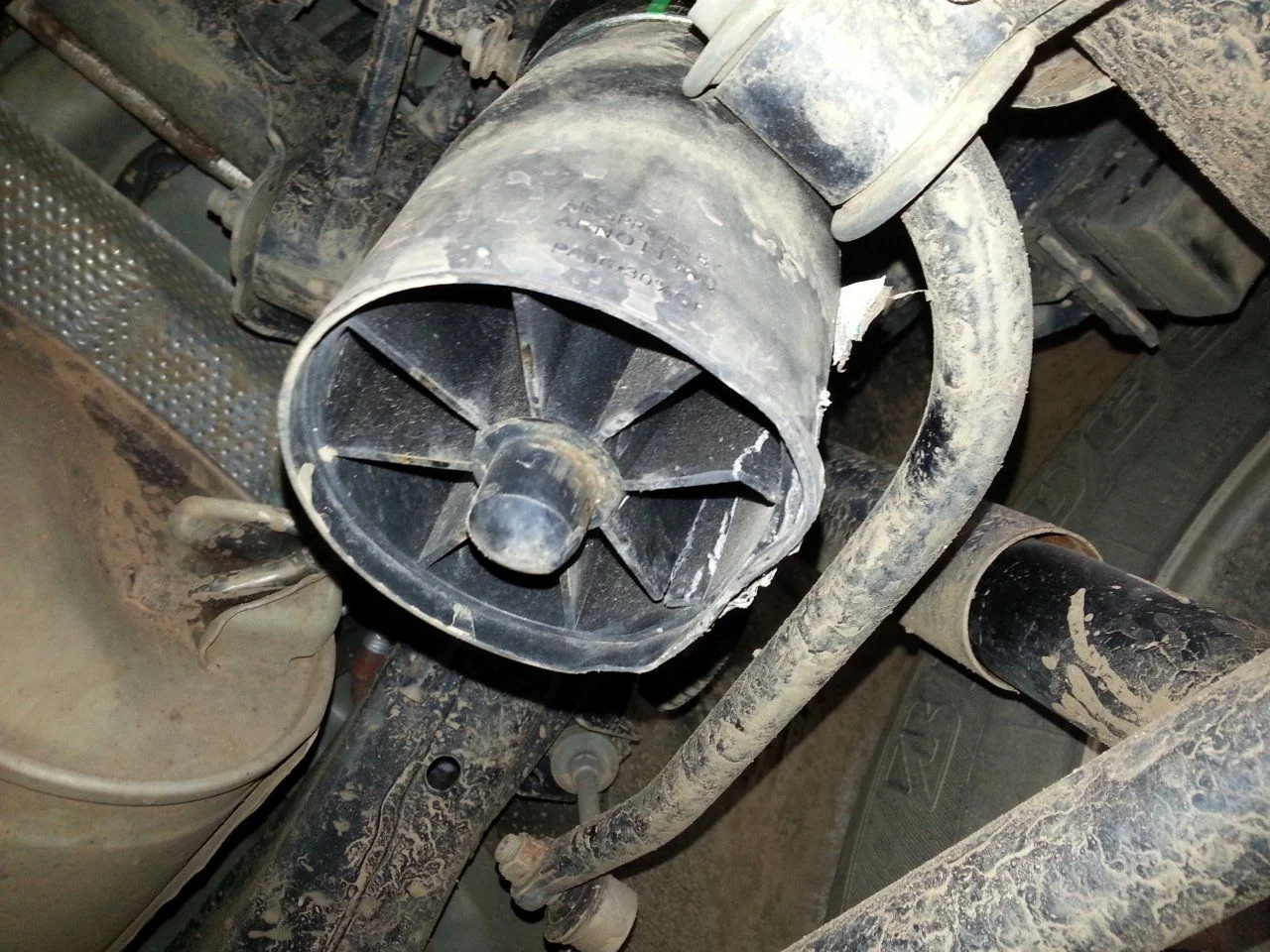

Yes, it just so happened that my rear air bag trick was EXACTLY the same height setting as the Radflo 2" lift. Otherwise you'll just need to play with the sensors until the air bags have minimal pressure at the N setting. Obviously you'll lose your ability to go lower but, ride leveling and even making it taller by going to H still work great.
Do you recall what the part number for the airbags were? I'm planning on doing this as my air suspension failed for the second time this weekend. It was replaced right when we bought it last October by the dealer but the repair only carried a 6 month warranty...

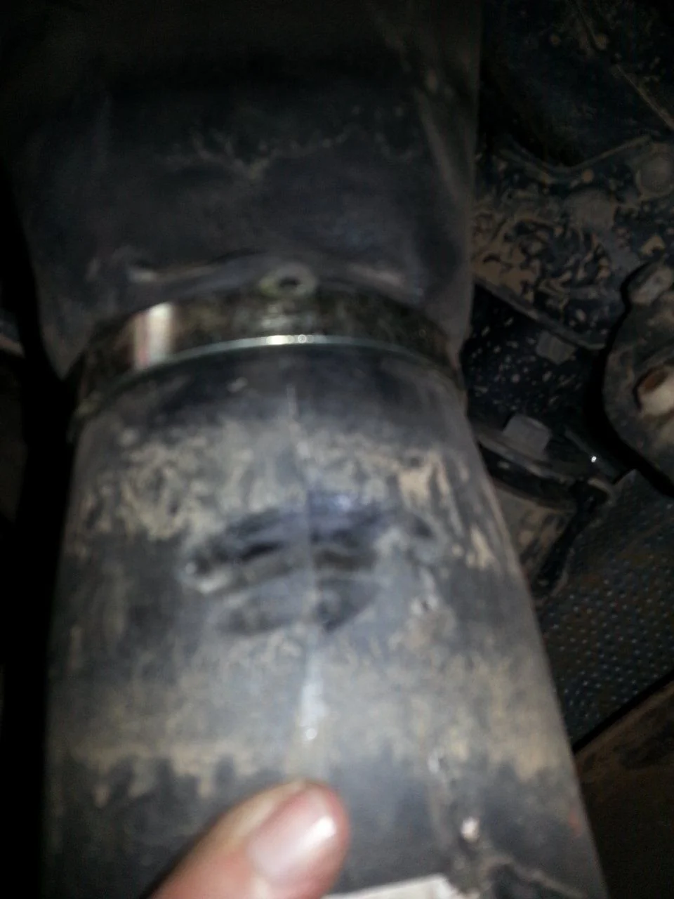

They used arnott bags and it came off the spring perch on a dirt road while I was pulling a trailer with a two dirt bikes and all of a sudden I heard a loud hissing sound (thought it was a tire) The bag pulled off the plastic part that sits on the perch somehow as well but not sure what happened first or if it was concurrently as it happened out of nowhere.

One more thing! At first I thought they sent me the wrong airbag kit, because the bags were woefully shy of the length of the full springs. It was the right kit though, so to remedy that problem I didnt cut the isolators down as much as AIrlift recommended. I cut the last two sections off of the isolators which left me with about a 2.5"-3" circumference of area that would be acting as the top "bump" stop for the airbags. I was concerned it would put too much pressure on that small area, but have been pleasantly surprised. Those bags are tough and did just fine. I've already towed a couple thousand pound around town with no problems.
