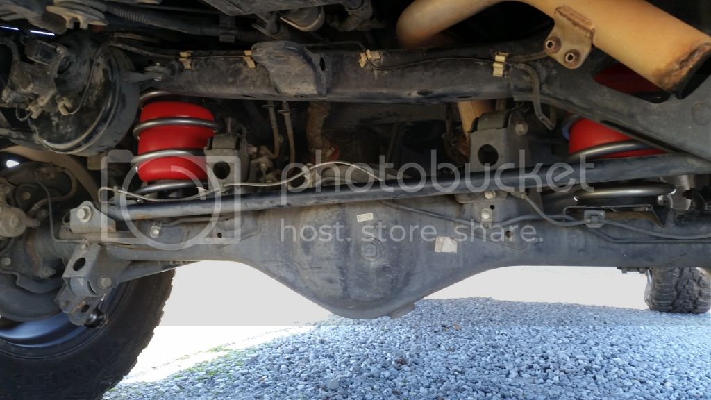

Finished up my rear coil conversion the other day with a small twist. I ended up purchasing the AirLift 1000 bags and used the oem compresser system to inflate and deflate them. I didnt have to do any adjustments or pull any fuses and the truck doesnt know the difference. I used the metaltech conversion kit, radflo springs/shocks, and 4runner airlift 1000 bags.

The upper spring mount in the back is just the OEM 4runner cone that sits on top of the spring. If you do an airbag in it, you just cut down the cone to make room for the airbag inside the spring.
Hello. Very informative thread. Brilliant idea combining a coil spring conversion with aftermarket air suspension. I have a question for anyone who's used the airlift airbags. When the bags are inflated do they only increase the coil springs resistance to compression, or can they also expand vertically to increase rear ride height?
