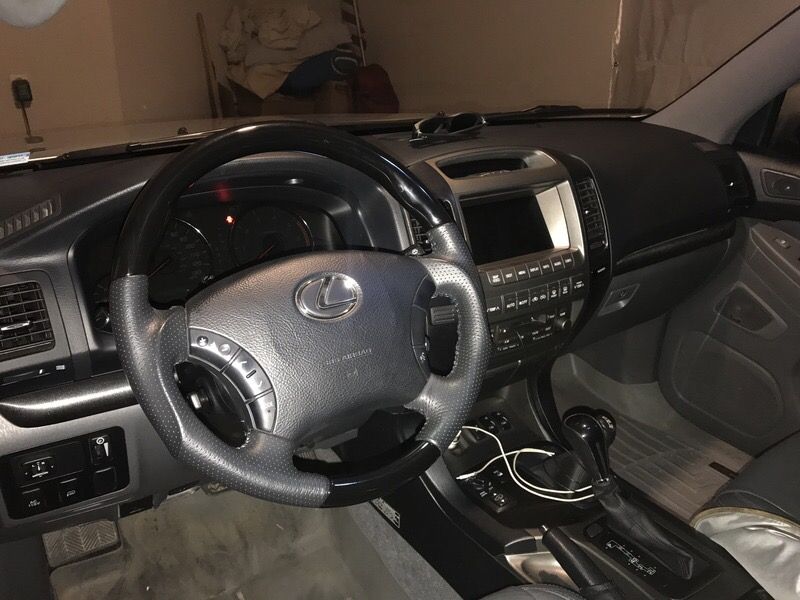

Non-nav, non-sport. PO nicely switched out the stock wheel with the t4r wheel. I believe it was bought on ebay. PO also pulled the wood, sanded and painted it Toyota galactic grey. It looks great, ih8wood.
very cool! really like how it turned out... steering wheel have much life left in it? from the pics, it looks pretty good, but also not necessarily mint...
Steering wheel is damn near perfect. At least as good as the t4r I sold to buy this GX470.

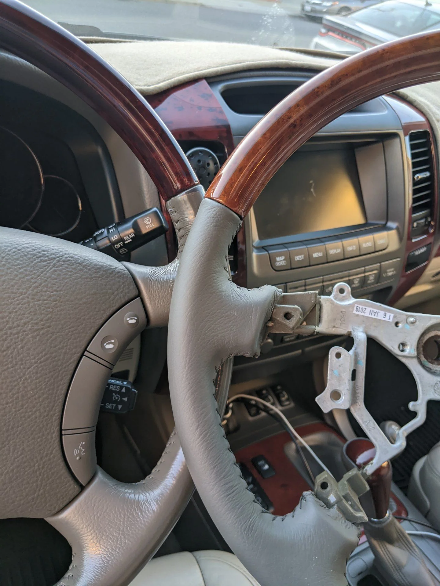

i got this one off eBay to refresh the leather.
as you can see from the picture, the wood grain is a lighter shade, less red than stock.
the taupe grey tan color is a pretty decent match. not exact, but also has time to get worn in.

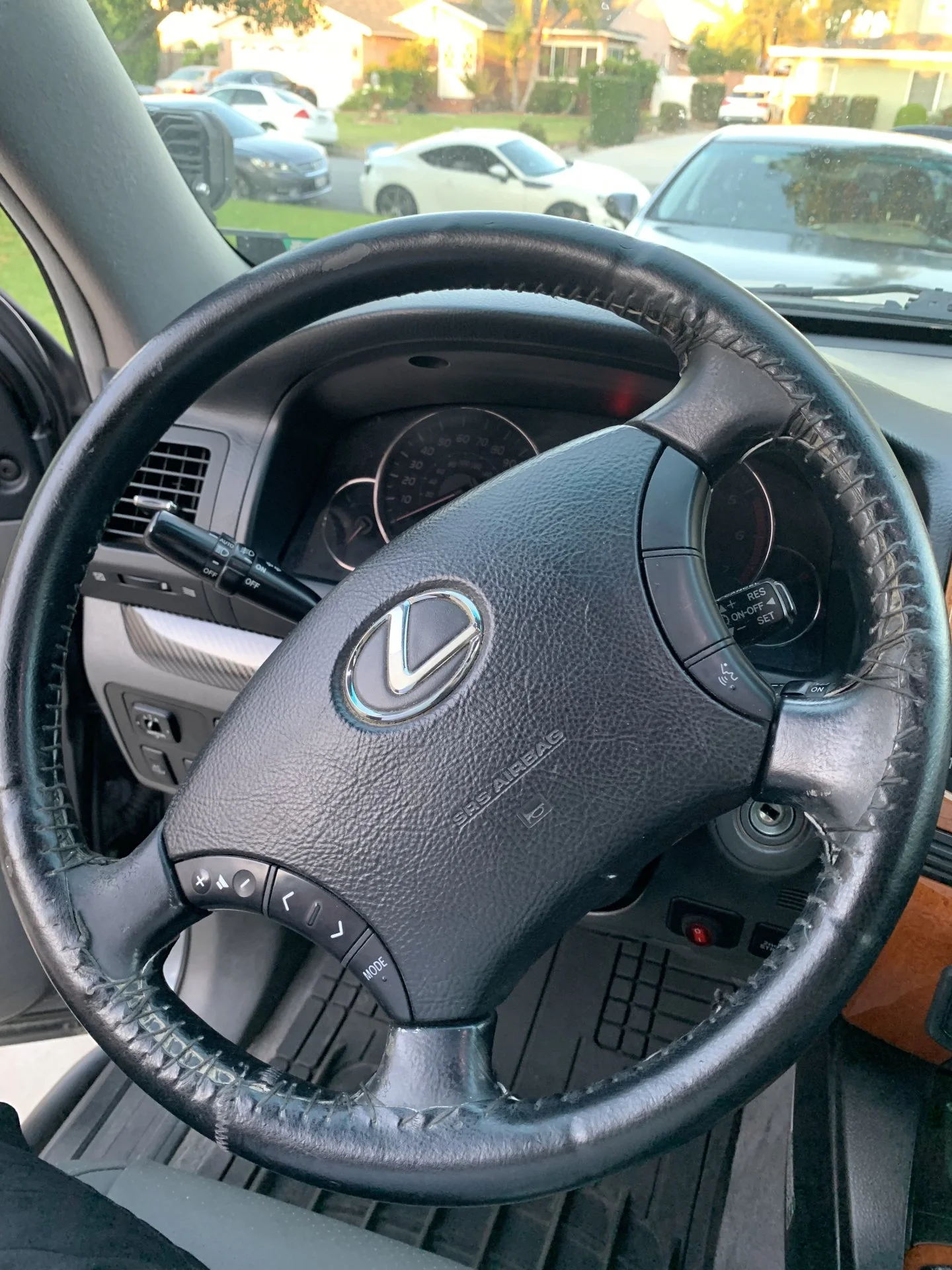

No, I ended up buying a leather wheel wrap that required me to hand stitch it while on the wheel.
Not a perfect job, but it’s been over 4 years since i wrapped it and the leather is mostly holding up.
I might need to do it again next year.
