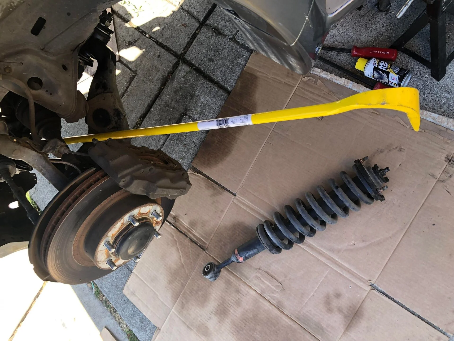

Anyway, we're dong an OME lift on a GX470 the issue we have is to remove the strut/shock and the lower control arm does not drop far enough down, so the whole original strut/shock go stuck in place and I could see that would be impossible to get the longer OME strut/shock in.
We already remove almost everything that connect to the lower control arm, the only thing left connect to the lower control arm is the lower shock.
Please help. Thanks so much
OK, I got the darn shock out, I lubed the alignment cam bolts and used a 4ft long pry bar.
I thought when everything is disconnected from lower control arm, it would drop down without being pried on. So the question is: When you torque the alignment bolts, the lower control arm has only limited up and down movements?
Thanks
