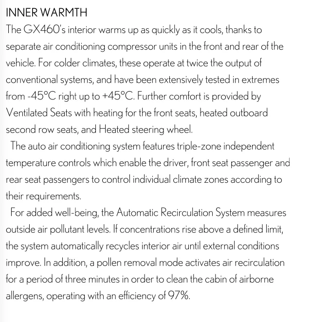

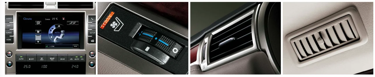

My 3 zone is like a meat freezer in my 460
I’d probably get my system checked if it is only marginal
Looks like the front AC unit on 460 is rated at 21,312.5 BTU and the rear is 12,276 BTU
