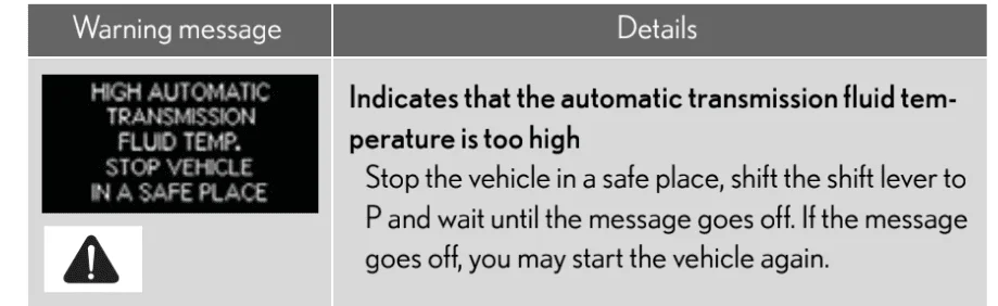

I've seen a few on GXOR in slow & go off-road...probably not in 4L get this one. Fluid temp was pushed to over 300 degrees. I have to look again but doesn't reset until below ~270 degree range. It is in a thread somewhere. I've yet to see anyone draining fluid on a 460 over 25K miles that is still translucent in any way.

I am inclined to think this is the use of 4H in conditions that warrant 4L. A few that come to mind were out in heavy sand & driving slow on the beach and the another steep slow climb in mountains above 10K feet
