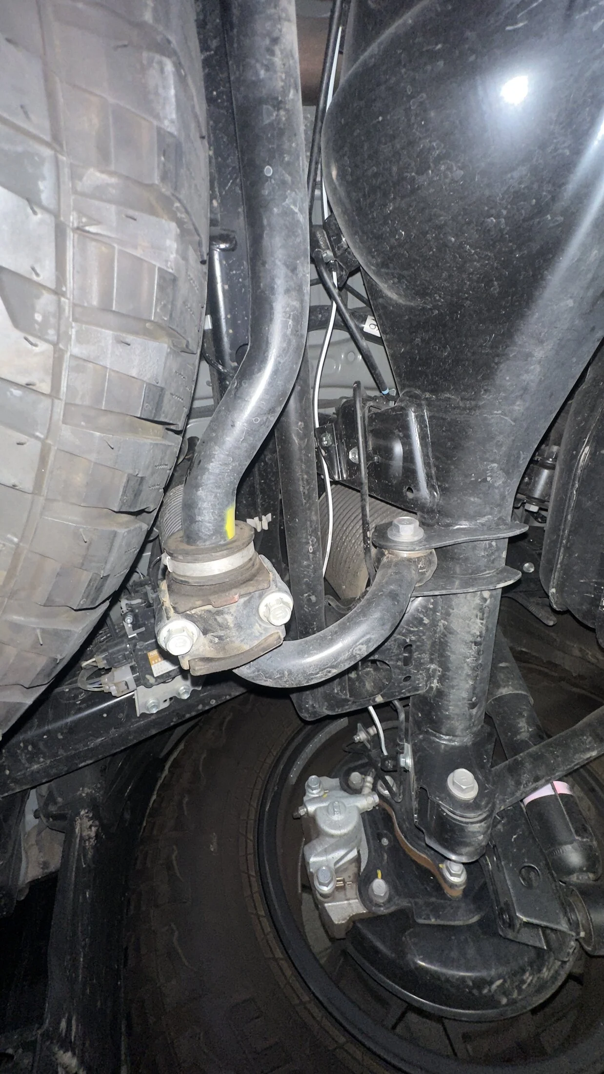

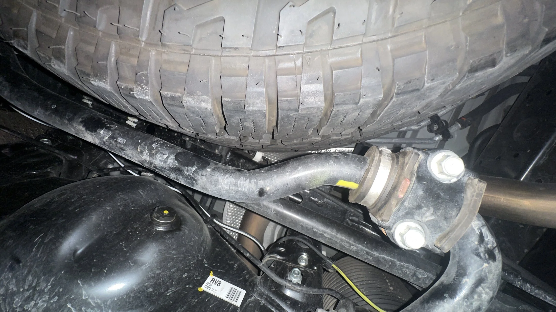

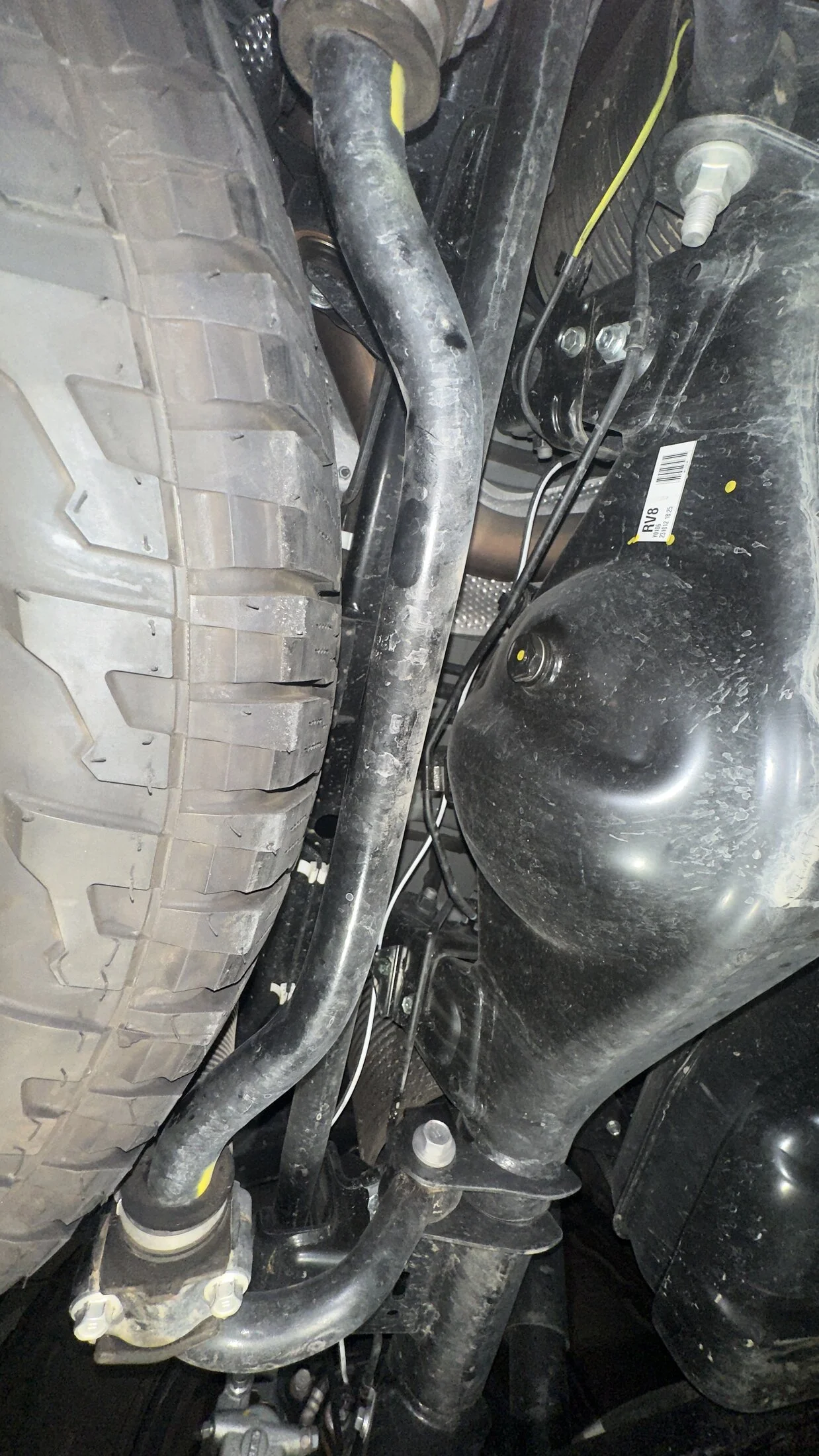

Bringing this thread back to ask how much articulation/movement the rear KDSS sway moves on and off road.
After about 9k miles on my current tires, I decided to see if I can fit one in the spare now after 9K miles worth of driving. To my surprise, I was able to get it to fit, with about a single finger width between the tire and the KDSS sway bar, about a little less than half an inch of space. Both sides are roughly the same distance apart from the sway bar.
3 questions
  1. How much does the sway bar move and is a little half an inch of room enough so it clears the tire?
  2. I don't want to rotate the spare at this point if it fits. Let's say in 30K miles of driving, I get a flat and I need to use the spare, will I run into issues running this spare with my other tires that have more wear on them? I can't image the difference between 9k miles on the spare and 40K on the other tires will cause an issue but wanted to confirm.
  3. I did a front bumper trim cut to the foglights so I can probably run slightly bigger tires now. If I go up to 275/70/17, can I use this spare if need or is the different too much? People that have trimmed the bumper, what's the biggest size tire you can run without having to do a BMC?
See pics.
Depends on the roads and trails you drive.
Owners manual covers the variance side to side and front to back. You could probably limp home with it if it wasn't too far but you wouldn't want to do that permanently.
