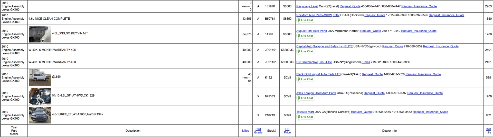

Used Engines
2010 1UR-FE

Thanks to everyone for the replies and helpful links. The first one looks like a match but its in UK unfortunately (5k in US dollars which is what I was getting quoted for reman engines). I'll check it out.
