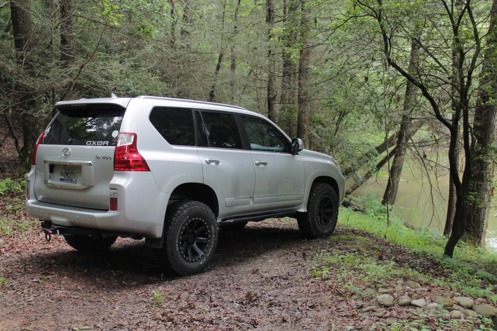

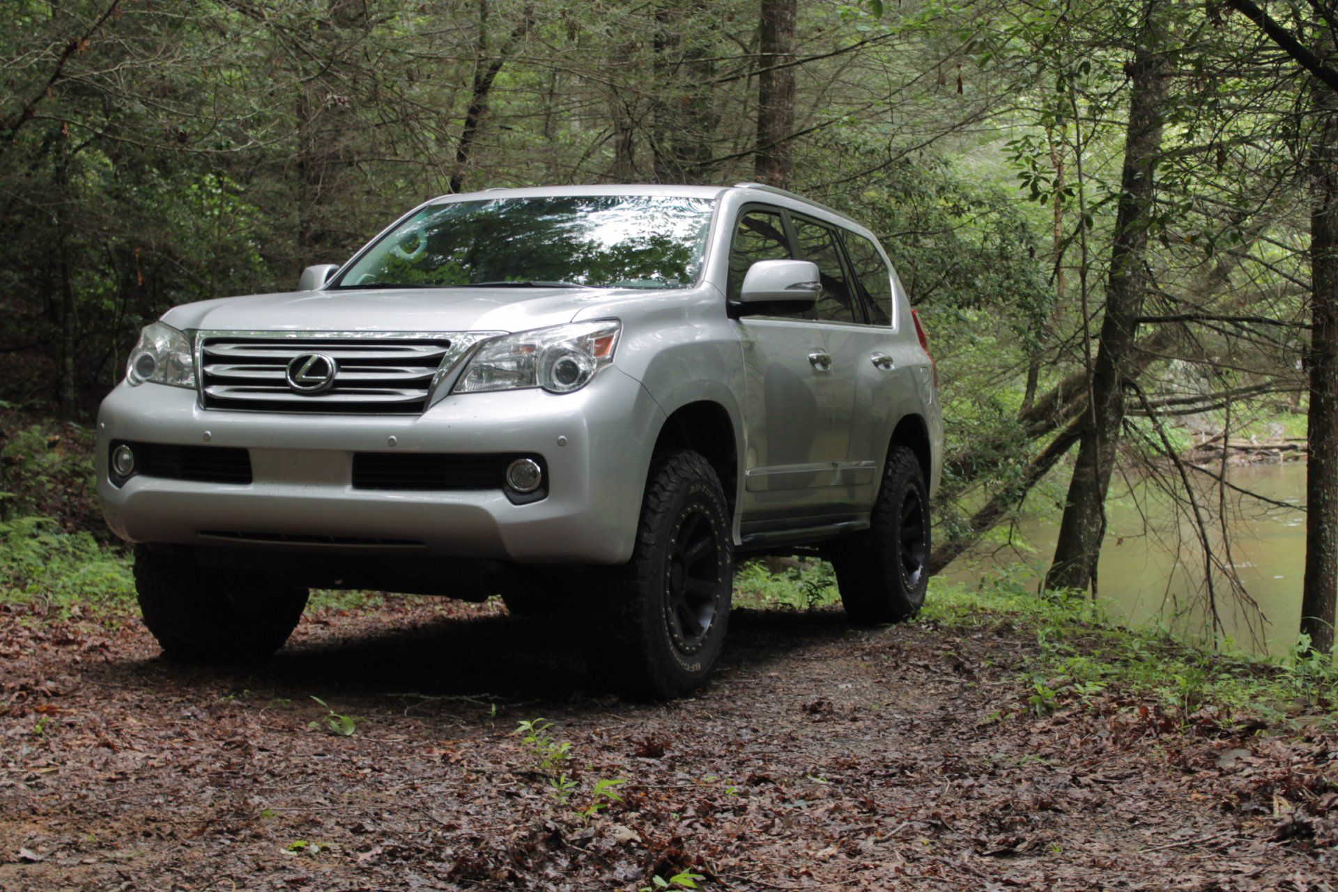

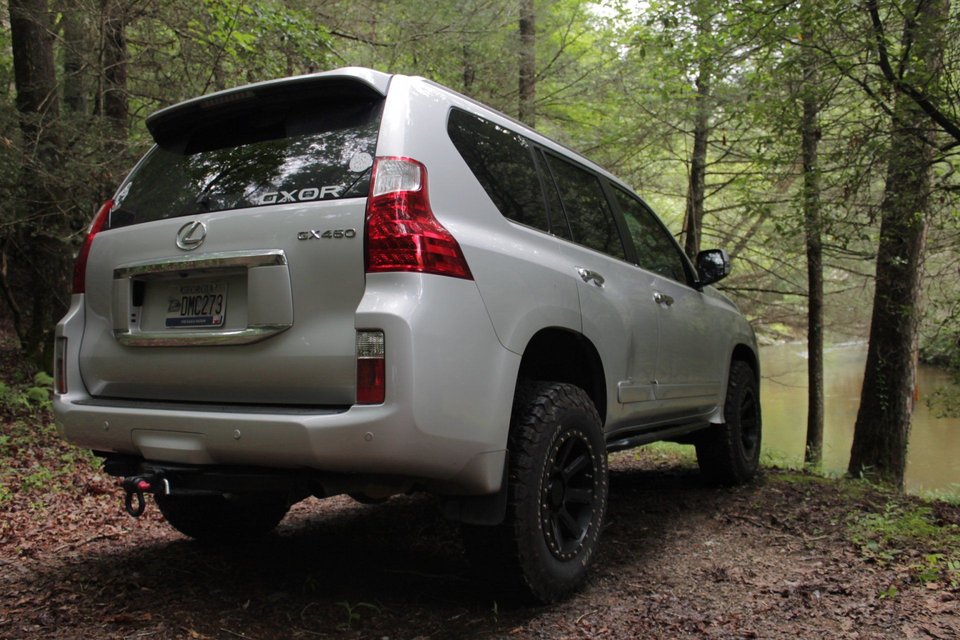

That really completes the truck, nice work! Do you know if those wheels are hub centric? I've been looking at wheels and haven't really found anything that is hub centric in 18s.
Thanks @Nickk6! I believe they are hub-centric. I don't have any vibrations or issues so far with the wheels and know that Discount Tire didn't use any hub-centric rings on the wheels.
I flexed the suspension last night with the new tires and am hitting the upper control arms when stuffed at full lock, but not by much. Any rubbing is too much for me. I'm going to have my alignment checked this weekend and figure out if I'll go with new UCA's, spacers, or swap the tires out for the 265/70r18s. I'm thinking the 265/70r18 might be a better choice as it's also not quite as wide as the 275/70r18.
I've attached the calc's for tire size difference over the stock 265/60r18s for reference.
What was the result of this? Did you swap tires? Trim? Did alignment fix?
Alignment did the fix. They set the caster as far forward as possible while keeping everything else withing factory spec. No more rubbing on the body mount. I did have to do some more fender massaging with the heat gun though, but that's the easy part.
