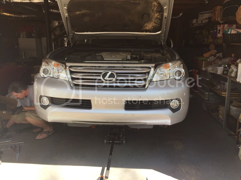

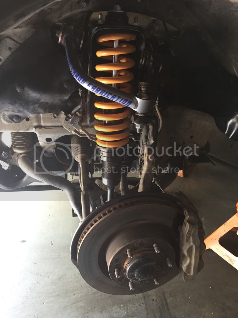

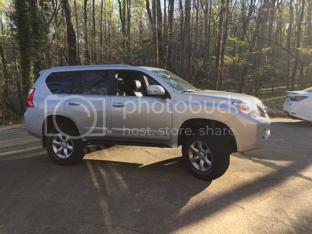

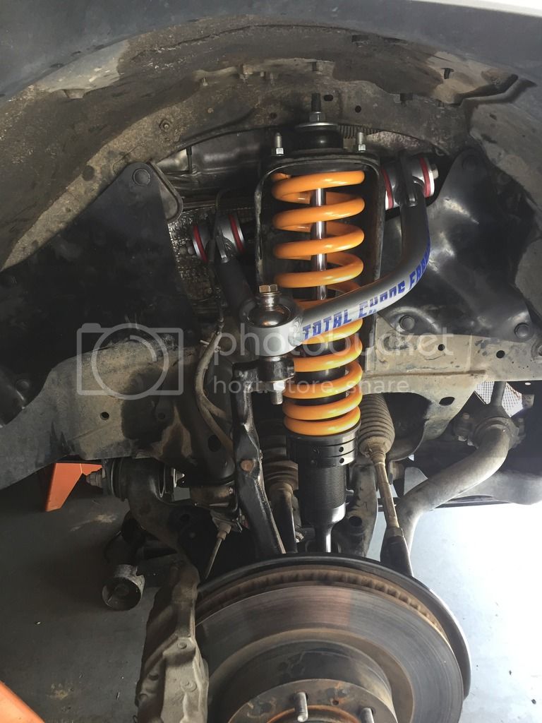

The install finally happened this past weekend over at @DanKunz 's house. I haven't confirmed with Mark @ MetalTech, but I believe I'm the first ever GX460 stateside to go Ironman Foam Cell Pros. It was actually easier to install than I had thought. We basically just unbolted the spindle from the UCA, took out the long bolt from the UCA and was able to take out the entire coil. Then just reversed and put the Total Chaos UCA back in. The rear was slightly more difficult due to the KDSS system. We tackled the driver side rear coil first by using a bottle jack and placing it between the frame and axle and jacked it up until the coil popped out. While the first new coil went in fairly easy, the second one was more stubborn. Once one new coil was in the opposite axle wouldn't down travel as far to put the new coil in because of the extended length over stock. We ended up using a ratchet strap to compress the coil some to be able to install. In all it took about 6 hours of actual install time between 2-3 people at any given moment. Having installed it now, I bet we could install another one in 4 hours.

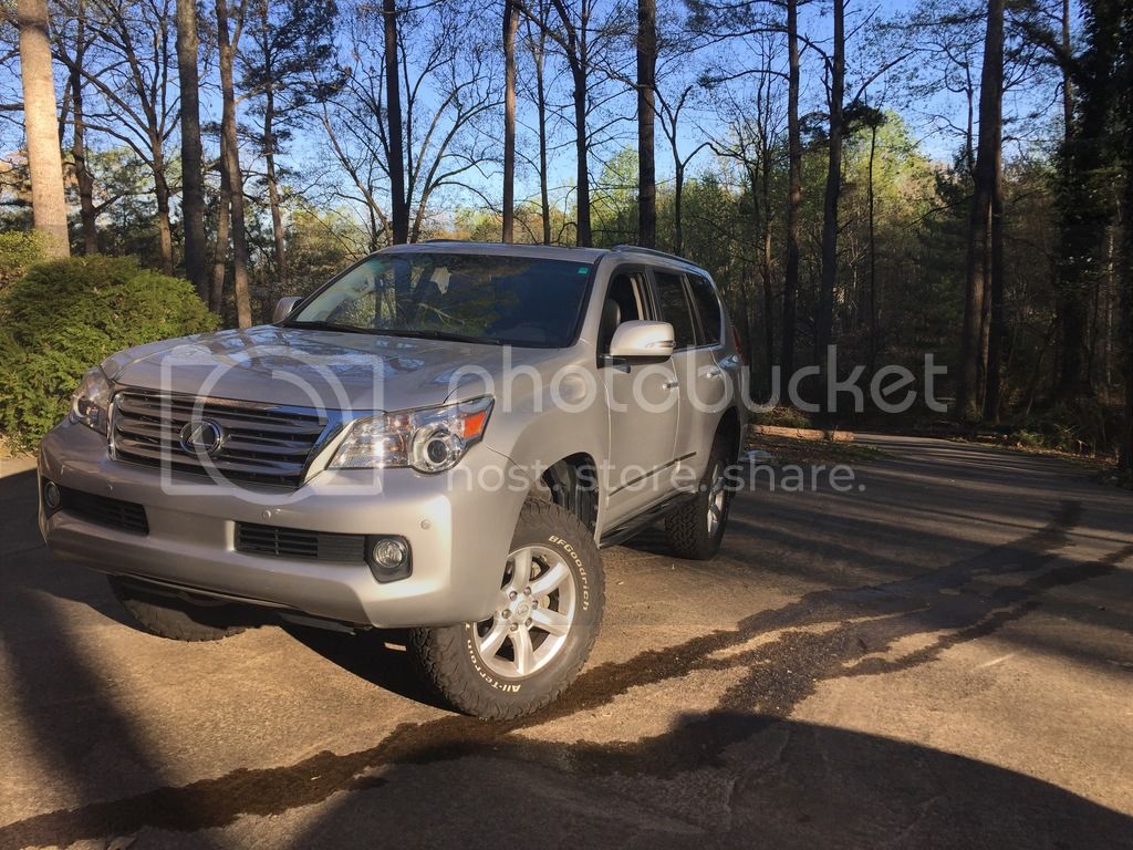

Overall it's definitely a huge improvement over the stock set up and the Bilstein 5100 set up. The ride is much more responsive, but not too firm. I haven't been able to go out and get any really good pictures for a better before and after of the truck, but will plan on doing so soon.
I can't wait to get out and do some wheeling with this set up!

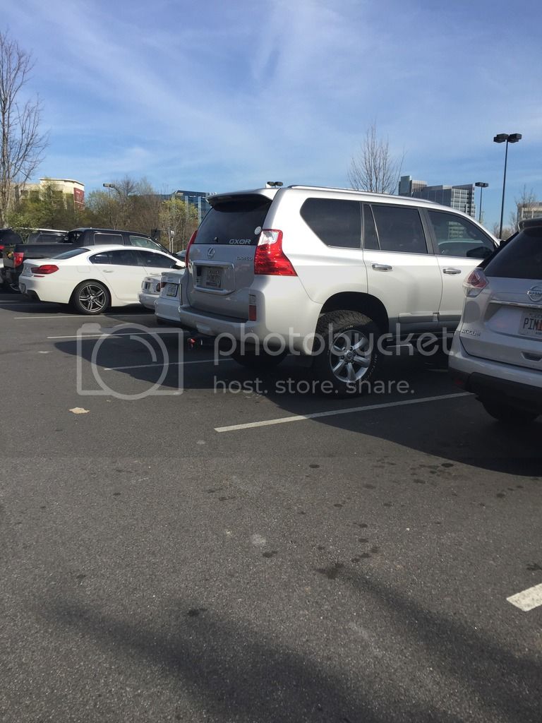

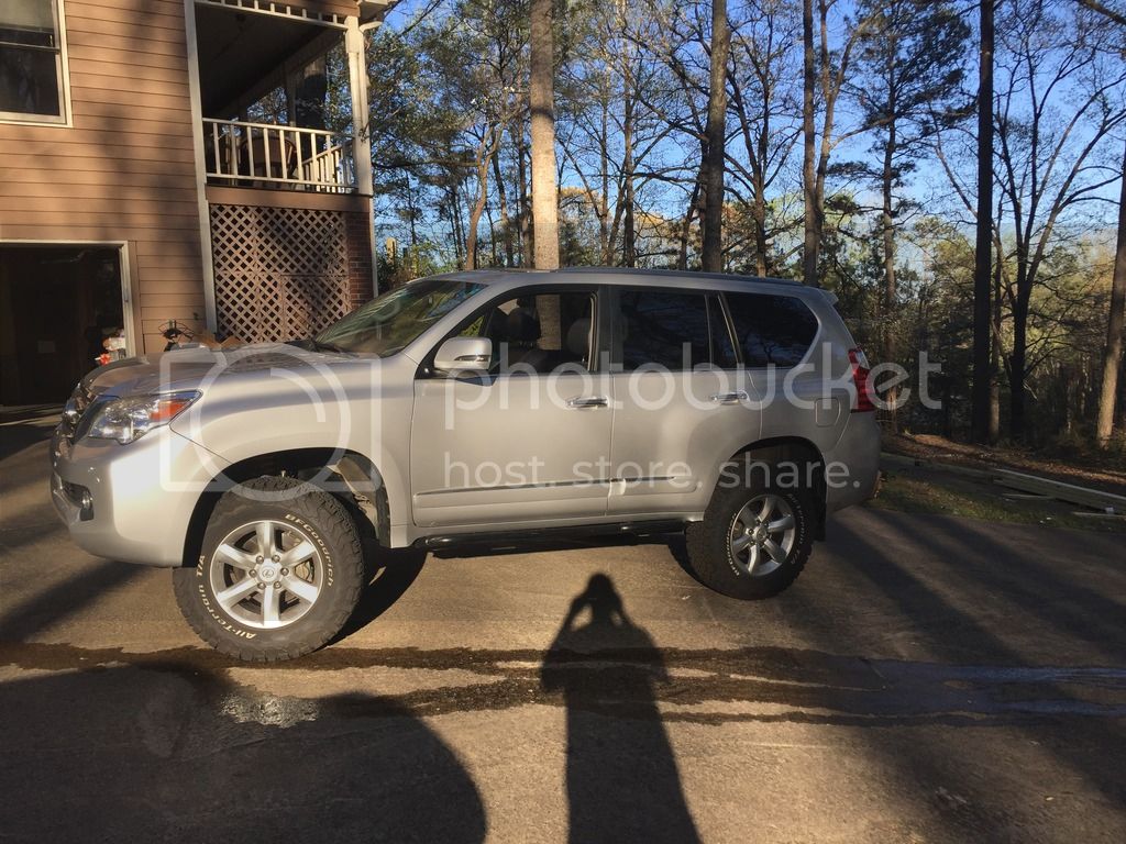

I walked out of Home Depot yesterday and was like "Oh, my, God Becky, look at her butt, it is so big!" I need to go find a stock GX460 for a better comparison on the height.

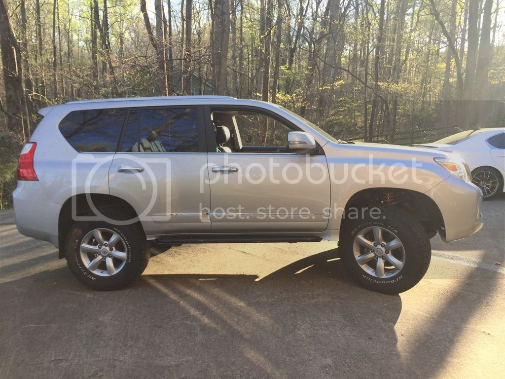

@stilespendleton did you end up cutting your running boards and reinstalling them around the sliders? it looks much more finished.
out of curiosity, what kind of hit have you taken to gas mileage with the 33" tires? and by the way, your "light build thread" is becoming less and less "light." but thanks for leading the way. i'm sitting on a bone stock 2011 that is gonna need some mods and i'm trying to decide just how much or little to do.

I ended up hacking the original running boards up to reinstall the trim piece. The only down side to doing it is that it makes using the sliders as steps pretty narrow.
I'm averaging about 15-17 mpg right now with the E-rated 275/70 KO2s.

Install itself was much easier than I expected it to be especially since we were replacing the upper control arms. Between two of us working on it we had the front done in like 1.5-2 hours and also realized that there really wasn't too much that need to be unbolted. We literally unbolted the UCA and ABS/Brake line from the spindle and then took the UCA out, which gave plenty of slack to get the old coil assembly out. If you aren't changing UCA's once you get it unbolted to the spindle it is easy.

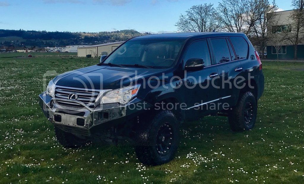

I still can't edit my posts yet, but this is the picture from the link if it ends up not working. Metal Tech just announced that they have the GX460 front and rear bumper currently in development.
Looks great, and will be even better once those front and rear bumpers get installed! I spent some time the past few weeks searching for all options on front and rear bumpers. As you probably know, while options exist with ARB, Dobinsons, Kaymar etc... none of them are specific to the GX 460 (made for the Prado 150) and I just did not feel like hacking my fenders to make this option work. I am pumped Metal Tech is starting the production on GX 460 specific bumpers.

@zman7980 I am in the same boat as you in regards to the bumpers. I knew the MT bumpers were coming for a few months, but had been sworn to secrecy!
When we installed the fronts we didn't touch the KDSS system at all. We unbolted the castle nut from the stock UCA/spindle and got the parts apart, which gave more than enough droop to get the strut assembly out. After the strut assembly was out we zip tied the spindle out of the way to put the new coilovers in. We did use breaker bar to get a little leverage to get the bottom eye to line up to put the bolt back in, but noting major.
I will say that getting the long bolt out from the stock UCAs requires you to remove stock plastic shroud (which I threw away), the battery on the driver side and small hands for the passenger side. I was actually suprised how easy the UCA install went.
The rear should have taken less time, but those new springs made it more difficult. If I were going to install again, I'd be sure to use a ratchet strap to springs to compress the springs some to make life easier.
