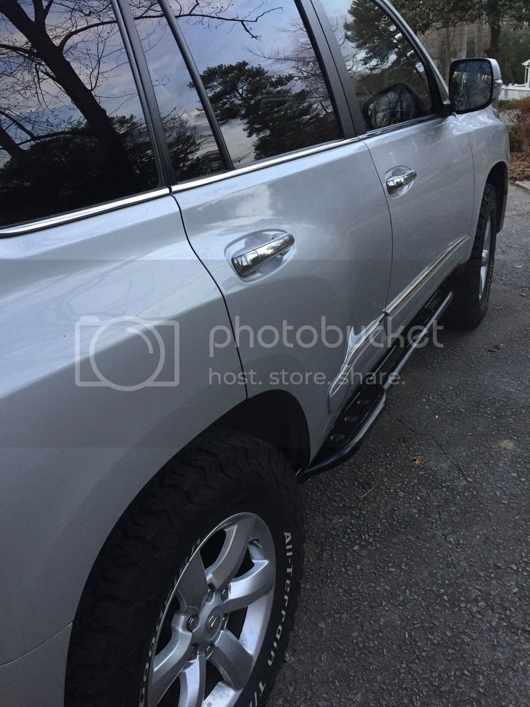

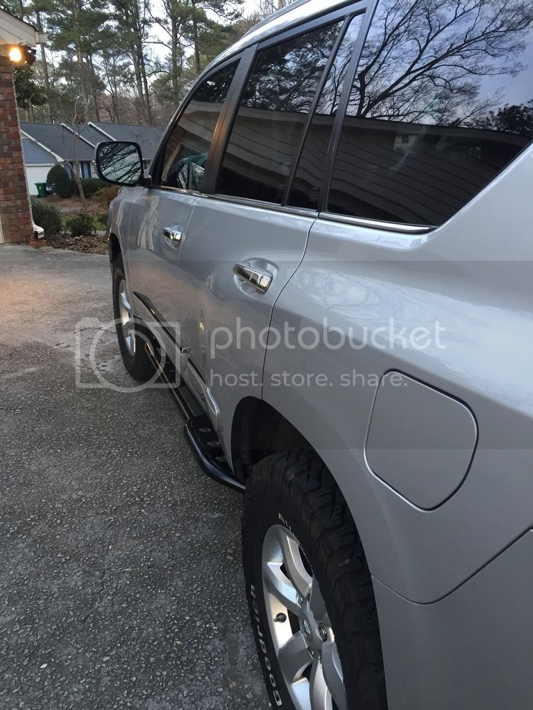

I tried DupliColor Bedliner in the rattle can on the sliders and it wouldn't adhere very well, so I stripped them, put two coats of primer and 3 coats of gloss black rattle can on them. They look awesome in person and best part is that when they get scraped wheeling I can easily touch them up again.

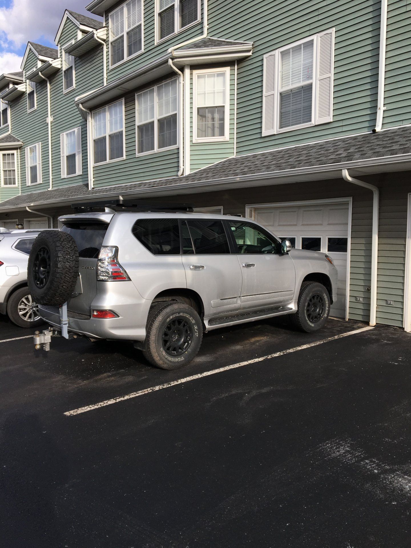

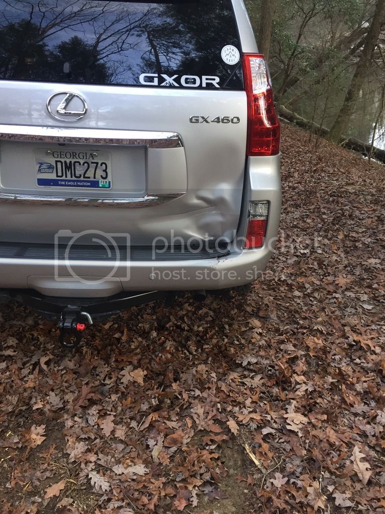

But then this happened! Initial estimate is over $3k for the door and bumper :(
Don't the wrangler boys use spacers to fit bigger tires on their gates?
I'm curious if the guys over at AUStoUSA.com could source a silver rear door. They seem pretty willing and able.
Not only is my tire larger, I also went with an E-rated tire, which isn't light at all, so even with a spacer, it'd probably end up sagging. I'll have to check out that site and see if they could get one after I find out if my tire size fits.

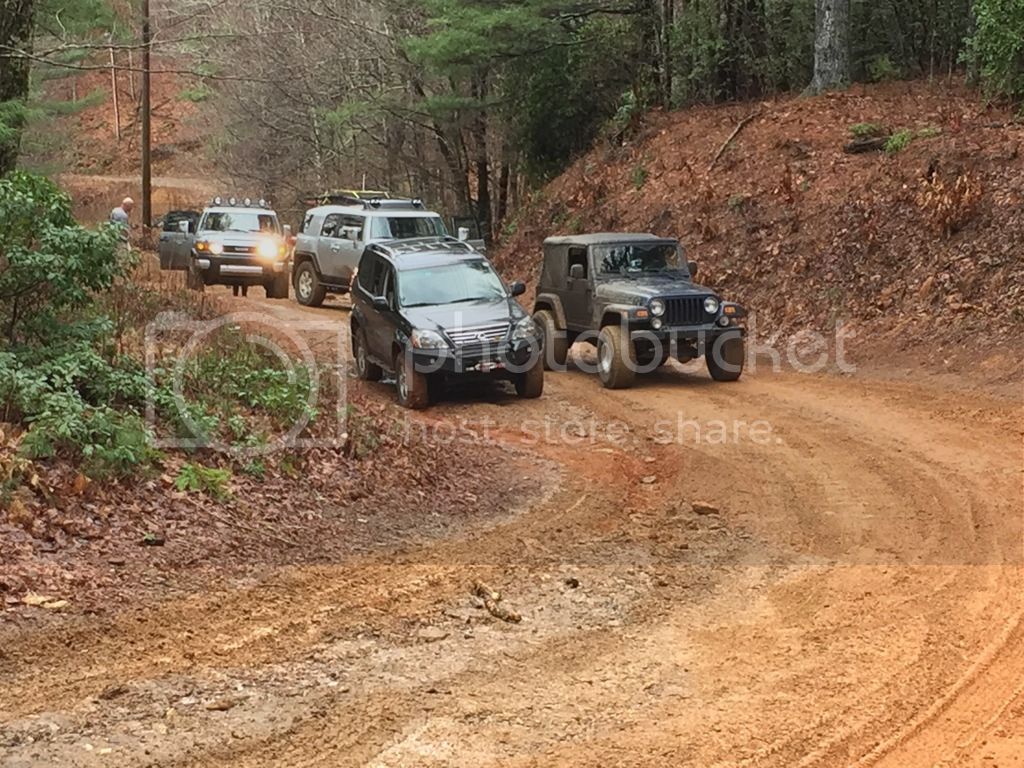

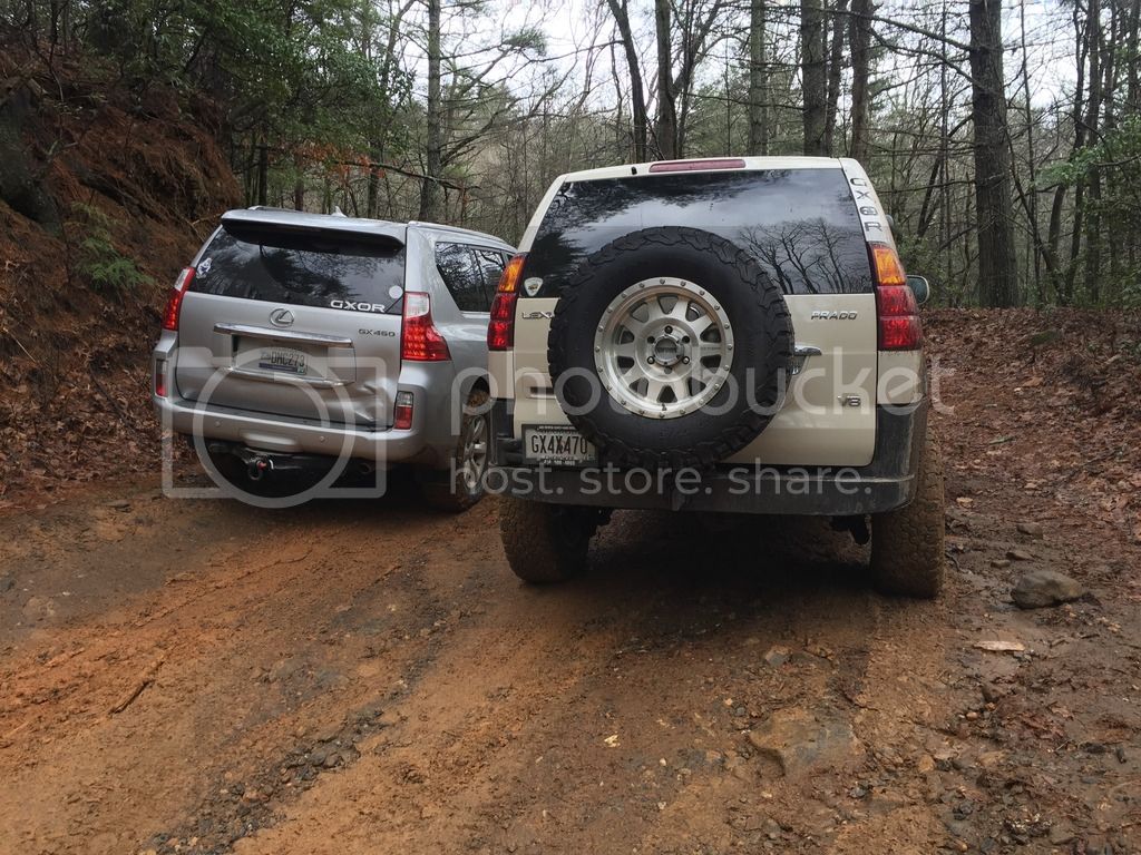

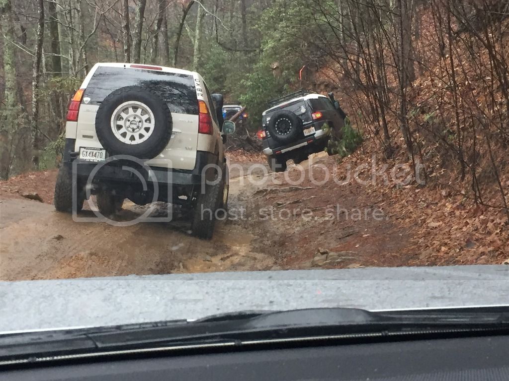

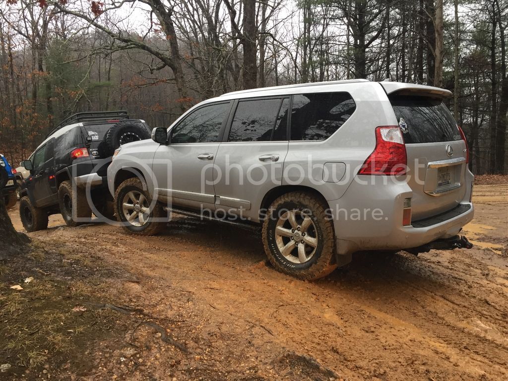

Met up with the GA FJ Cruisers for their birthday bash and ran Trey Mountain and Charlies Creek with two other GX470 guys. I forgot the GoPro, so I don't have many pictures of the GX, but I was overall really impressed with how it performed. It had been raining alot for 24 hours and the KO2s held up really well.
