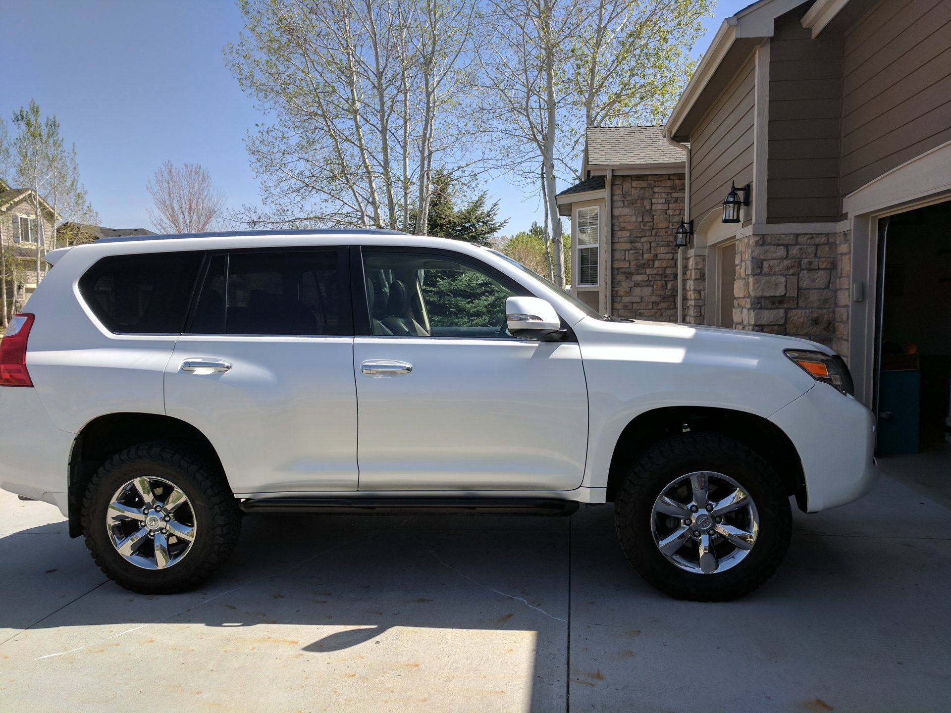

That is a great looking truck. What size tires and is there any rubbing? Did you need any wheel spacers? Also, who made the sliders and any problem working around the hydraulic lines? Thanks
@zman7980 your truck looks great! In talking with Mark at MT4x4, the bumpers for the GX460 were designed to look identical to the Goblin and Pegasus bumpers for the GX470. He wanted to make the front bumper fit without having to cut the factory bumper. As for the rear he basically told me that in order for it to not look too bulky, you'd have to cut the rear bumper since the sides of the factory bumper go all the way to the tail lights. Luckily for me, I have my old rear bumper from some collsiion work I had done and will use that to cut so I can keep the stock one if I ever go back.
I haven't seen too many pictures of the rear bumper for the GX460. Even if the rear bumper is massive, its got to be better than the stock bumper in terms of clearance! Every time I wheel, I drag the factory tow package. Luckily I have that or I'd probably ripped my bumper off!
thanks tucsonix. I am running 255/70/18 ko2's..a little narrower than most are running, but I got a screaming deal on them and they work for me. I am not currently running wheel spacers. I have a tiny bit of rub on the front driver side, but only at full lock going over a bump. I have trimmed most of the splash guard away, so it's a very minor rub. The sliders are Metal Tech. @stilespendleton had a good write up earlier in this thread on the drivers side KDSS lines. The passenger side bolted up piece of cake, and on the driver side, these sliders are fabbed to fit under/around the KDSS lines and bolt mounts. It took a little extra time to mount up, but all in all, it was a pretty simple install.
