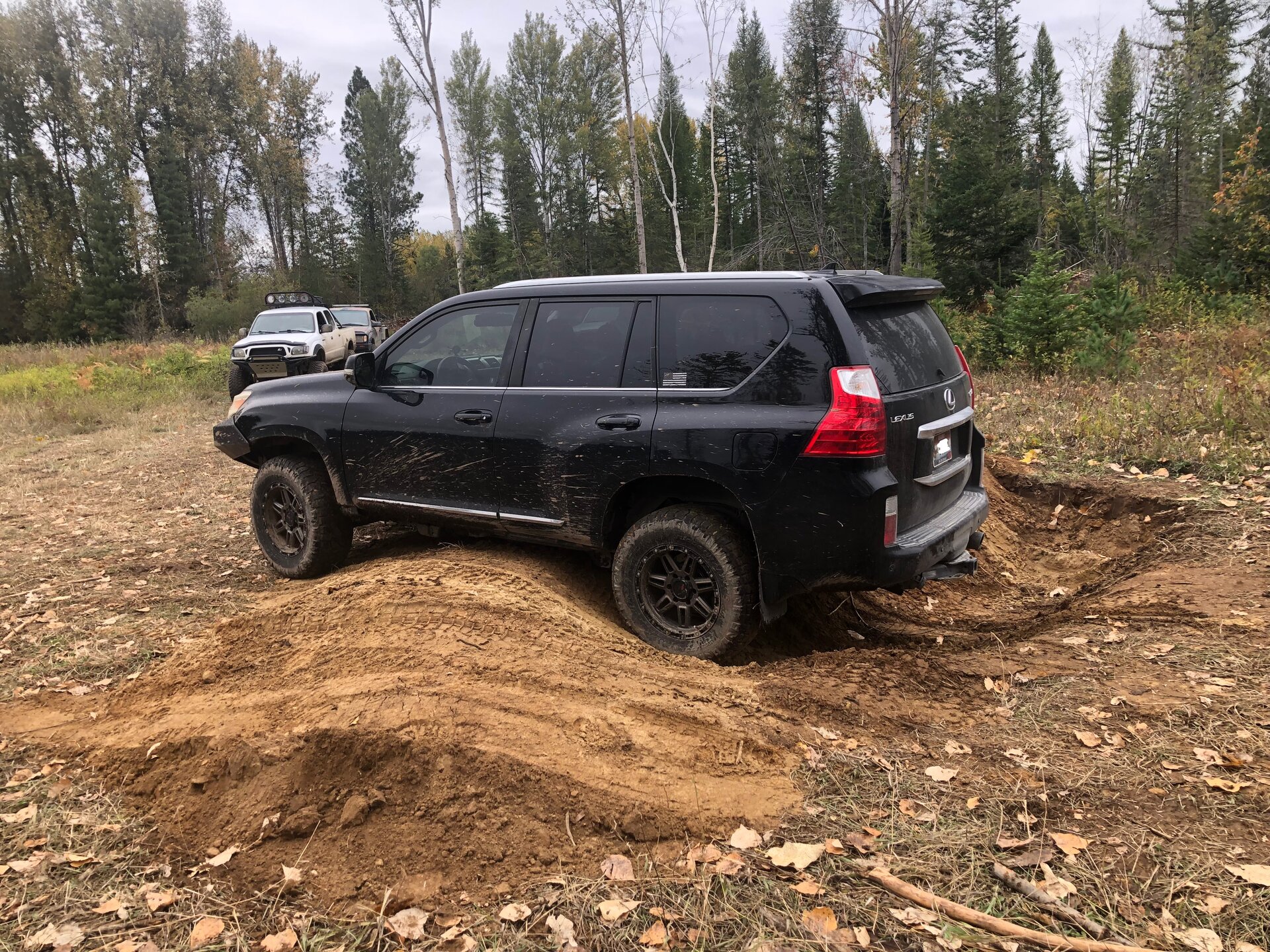

I spent so much time talking and dealing with the girls I neglected to get very many pics. Only two lame "action" shots on two different days. At least I got mildly muddy. Now it's time to clean up to prepare for winter!

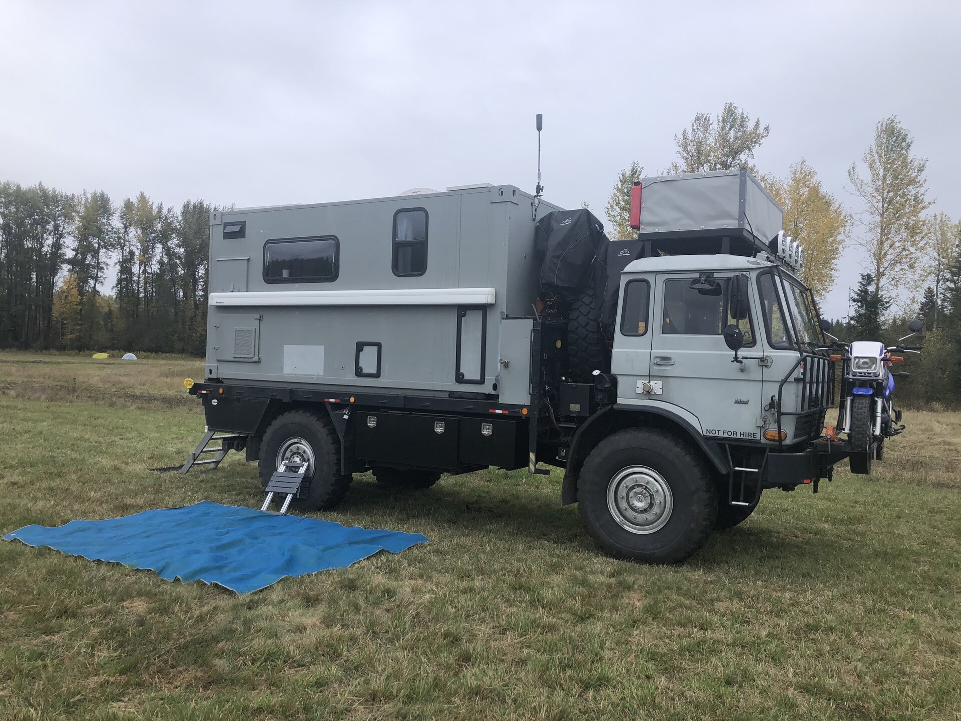

My favorite (non-GX) rig there I gotta say was this epic DAF. Nice folks too.

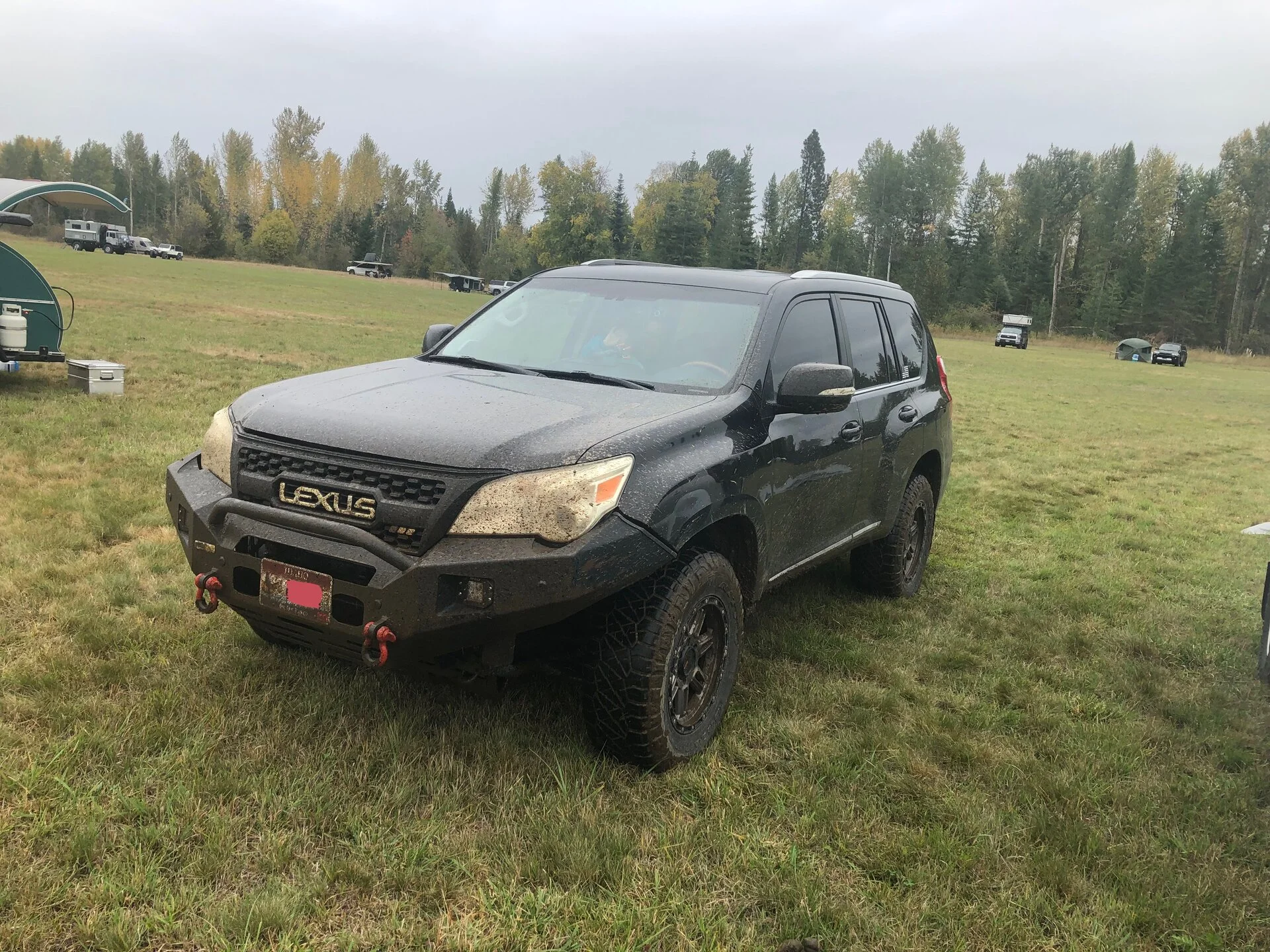

2 things that black in the first pic makes me jealous i didn’t go black for that clean reflection.
second i wish i could trim my steps but my wife uses them too often
I hate that I had to get black. It was the best condition one I could find. I'll be raptor lining it another color hopefully next year.
Had to clean it to get it winterized. Otherwise I love it dirty. LOL

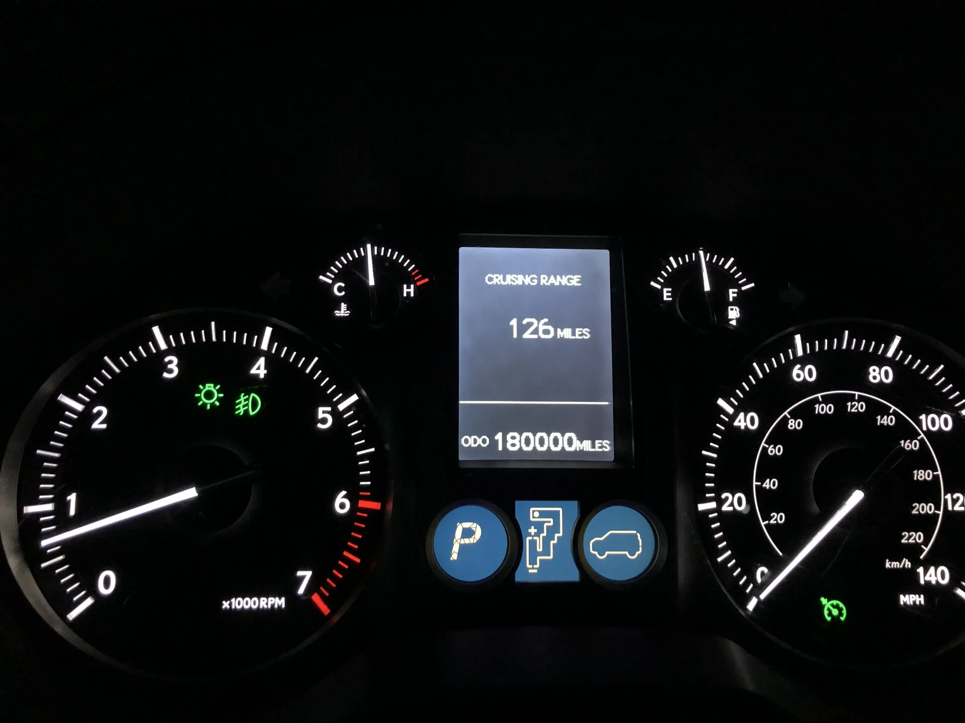

Ok, update. I'm about 44 miles from the next mileage milestone (180k). My belt squeak is back but I am not sure if that's because I have no splash guards and the moisture from all the rain, snow and puddles is causing it or there is a coolant drip on it. I do not see any coolant leaking so that's gotta be out. The last thing is maybe it's my idler pulley? I replaced the tensioner but not the idler pulley. Will have to address that next year.
The second thing is are my codes are/were back. P0108, P0441, & P0455. So I replaced the gas cap with an OEM one but that didn't solve it. Then I replaced the vacuum switching valve (25860-31060) and that fixed the P0441 & P0455 codes leaving the P0108 code left. I'm beginning to think the Chinesium MAP sensor is faulty already. I just cannot afford the OEM MAP sensor and the vehicle runs fine so I'm going to have to wait to replace it with OEM.
The odd thing is the P0108 code clears itself and pops up daily. What else could it be causing that issue? Should I run some sort of intake cleaner through the system?
Before messing with the sensor, check for any leaks after the sensor in the intake hose. Loose clamps, cracks in the intake hose/tube itself. Often it's not a sensor issue but something downstream causing the false reading (especially since it's the ~108, sensor high).
