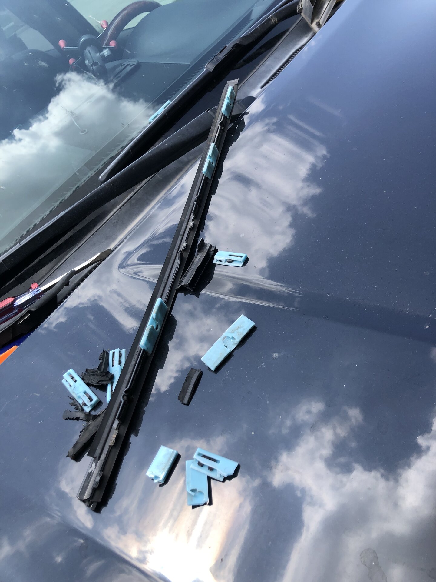

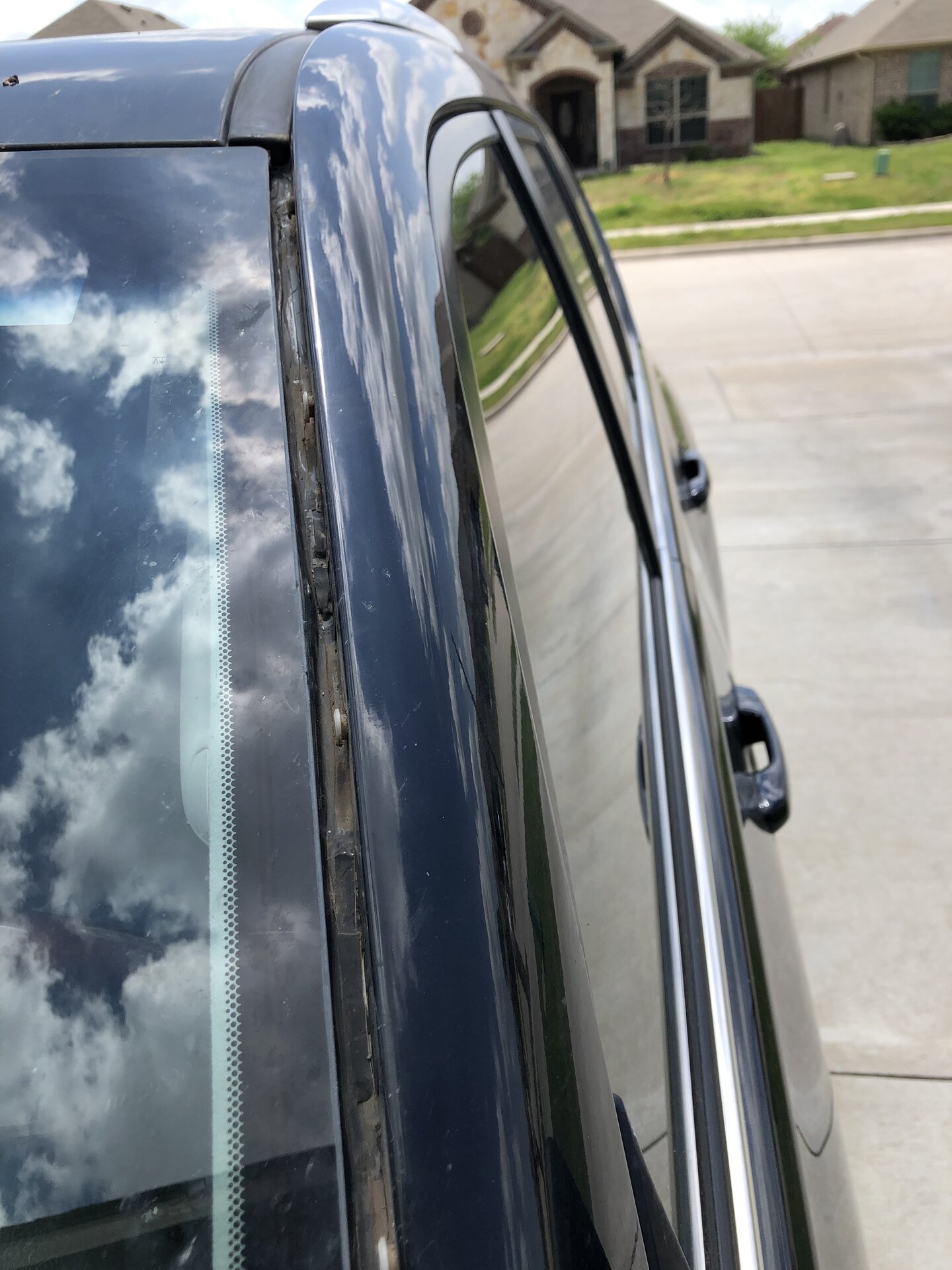

Did all little work today on the girl. Replaced both sides of the exterior windscreen trim and put on a new hatch spoiler trim cover panel (RH). There's some rust I'll need to tackle in these tracks on each side of the windscreen when I get around to raptor lining the whole truck.
Take a look at these pics, these clips and trim pieces age and get very brittle. This causes them to not be seated as well as and this causes some slight wind noise. They aren't expensive to replace ($18.59ea on partsouq) and the clips are on amazon for ~$8 for a pack of 10.
Take a look at these pics, these clips and trim pieces age and get very brittle. This causes them to not be seated as wells and this causes some slight wind noise. They aren't expensive to replace ($18.59ea on partsouq) and the clips are on amazon for ~$8 for a pack of 10.
