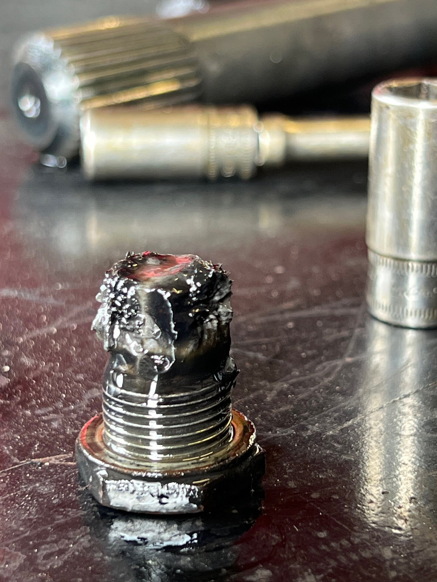

Dropped rear oil and checked mag plug.
Deff some metal shavings. I've seen worse but the front had none of this.

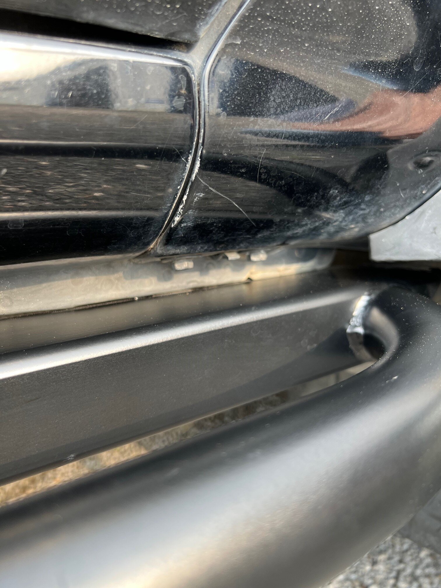

Been driving this thing as much as I could and the noise seem to be right be low my foot. More noticeable after hitting bumps or those reflectors on the road.
Started banging on the lower fender/doors area by hand to see if I could hear anything. Banged on my new rock sliders and it resonated a bit.
Wedged a piece of cloth between the slider and body and went for a test drive.
And just like that the clunk was gone.
I guess the best outcome is that I know my axles/driveshafts/wheel bearings are super solid and won't need servicing for awhile lol JFC
