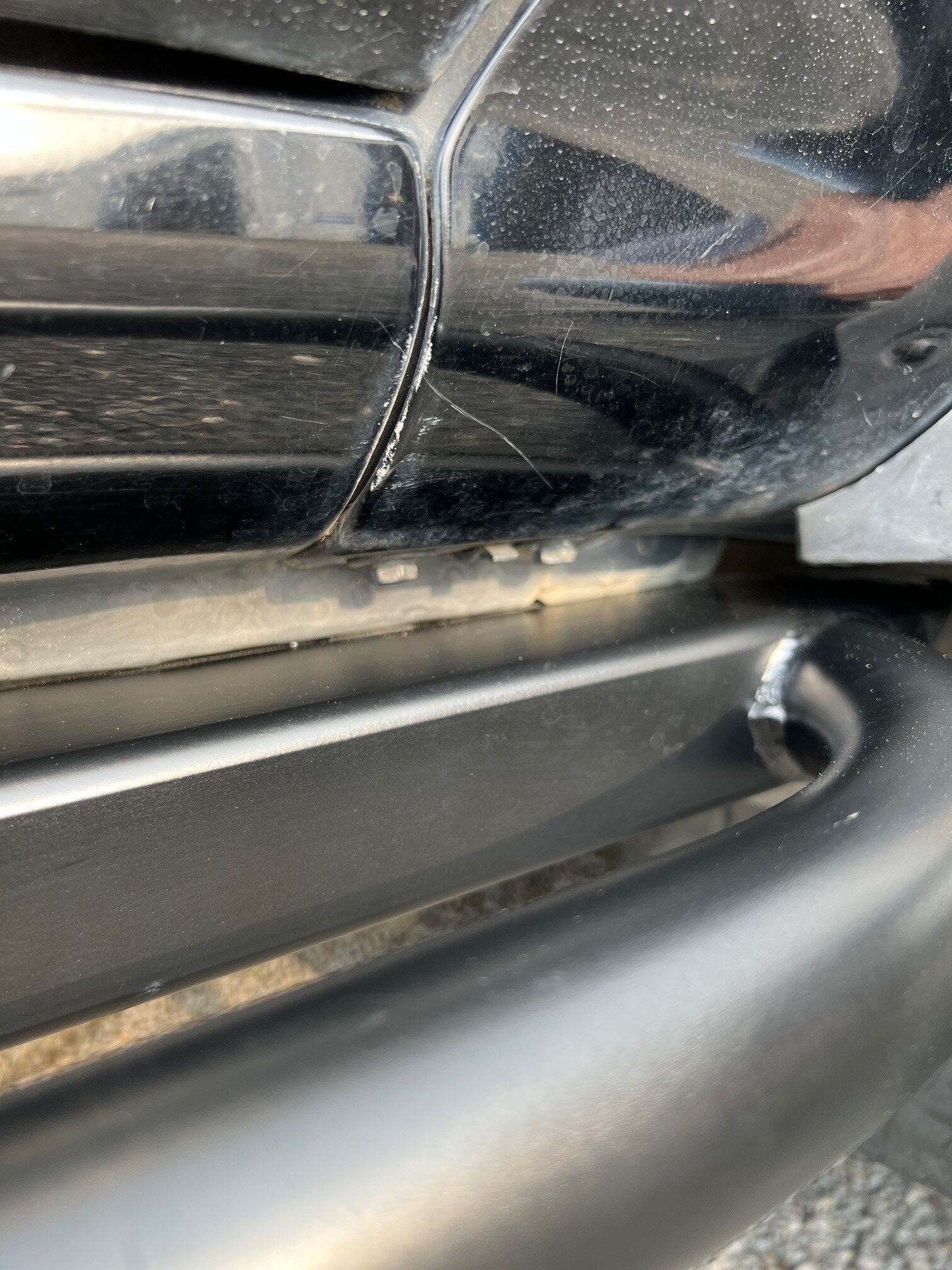

Started banging on the lower fender/doors area by hand to see if I could hear anything. Banged on my new rock sliders and it resonated a bit.
Wedged a piece of cloth between the slider and body and went for a test drive.
And just like that the clunk was gone.

Are the frame mounted Rock sliders tight to the body ?
They look like there pushed right up to the pinch seem.
I see issues with that !
These are indeed White Knuckles.
Fit is nice and tight. I believe the 4 bolt holes towards the front are notched that go to the frame. I'm going to check again.
