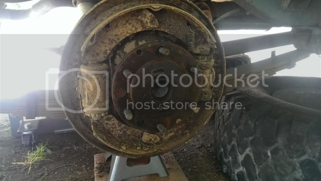

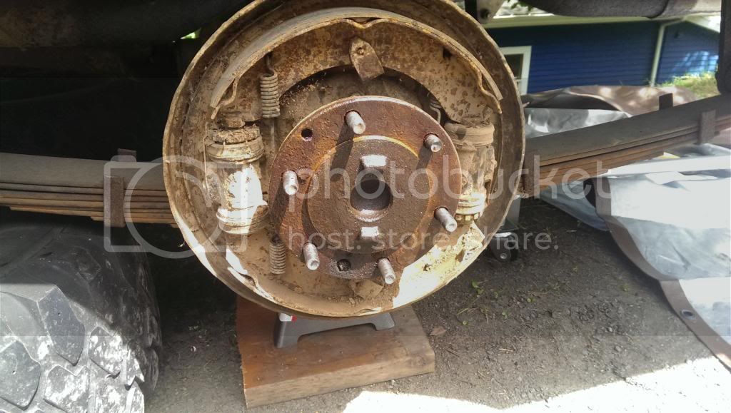

Today I went at it after getting off work. Put on some eye and hearing protection, doused the studs and hub in spray again, and really started wailing away. I'd give the drum a good solid whack with the hammer, turn it a little, and repeat. After about 10 minutes of this the drum popped right off. The other side went even faster once I knew what to do. After getting both drums off this is what i'm left with:
Passenger:
Driver:
Looks like a few of the cylinders are frozen up, and everything else looks pretty worn. After doing some reading i'm tempted to swap it over to discs. :grinpimp:
Duel cylinders are a pain, but when set up and adjusted right, good brakes. I'm on the fence, about drum or disc. too many variables. Cost for parts, cost to have done, etc. What all to replace ( while you're in there ) can of worms.

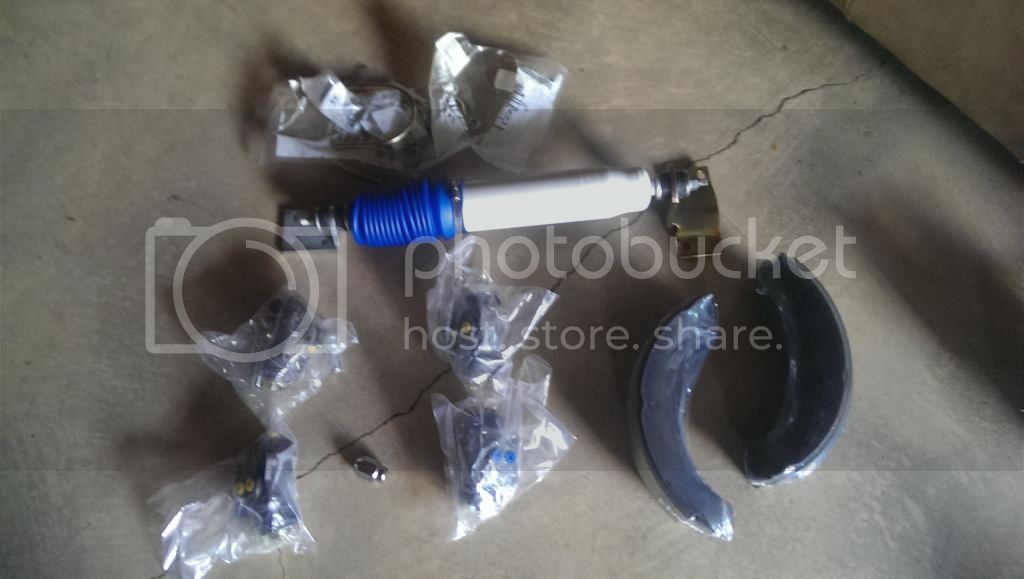

Got a pile of parts earlier this week:

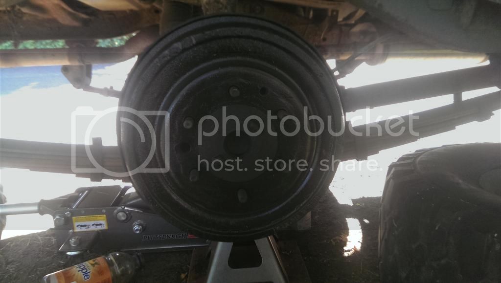

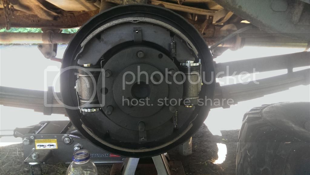

Painted the drums, cleaned up the backing plate and hubs, and put everything together:
Adjusted the cylinders, bled the whole system until the fluid ran clear and air free for a while, and...
The brakes still don't work. :bang:

Haven't checked the booster, but if it was out wouldn't the peddle be harder to press and not easier?
Pumping the brakes results in some pressure, so there might still be air in the system somewhere? Would a residual valve help at all?
