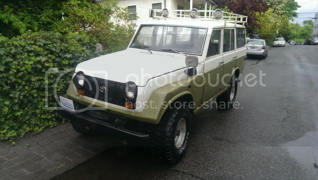

Well I just bought a 1978 FJ55. Originally smurf blue, now green. Very little visible rust, bucket seats, power steering mod, and more.

Pictures! :pig:
Thanks. I might put the stock grill and indicators back on at some point, but for right now it looks alright if a bit more unusual.

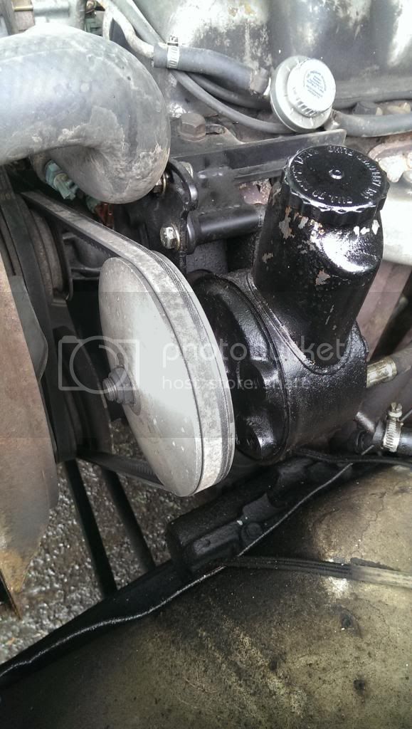

If power steering is in the future, you may consider the options, since some use the rods/ rod ends and the center arm, that are probaby causing your sloppy steering, others don't.

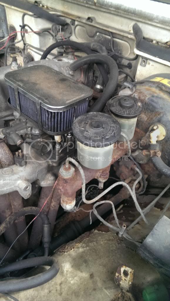

Same with master cylinder and brake booster (which would be worth testing, too). There are options, but if intake or carb change is inevitable, better choices to save space.

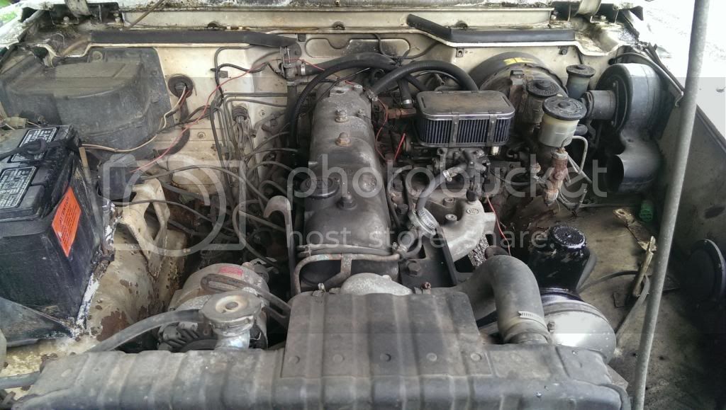

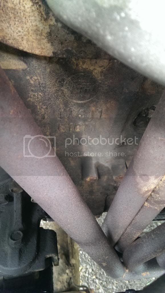

Since POs have usually hacked these up, take a bunch of pics under the hood, find the casting number on the block and post, since it'll be asked for.
It's already had power steering and a Webber carb swapped in, as well as fully de-smogged. My plan for now is to get it to what I consider drivable, and then fix some of the cancer and other small issues.
Engine bay:
Block:
Carb and Brake Master/booster:

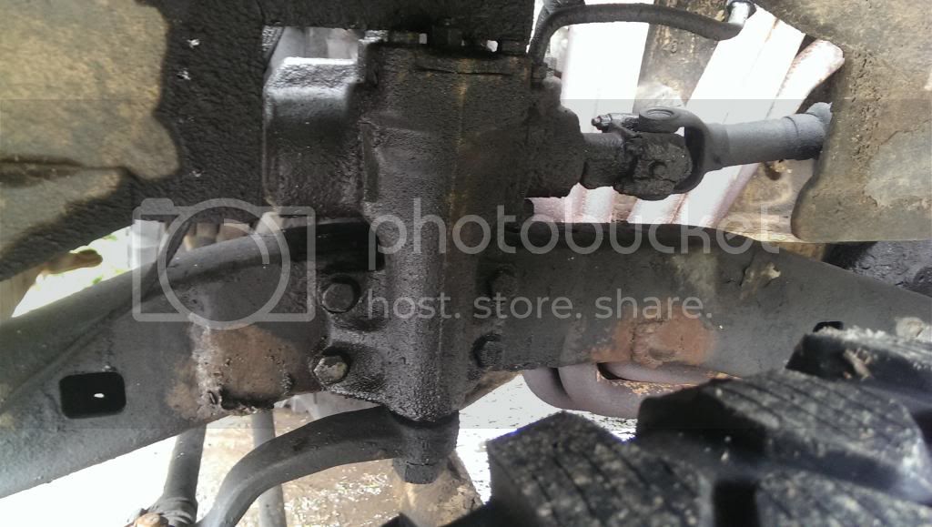

Power Steering Pump and Box setup (including missing/broken shock mount):
not broken. it was torched out to put the power steering box in. manual gearbox mounted with shock

The previous owner claims it broke off when he was out wheeling. It's an aftermarket hoop style mount which was put on when the power steering conversion was done. Currently it's sitting in the back of the truck until I can get my hands on a welder to put it back on.

Also found out part of the cause of my sloppy steering, the box had come loose from the frame a little bit. Tightened up the bolts and there was a noticeable improvement. The shaft itself still has a lot of play though.
