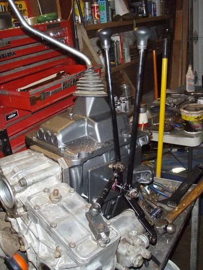

WOuld you mind taking some close ups of how yo made your twin stick ont he t-case?

as for the twin sticks they were really easy to make I re used alot of stock pieces the shifter rods are 3spd tranny ones with drill press handles, made a little arm for the hi-n-lo shifter and the 2-4 is pretty much the stock setup cut it and re welded to match offset
