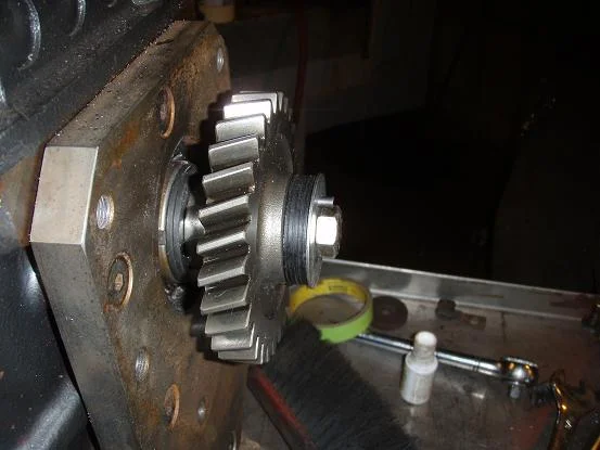

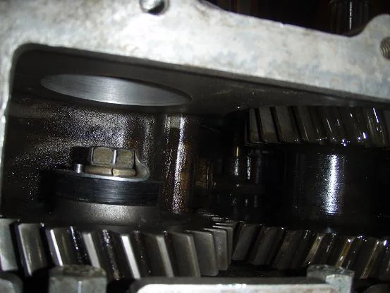

heres a few more of how its set up

Thanks for posting up those pics. So you feel the plate adapter is better than the AA one? Did using the plate mean you didn't have to modify the driveshaft length?
I will have to contact Classic Cruisers and get a price - $500+ for an adapter seems high. Like you I got the trans for nothin and already have the 3spd TC.
i think the steel plate is better than a 6 inch adapter made from aluminum it just seems like a more direct way to attach and way tighter pakage almost like stock
best would be a plate adapter with a custom output shaft for the 465 that would let you use all the bearings in the tcase aswell as the pto gear
drive shafts were both custom made for my setup i have 60 rears so the rear shaft is longer made from a rear pickup shaft with a landcruiser end, also the front has a trail gear long spline attached to minitruck cv.
