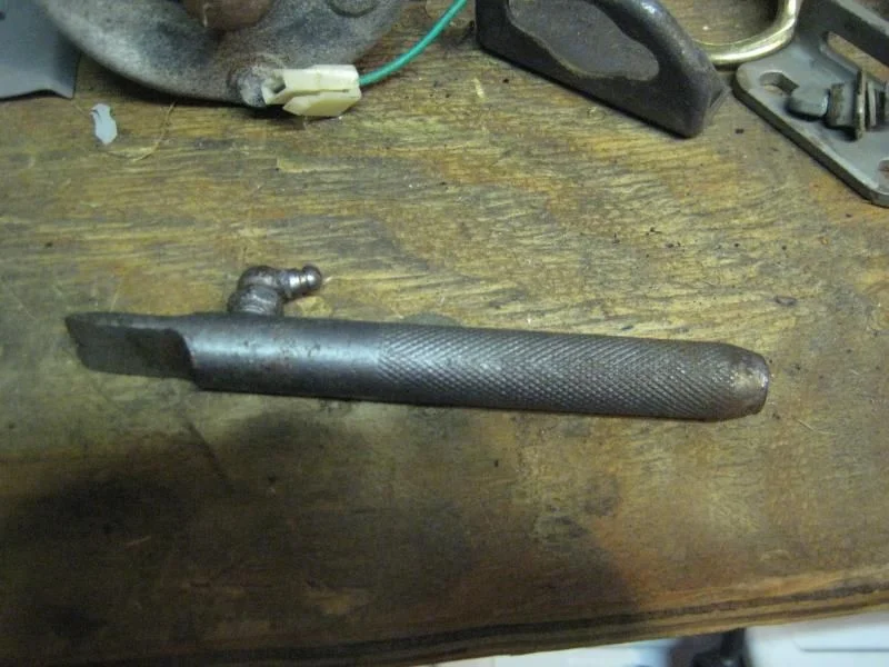

I use a 'Stop-Squeak Lubricator' for springs... father was a trucker and previously worked at Grumman... came from his time lubricanting aircraft stuff ... great tool to get in between springs
Thanks, Johnny. I'm not much of a tool collector, but I researched the company a bit--they made some interesting specialized hand tools--most from vanadium chrome steel alloys. Found some photos with tool numbers, but not No. 198.
Kind of a shame that a lot of specialized tools are lost to history. The stories behind their development, and the logic in their designs, show some real ingenuity that very well might have applications to present-day needs. Thanks for sharing.
