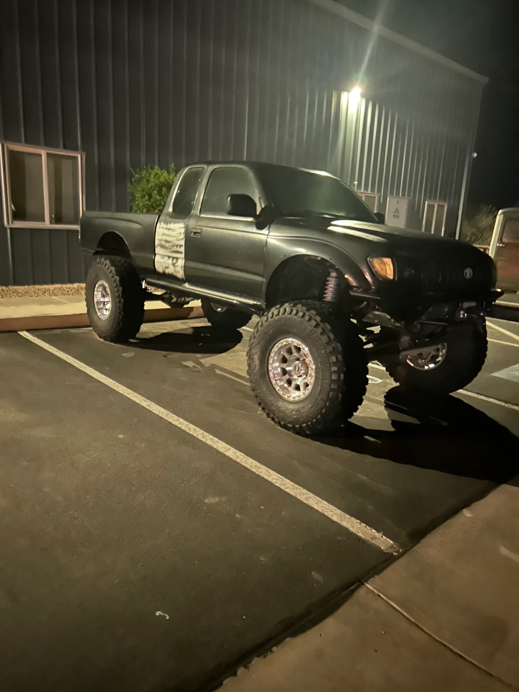

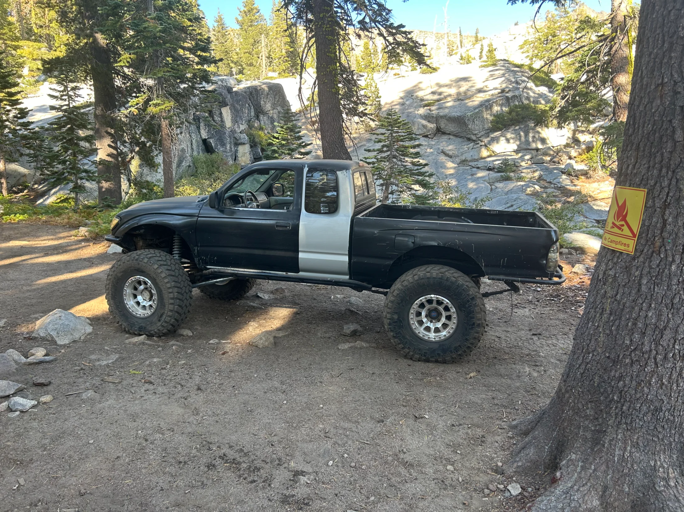

Ok i figure i would start a new thread so i dont have to look at my old 40 :cool: and i can enjoy this new one .
2002 Tacoma Ex Cab
Currie Built 9 inch diffs Front High Pinion ARB Lockers Dana 60 outers 35 spline shafts Wilwood Brakes
3 link front
Fox 2.5 14 inch coilovers with dcs
Rear Chevy 63s
17 Inch. Battle Born Wheels
40 inch Nitto Trail Grapplers
Marlin Crwaler taco box 4.7
All Pro Front bumper
Warn M8000 winch :hmm:
Bobbed Bed 12 inches
Allpro Sliders
Things to do :
4x innovation Cage
Hydro assist
New seats Most likely PRP
Build a low bed rack to mount my hi lift
Build rear bumper
When I picked it up

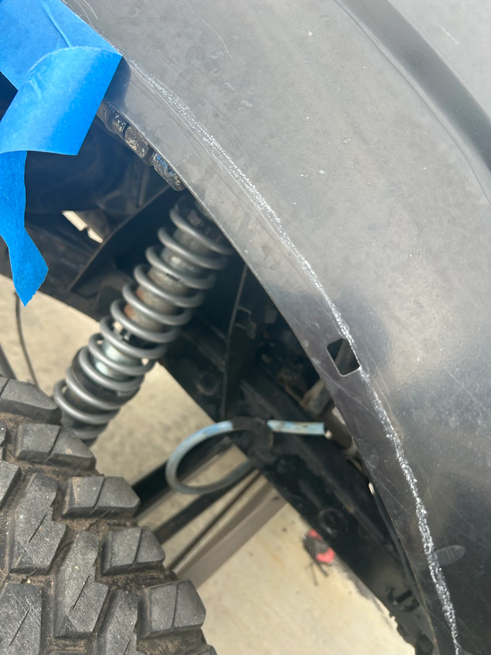

Today I trimmed a fender a little more ( it was not rubbing ) I just do not like seeing the holes from the oe fender flairs. Then I did a test on the color 😎😳.
Cool. Thanks for starting this thread. Did you bob the bed on this truck?
Yes . At first I thought I was just going to pull the parts I wanted off of it . Then I thought I would just do a body swap. Put the double cab on the ex cab frame ( same frame just 4 different mounts ) . Then I thought I really don’t want to be wheeling real hard stuff with a car load of people so keep the ex cab for that and build the double cab for more mild stuff .

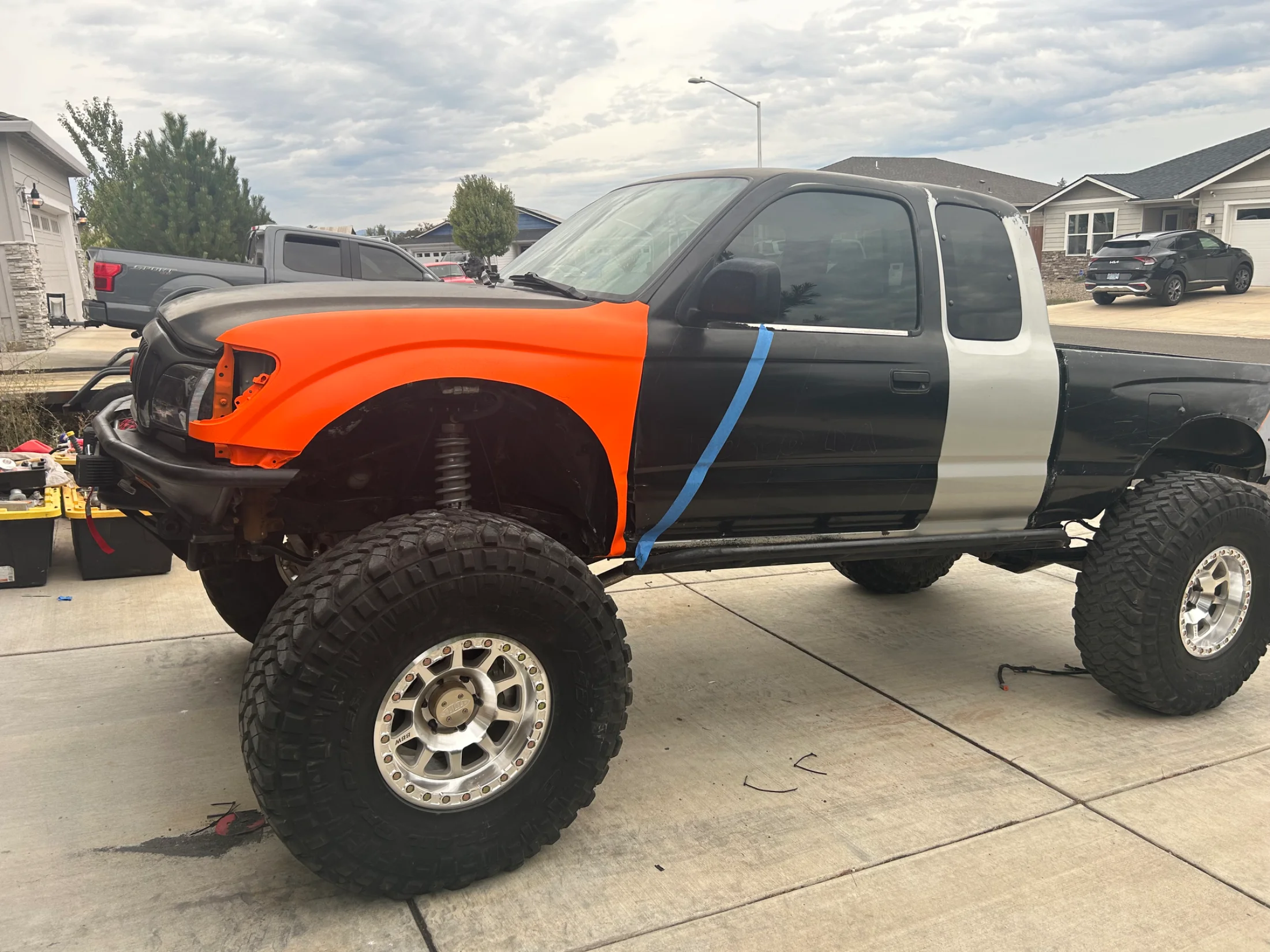

I had to respray the fender. And it turned out ok this time. Then I did another sample just to make sure I like the orange . 🍊. Then I messed with the bumper a little more I got some 1 1/2 x 1/4 square tube Now the fun part. Tie the corners in 🙄.
I think I am going to use Cement grey Black and the orange
I'm a lover of 🍊 but wow, that is beaming neon super safety right there... are you going to tie it in with a 2 or 3 tone? Orange goes with everything. Grey, black, white, purple, blue even tan.

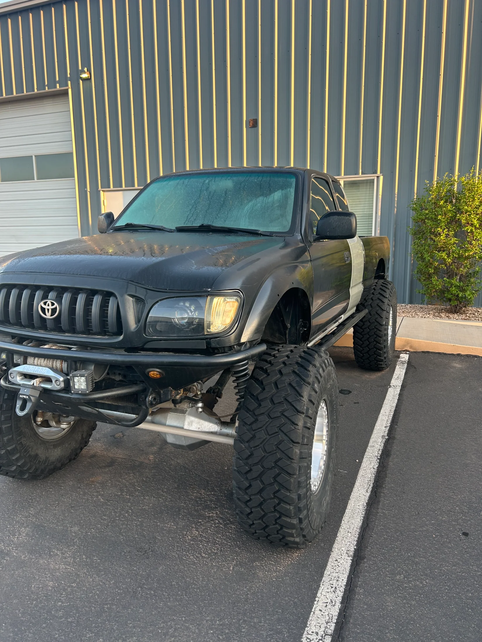

Did a little more work on the bumper today I will finish it up this week
In hindsight I probably should not have done the black stripe but I think it will come together when it’s all done The majority of the bed will
Be black
