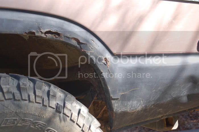

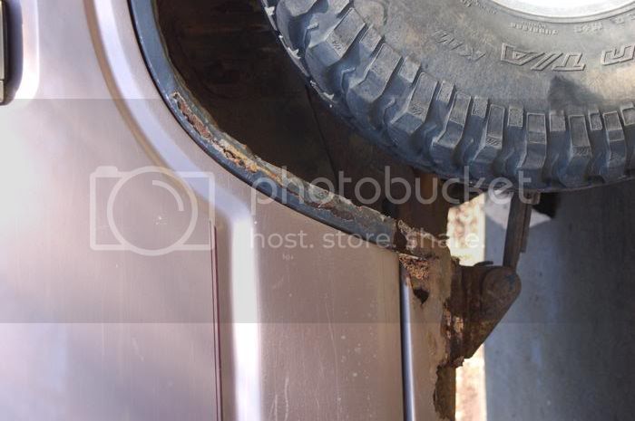

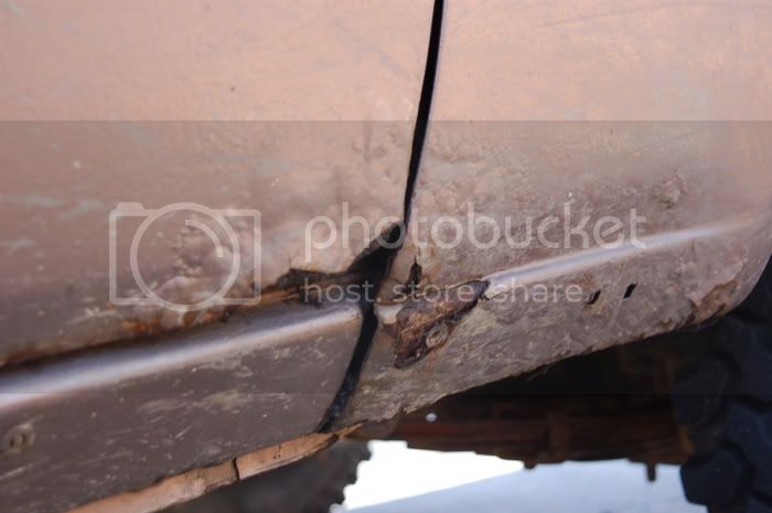

Out west is probably the best place to find a clean body. you can find pretty solid rigs down here but you gotta be patient looking. The most common rust areas are around the rear wheel wells. Other trouble spot include the rockers, front fenders behind the front wheel wells, around the windshield frame under the seal, where the rear tailgate hinges bolt to the body, the rear most body mounts, bottoms of the doors, etc...
Down here, frames are usually pretty clean unless the truck spent some time in the salt belt, and roof gutter rust is more a problem for coastal tucks. Both are areas worth looking at though. If you can find one that has been in the south its whole life, chances are it will be in pretty good shape.

Thanks for the target areas, Gehn. I have a good idea that tailgates, front fenders, doors, and hoods are pretty easy to replace. What's the worst area to repair, given equal rust penetration?

You're right, all bolt-on panels can be replaced so the more difficult areas would be the rear quarters, rear body mounts, rockers, floors, etc. In my opinion, the roof rust would be the worst. Rust around the windshield can be bad too because you often don't realize it's there until it's fairly developed.
If you get a 62 watch out for rust around the chrome strips under the doors. Also, if it has or had the toyota mudflaps it could have rust around those.
