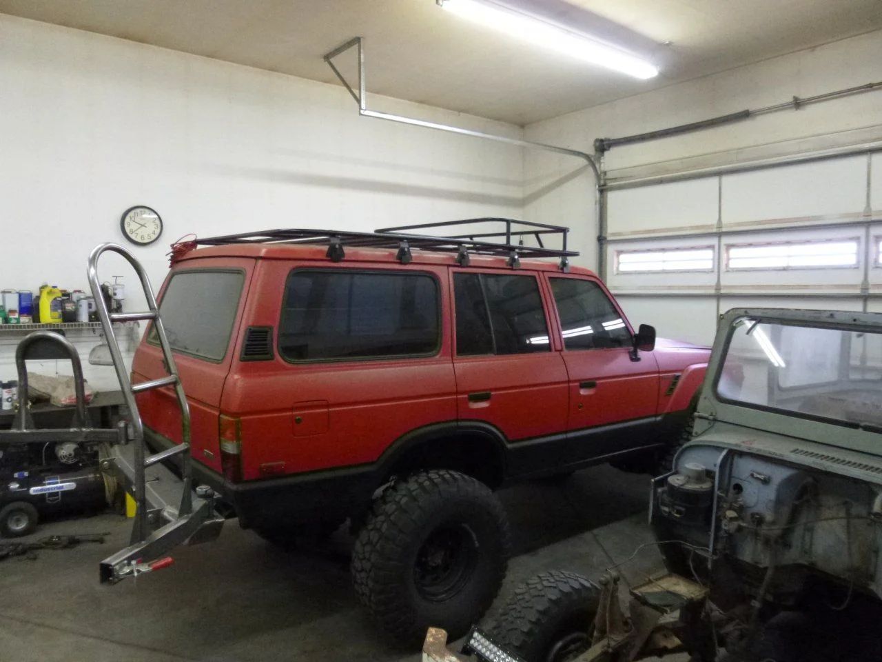

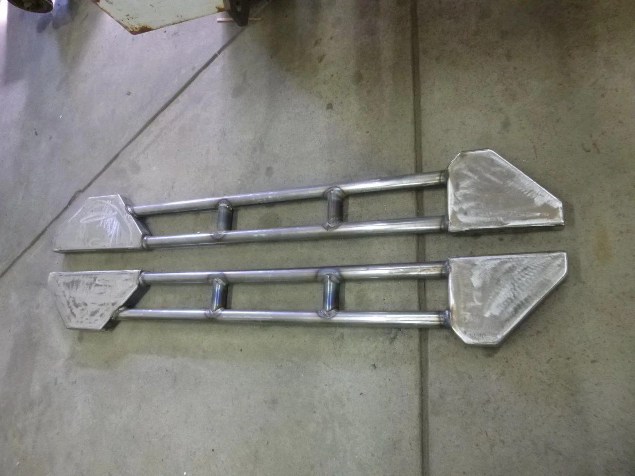

Those sliders look boulder proof. Nice work!

**** J, they look EFP proof. They should have hired you to make armour for the DoD

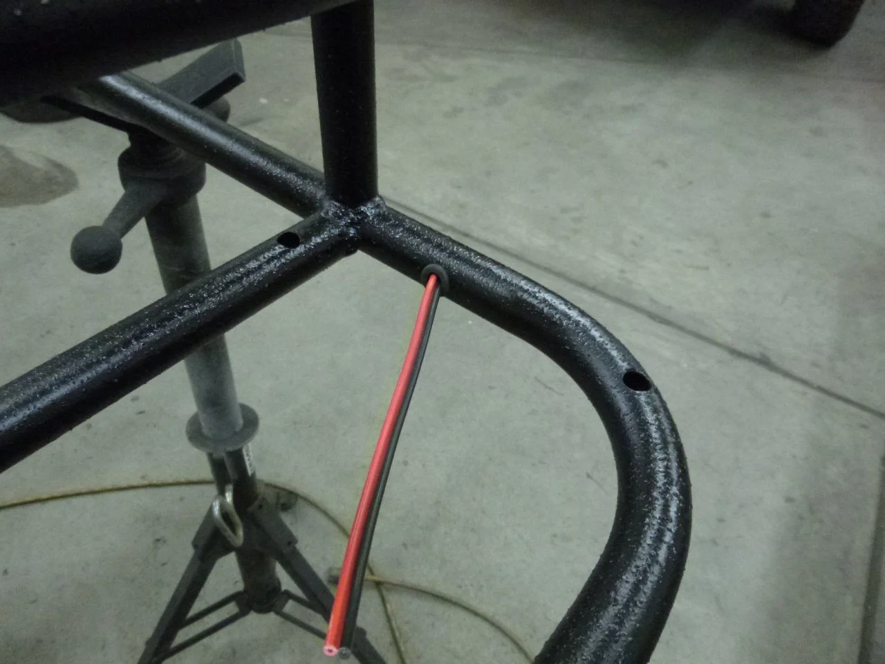

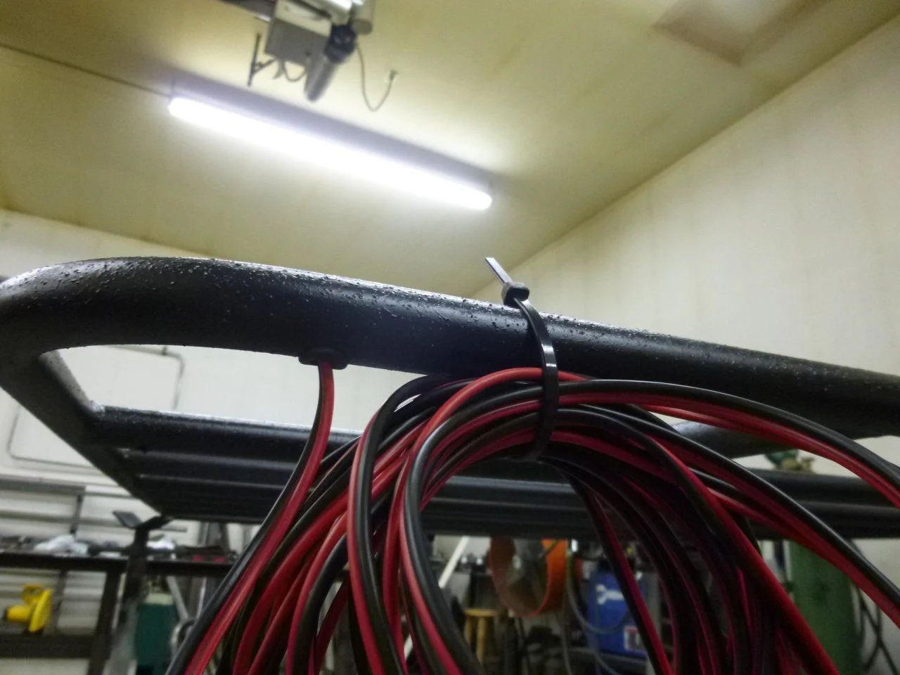

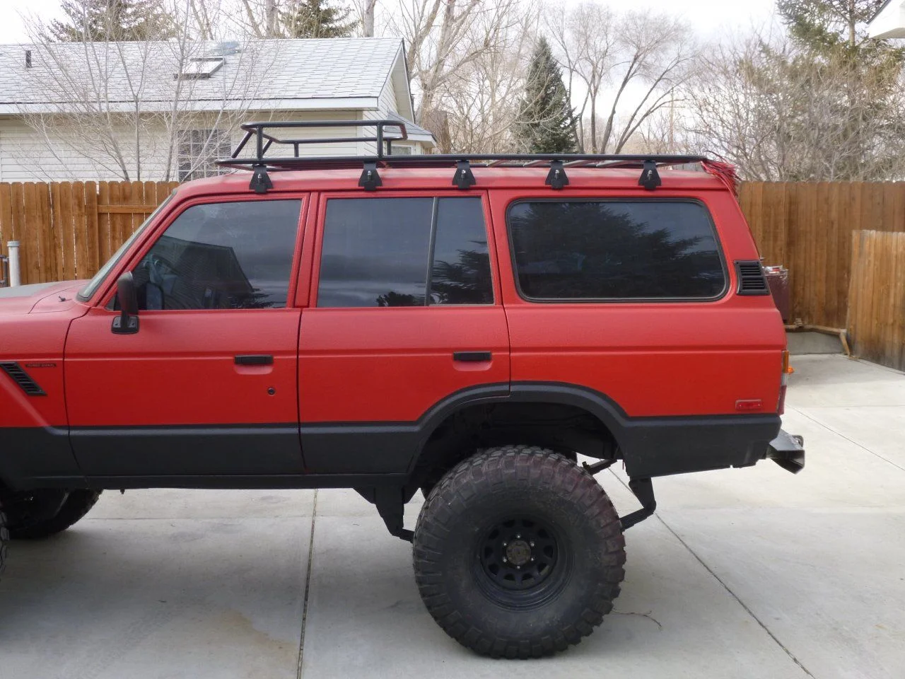

I'm curious to see how thou run the wires through the roof. I have a 5/16" hole in mine stuffed with silicon and my feet get wet, probably will weld it up.

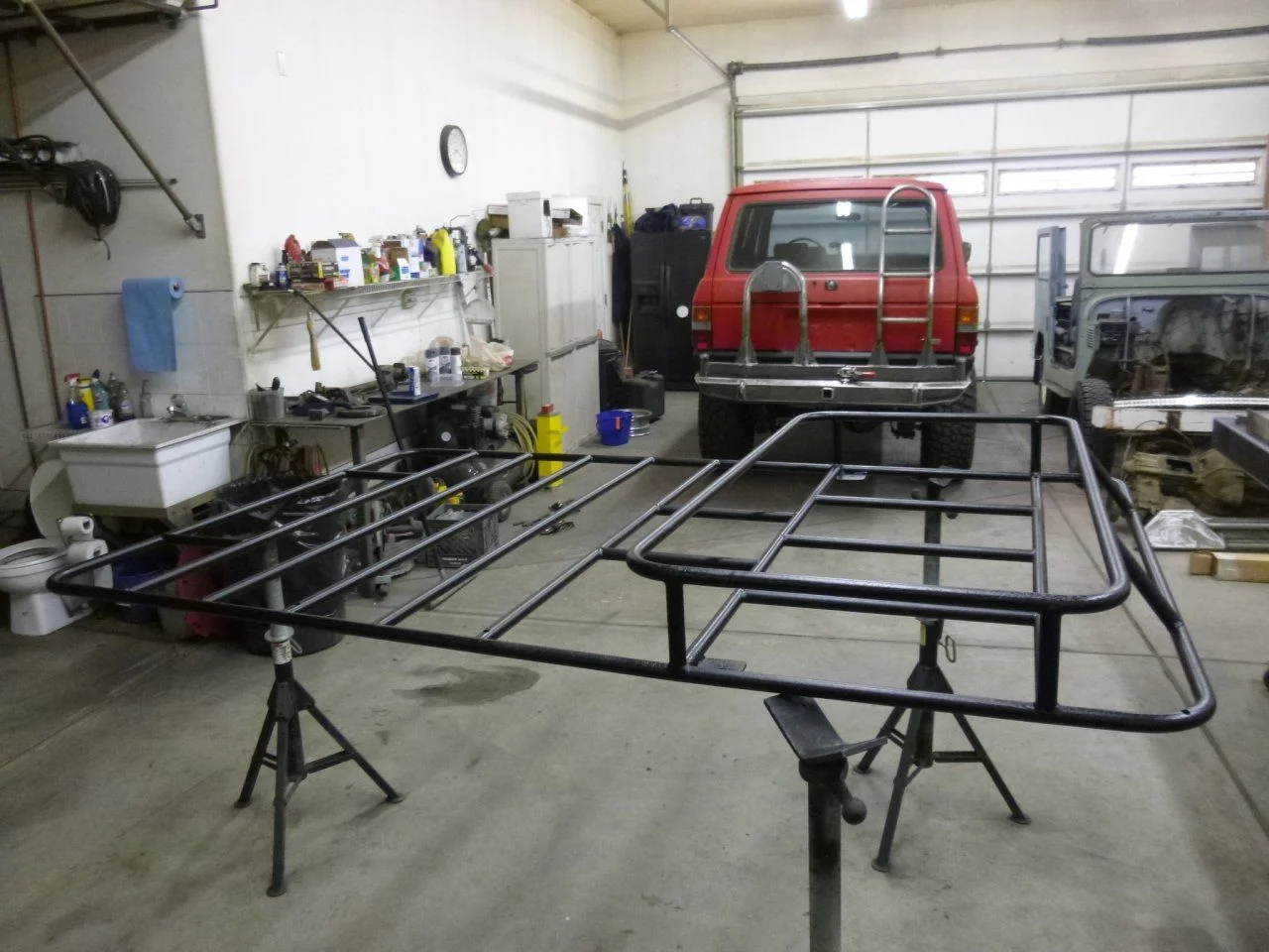

Come back to the rear hatch and in through an existing grommet or drill a new hole and install grommet. The wire (s) from the rack to the hatch get a wire loom wrapped around it. Pretty easy.
Its a long way around, but the cleanest and less maintenance down the road.
J
Can you take some pics when you get these wires routed? How many wires will go through your grommet?

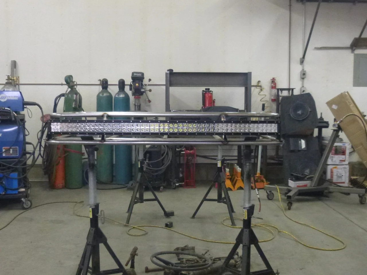

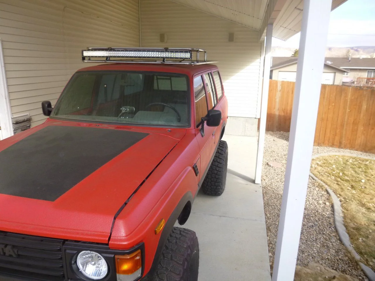

Sliders and rack are looking good!

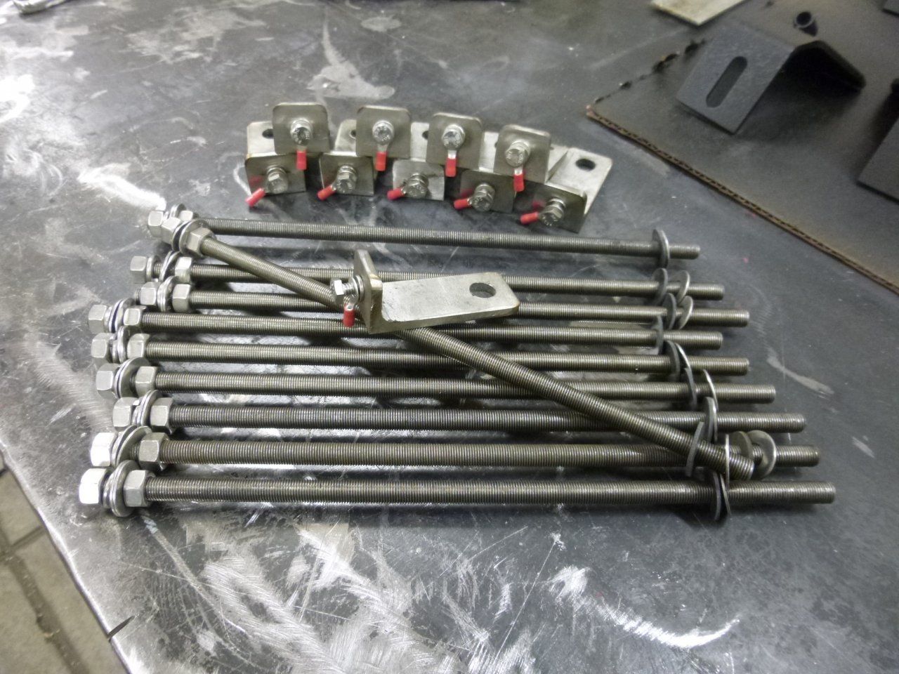

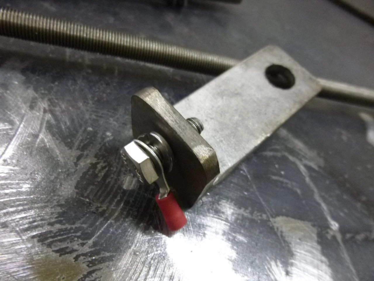

Well guys I made 10 of my WagonGear CLONE radio/CB combo mounts. Several of you have inquired.
Here they are. All 304 and 316 stainless steel components.
https://forum.ih8mud.com/threads/fj60-cb-radio-combo-antenna-mounts.835811/#post-9568505
Cheers,
J
View attachment 1024741 View attachment 1024742 View attachment 1024743
Ordered! Thank you J
You're selling me on the two tone black and red.
