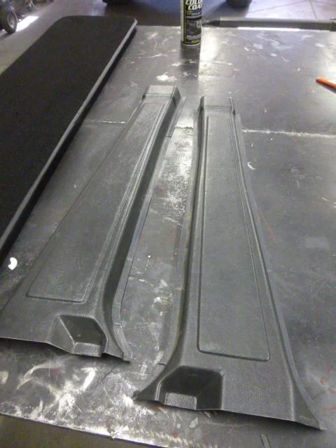

The Wet Okoles do cover the back of the rear seat. Full coverage. With nicely crafted cut-outs for the seat stay latches (where it clips into the seat bottom when folded).

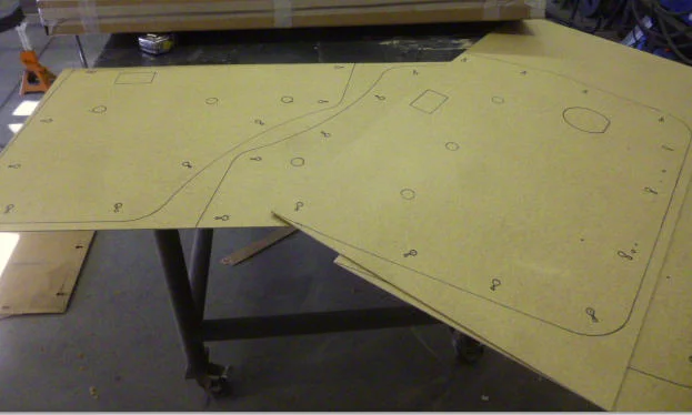

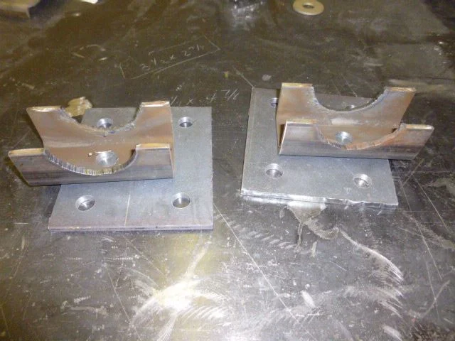

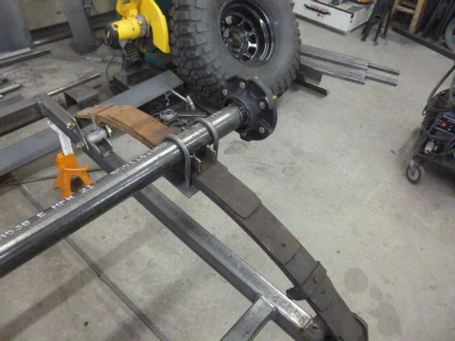

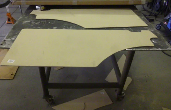

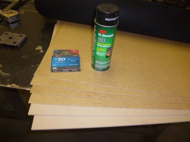

Got some more done on the trailer yesterday (made a set of spring perches and u-bolt plates, finished welding the frame up, built the axle... ready to flip over and start on the side panels, tailgate and top....) and rounded up a few materials today for the door/cargo panels... 1/4" MDF for the cargo panels and 3/16" HDFB for the door panels. Some headliner material (padding) to go under my 4 way stretch marine vinyl. Got 2 sheets of MDF for my rear storage box as well. I will be installing at least 2 (maybe 4) 10" woofers and an OLD SCHOOL Rockford Fosgate Punch 75 (not the new trash RF amps)....

Questions... Did I miss, what type of box are you building for the trailer and those spring perches, did you bend those up on the press? Last one, what thickness metal do you like to use for perches, spring hangers? would they be heavier for a vehicle.

Once I get the trailer flipped over and see how tall it will be (TALL)... I will go with a 12" to 24" side and then throw a top on it as well. Similar to a 416, but the ends more boxed and flat.
I take 3" x 2" x .188" (3/16") rectangle and cut it down for my perches. Easy..... 3/16" is pretty close to what is on my 40 and 60. However the bushing sleeve is 1/4". I made everything 3/16" for the trailer build.
I would be comfortable making them for a vehicle out of 3/16" but with a 1/4" bushing sleeve. Hell these have last 27+ years 60) and 45+ years (40) ....
Trailer build thread: https://forum.ih8mud.com/threads/my-uut-build.821579/
A 4" x 4" bend is as tight as my press will bend the way it is set up now. SO.. I improvise and adapt to get things done....

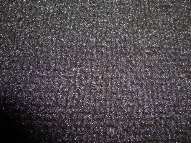

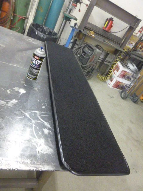

After welding all morning.. I decided to paint/stain the rear tailgate carpet to see what it looked like.. Pretty damn nice if you ask me...
I might just keep it around for a little while...
I might get to play in the shop tomorrow. So, if I'm feeling better, I will try and get all the door glass installed and panels covered in black vinyl..
J

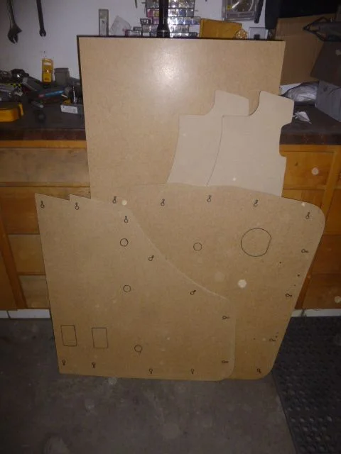

FINALLY... Got all the windoes, regulators, weatherstripping, locks etc.. on all the doors... I got the rear tailgate and hatch blacked out. Started scavenging pieces for the cargo panels.
Pretty good day. Not sure if I will get to the panels tomorrow or not. Next week for sure.
