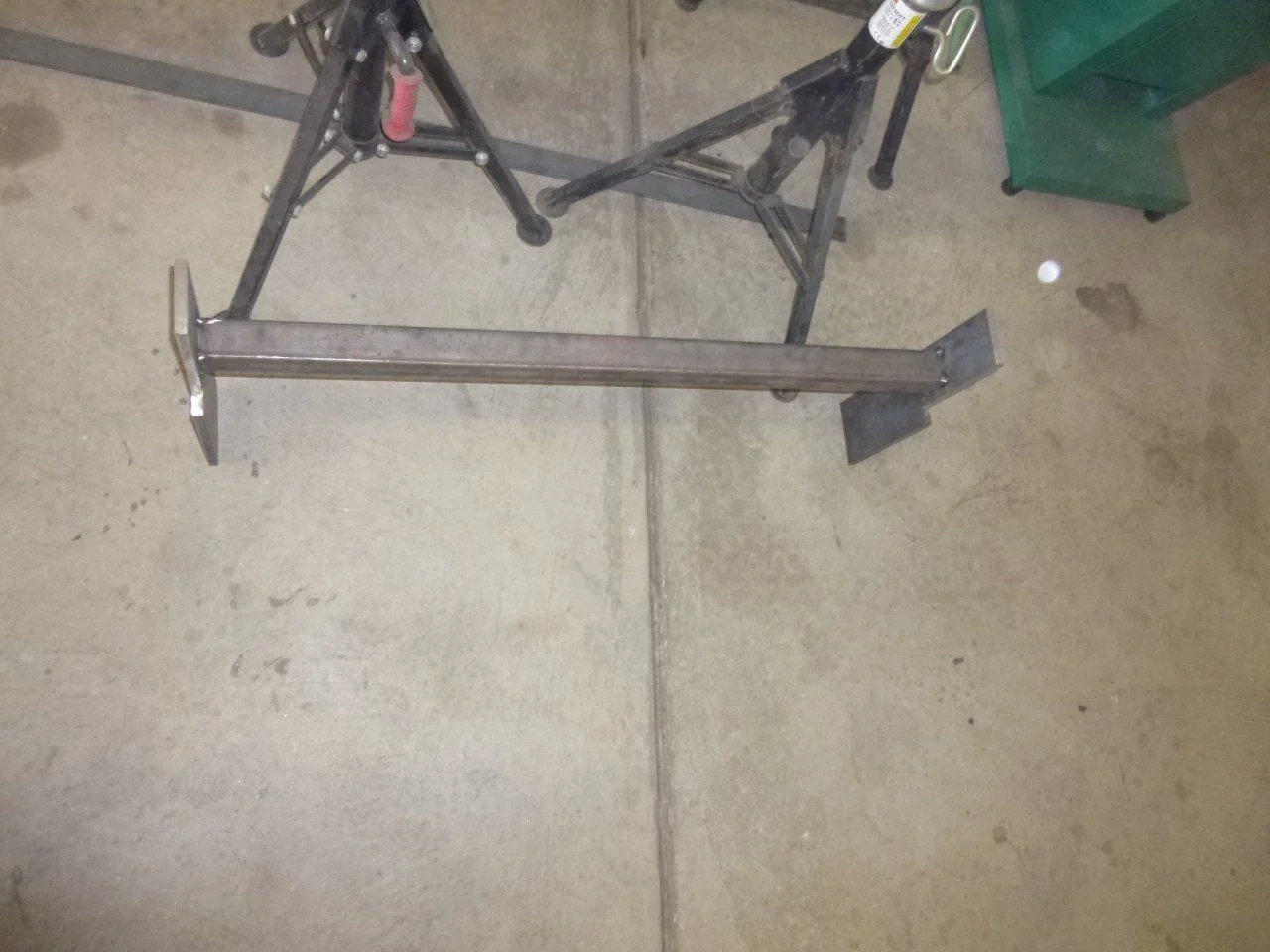

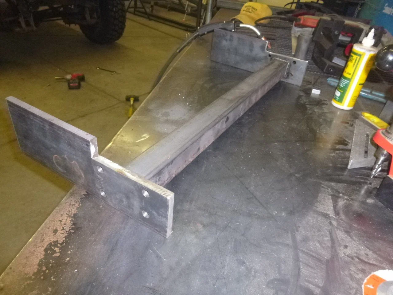

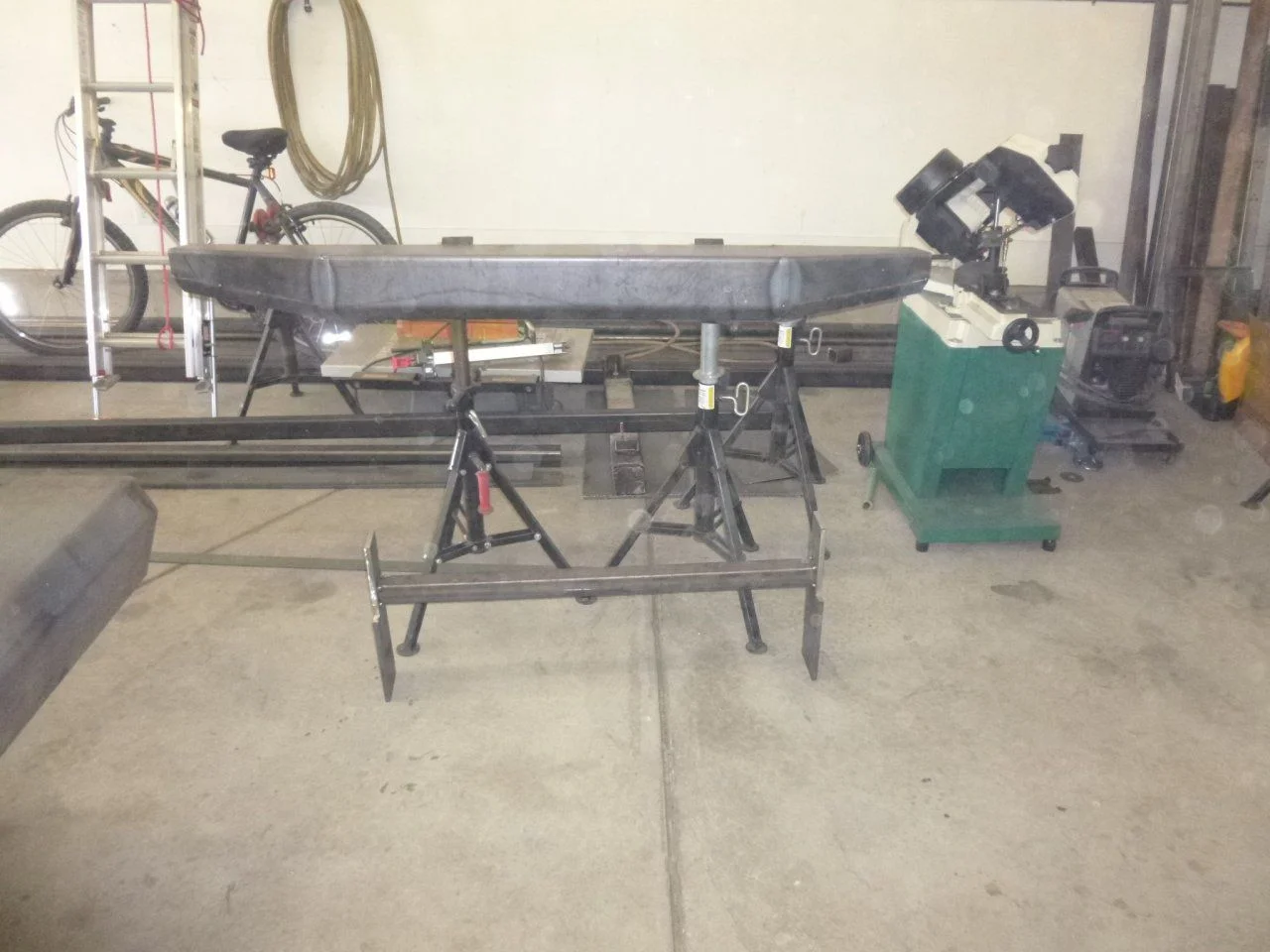

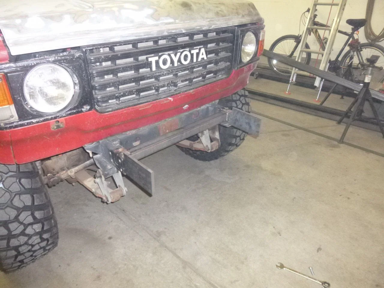

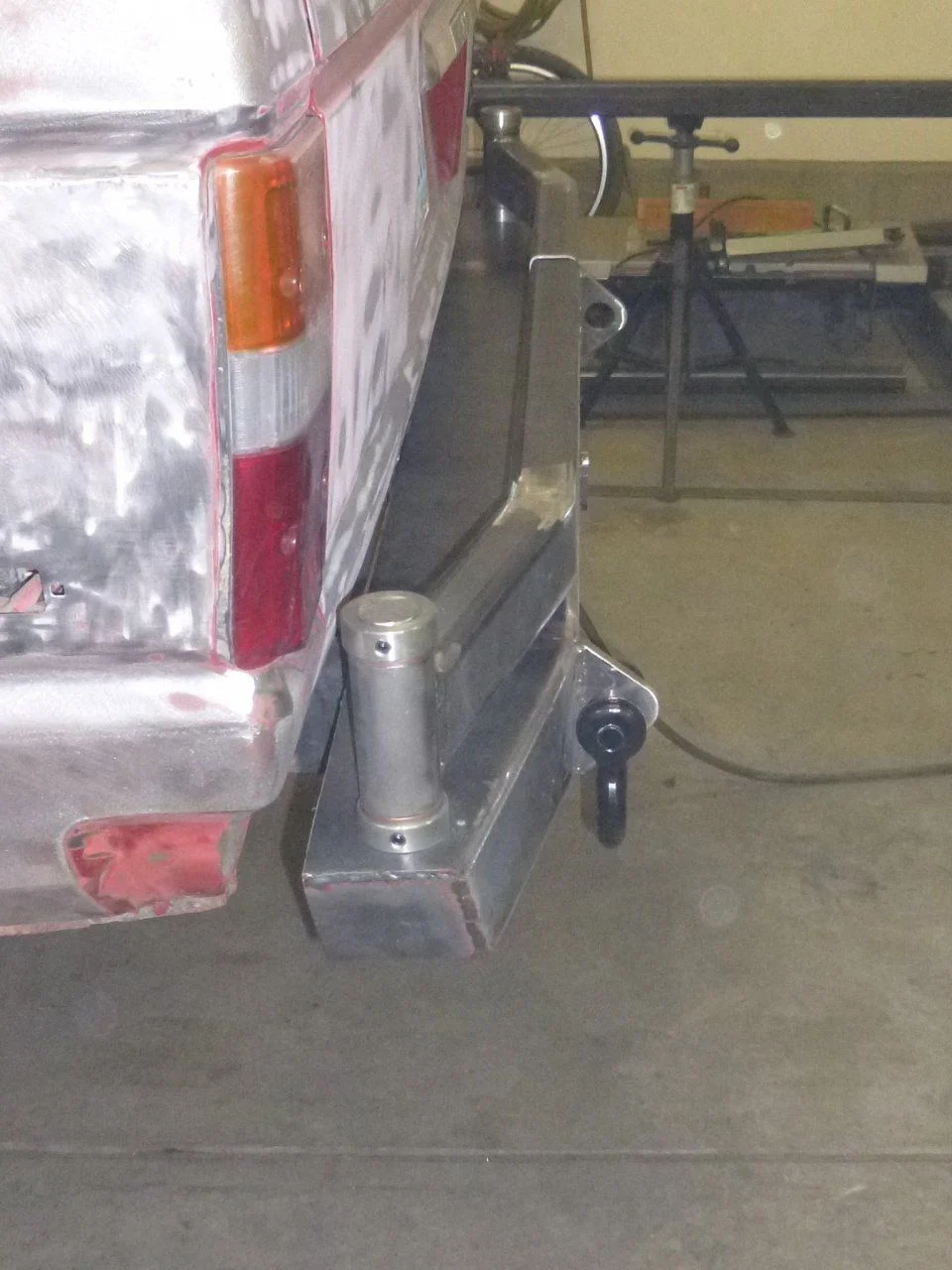

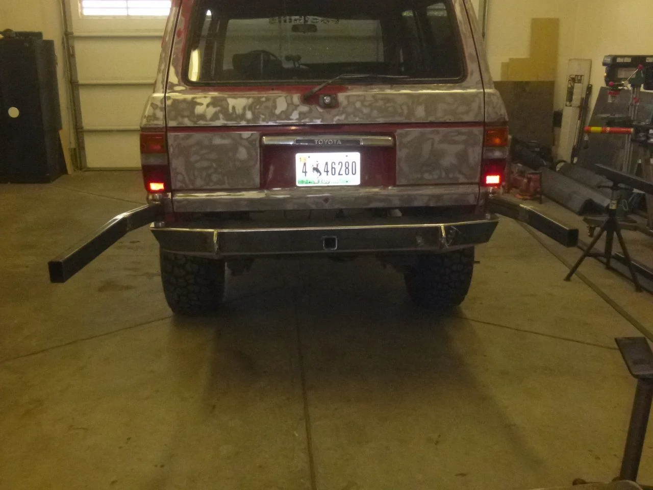

Got the base swing arms bent and welded up. Rest of the bumper is mostly welded, capped the ends off and cut the spindles.
J

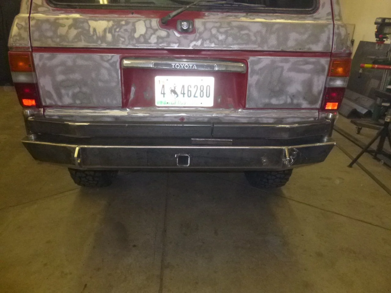

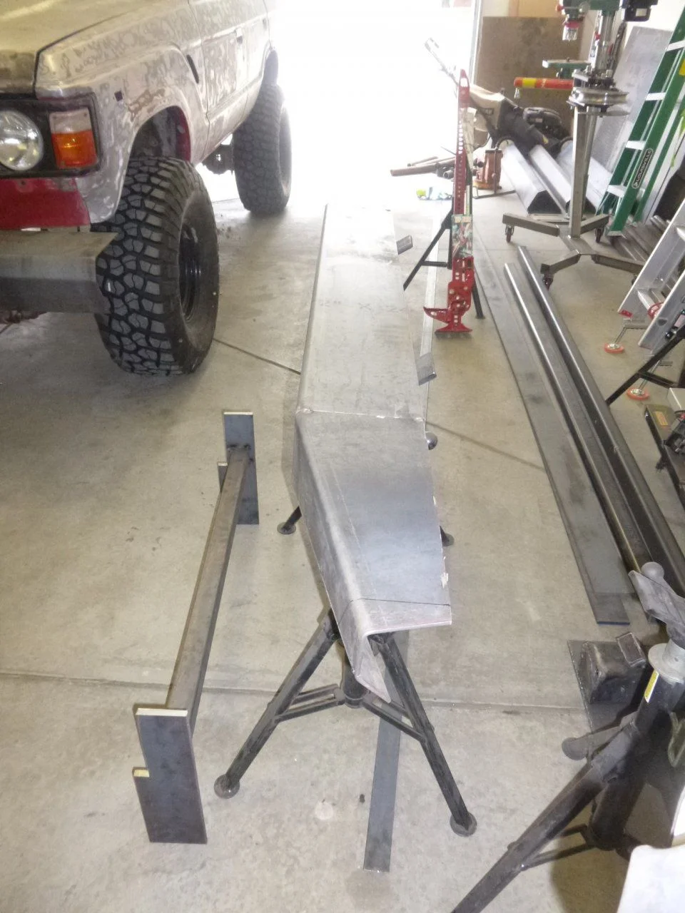

Figured I needed to make a showing today since Johnny and the boys seemed disappointed in my progess. So, I also got a customers rear bumper shell bent cut and tacked up and the frame mounts and receiver cross member tacked up as well.. :moon:

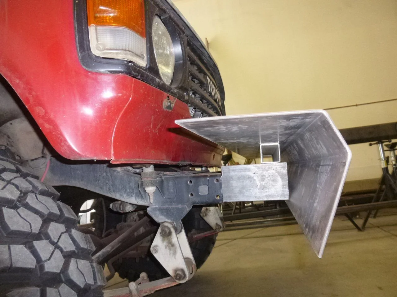

Hey J, What size rect. tube do you use for the swingouts? Also do you have any pics of the spindle welds? I need to get an idea of how its done...

D, I use 3" x 2" x .188" wall. I'm in for the night, but will take some pics of the spindle welds for you. I cut the 1.5" hole in the shell and weld both sides of the spindle penetration. I grind the "outside" weld flush with the shell and leave the "inside" weld as is. Then when you know your angle of the bumper, you can cut the spindle down and just weld it to the cap or shell on the "inside" as well.
I'll shoot you a pic tomorrow.
