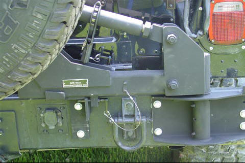

I checked ebay and google... it appears they are EXPENSIVE!! Unsure about the .gov liquidation stuff..
D, Whats the $$ COST??? If I could see one of these in a better pic... I wouldn't mind fabbing up a few if I could do it for a reasonable price to others...
J
Id give $100 spot for one..
the whole swingarm/unit is on ebay for like $700 but I think thats just cause its a Hummer speciality part and for no other reason. The hinge looks to be a piece of channel with a sleeve welded on both ends and the shaft sits inside. Kinda reverse of what we do with our swinouts...
Parts are too pricey to be in a range where someone would buy and plus it is a patented item. Pass on this one.
