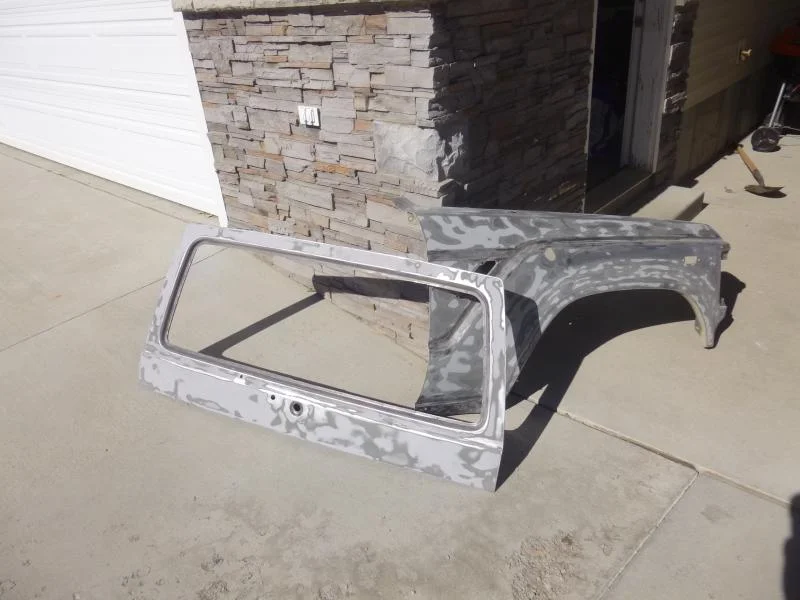

Spent some more time sanding this afternoon. PS fender and the upper rear hatch. The DS fender on Goss is better than my spare fender so I'll wait until I have access to the shop to strip the rest of the panels/shell down.

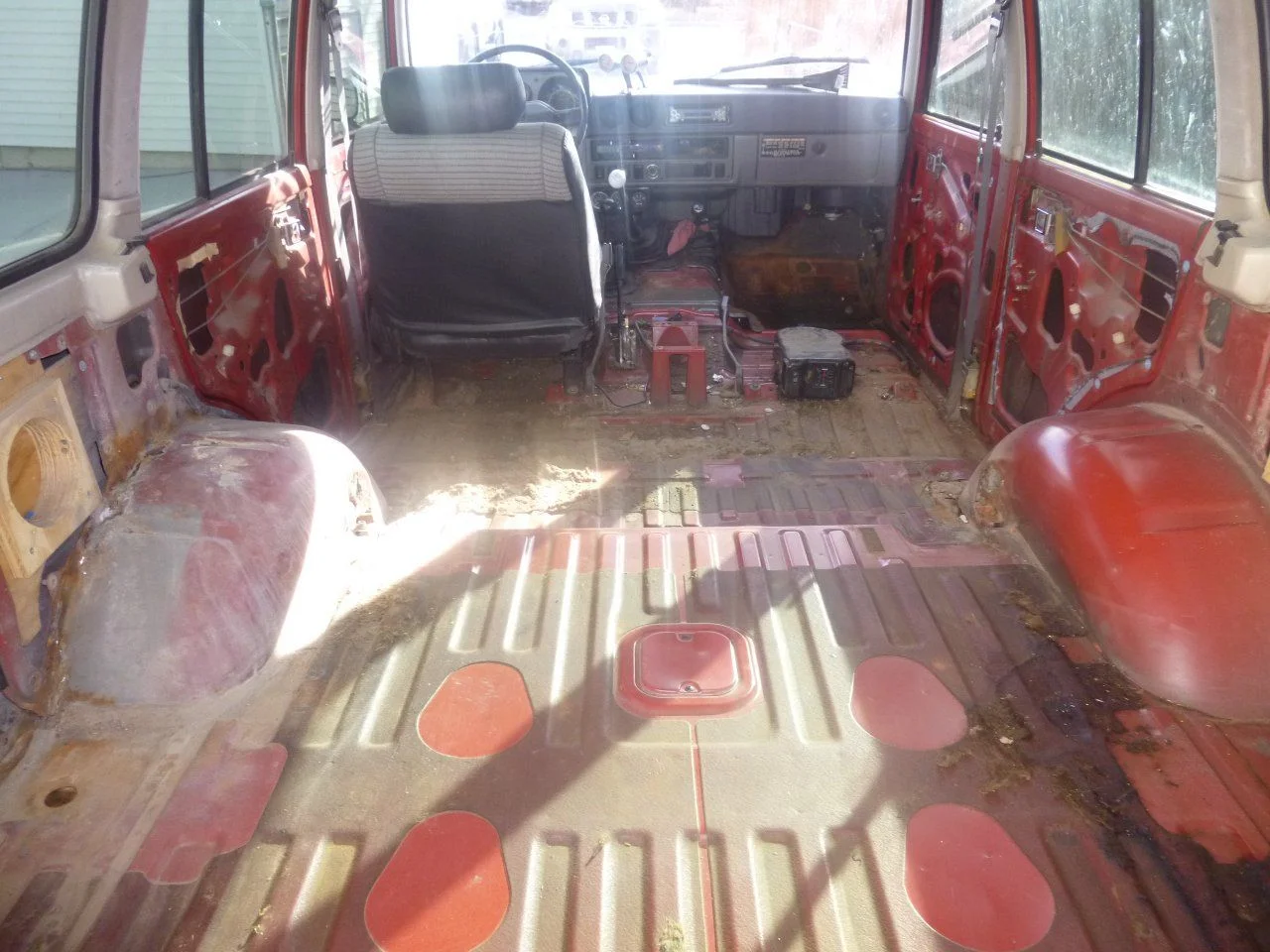

Plan on stripping the interior out tomorrow.

Lots of stockpiling, however, not much work on Goss.. removed all the interior (except drivers seat) , all the metal for ROOF RACK, SLIDER, FRONT/REAR BUMPERS , and cargo barrier arrived today, AC compressor and hoses are in the R&D stage.. about to pull the trigger on a set plus 1 of BFG KM2 345 75 16s SINCE THEY ARE BACK IN STOCK!!!!...

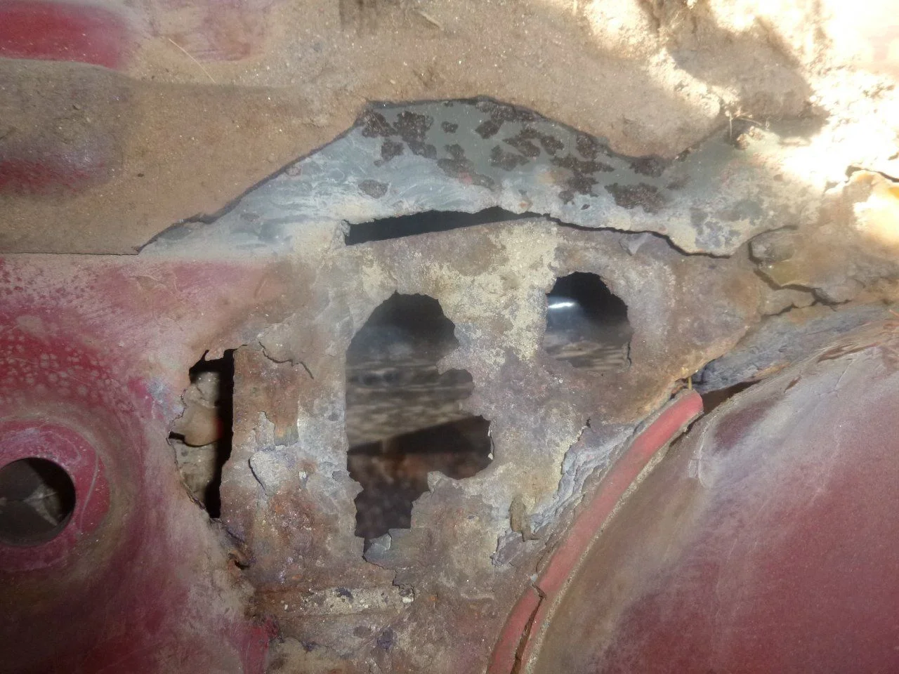

Good luck with the stereo typical rust rapair,
on one side I welded the seatbelt holder from the inside and now I have to do the outside next year so next time I will slash all the rust out...
The road check guy was using a little nasty screw driver and kept punching from the outside to the rust :(
You have no rear seatbelts?

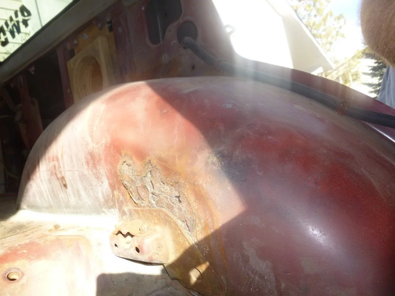

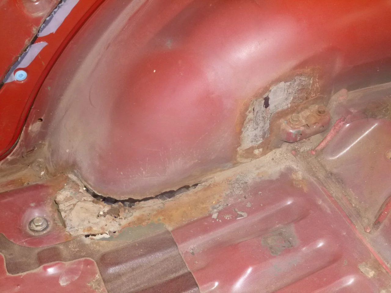

This is easy compared to my last two cruisers.. took the belts out for repairs and carpet/jute fitting. I'll cut the rust out in full and weld a new piece in everywhere needed.
