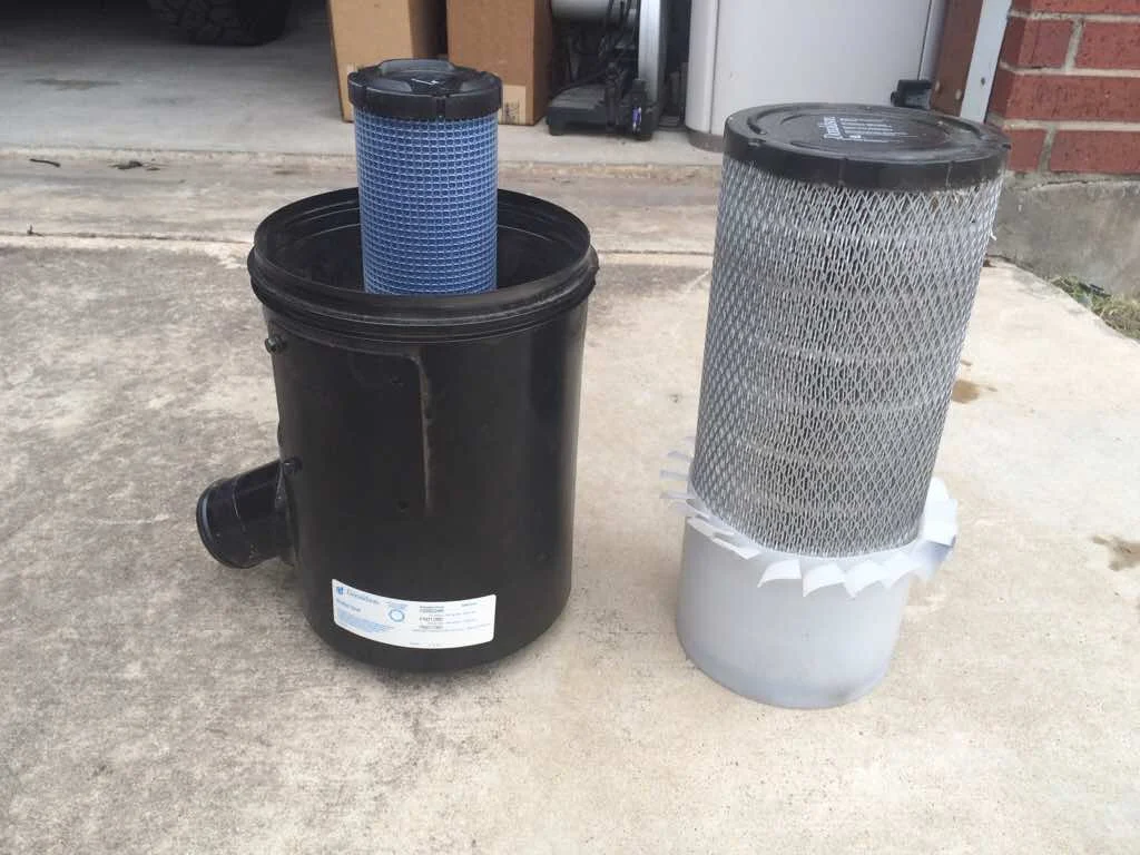

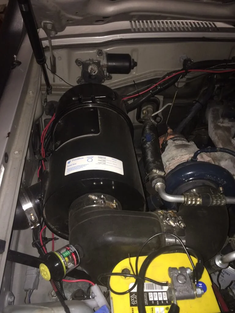

You just haven't driven enough. Those filters not filter out contaminants nearly as well as a paper filter. In addition, the surface area is not as large as the paper filter that came on the 4BT from the factory, meaning that they clog faster.
Only reason I'm running one is because I haven't saved up my pennies for a donaldson yet.
J, Do you have a part# for the Donaldson. Interested to see the specs.
J
@Mr Cimarron I believe has one in his truck. I don't remember the part number of the top of my head.
Here it is
You can zoom in on the part number. If you can't see I can post it later when I get home.
Filters aren't cheap. $20-$30 each. So far I've got about 7-8K on the current ones with the filter minder at about 3/4.

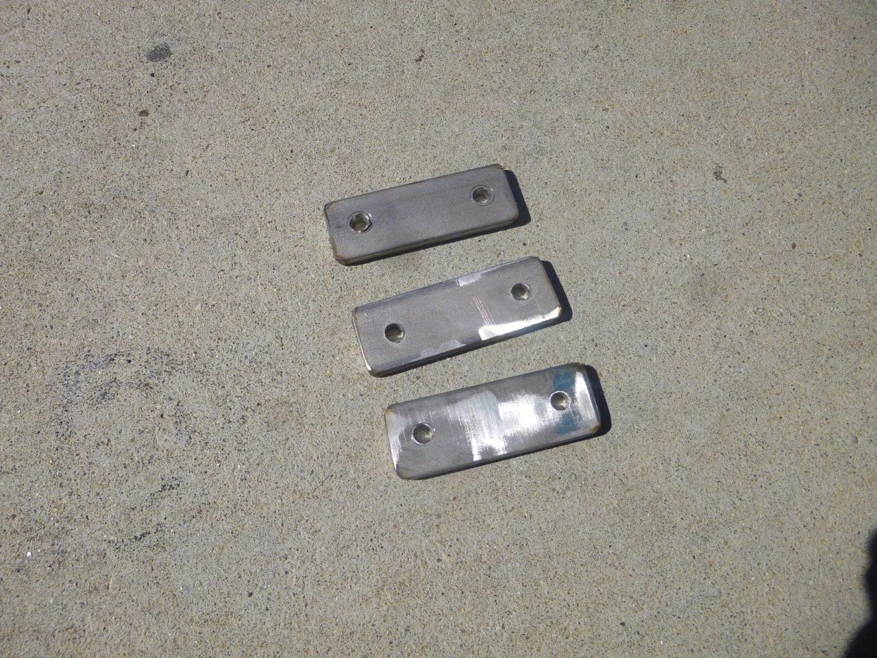

Made some stainless backing brackets to mount my ARB awning. Got my Wits'End organizer from @NLXTACY installed and a few other things...
