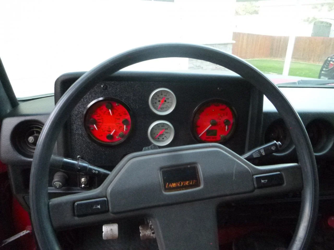

ALL INSTALLED---- New motor mount bolts, gauges, new boost line run, dash and cap, B-pillar covers, clam shell painted, screwed down the shifter plate, shift knobs & bushings, oil change and new floor mats....

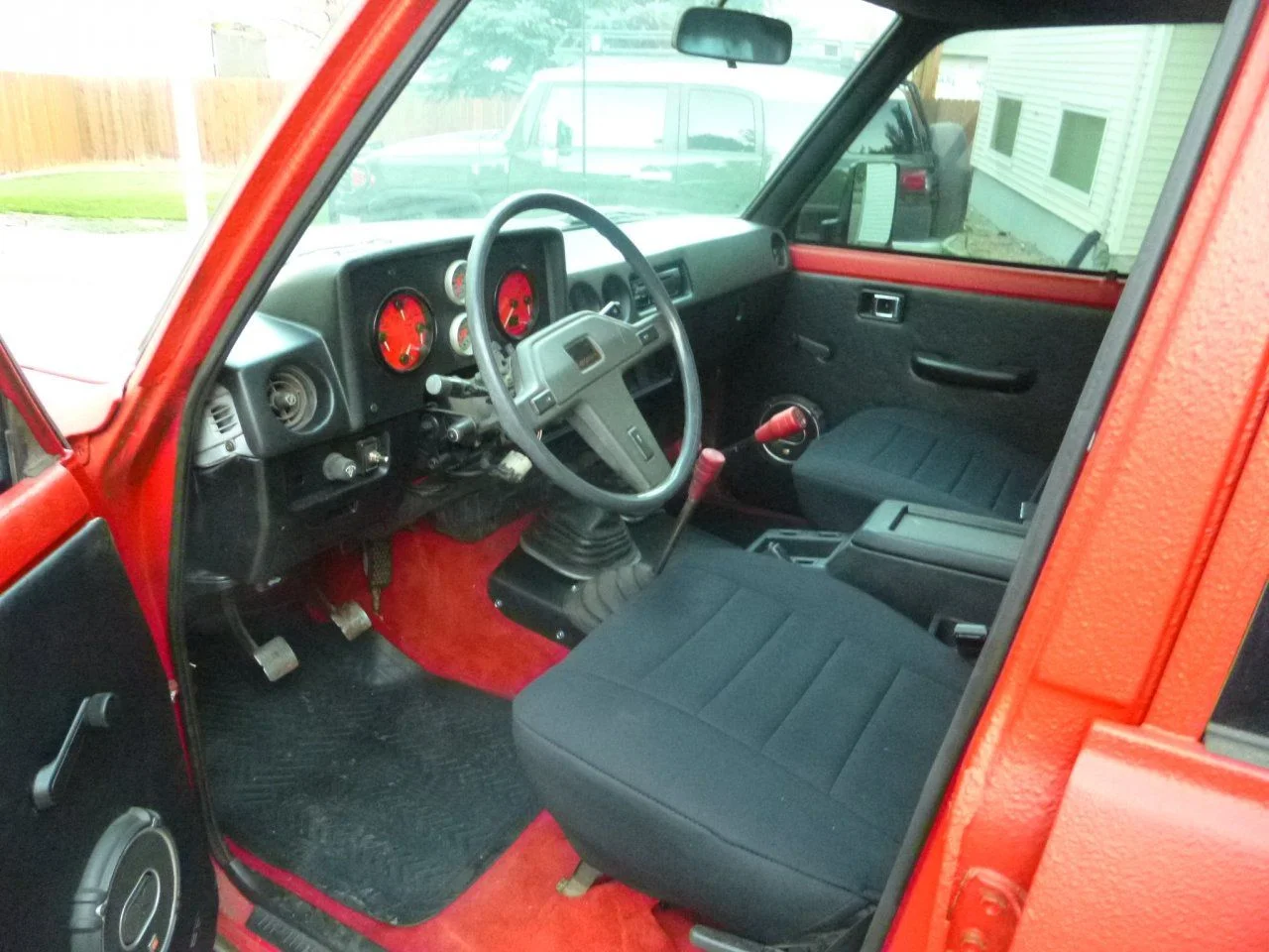

VERY clean work! love this cruiser

Very nice. I thought your windows were tinted much darker though?
Also where is the Momo?
Man... I'm running out of time... I'm just trying to get things workable/road worthy right now.. AC surround, MOMO, RTT etc.... not this go around unfortunately.

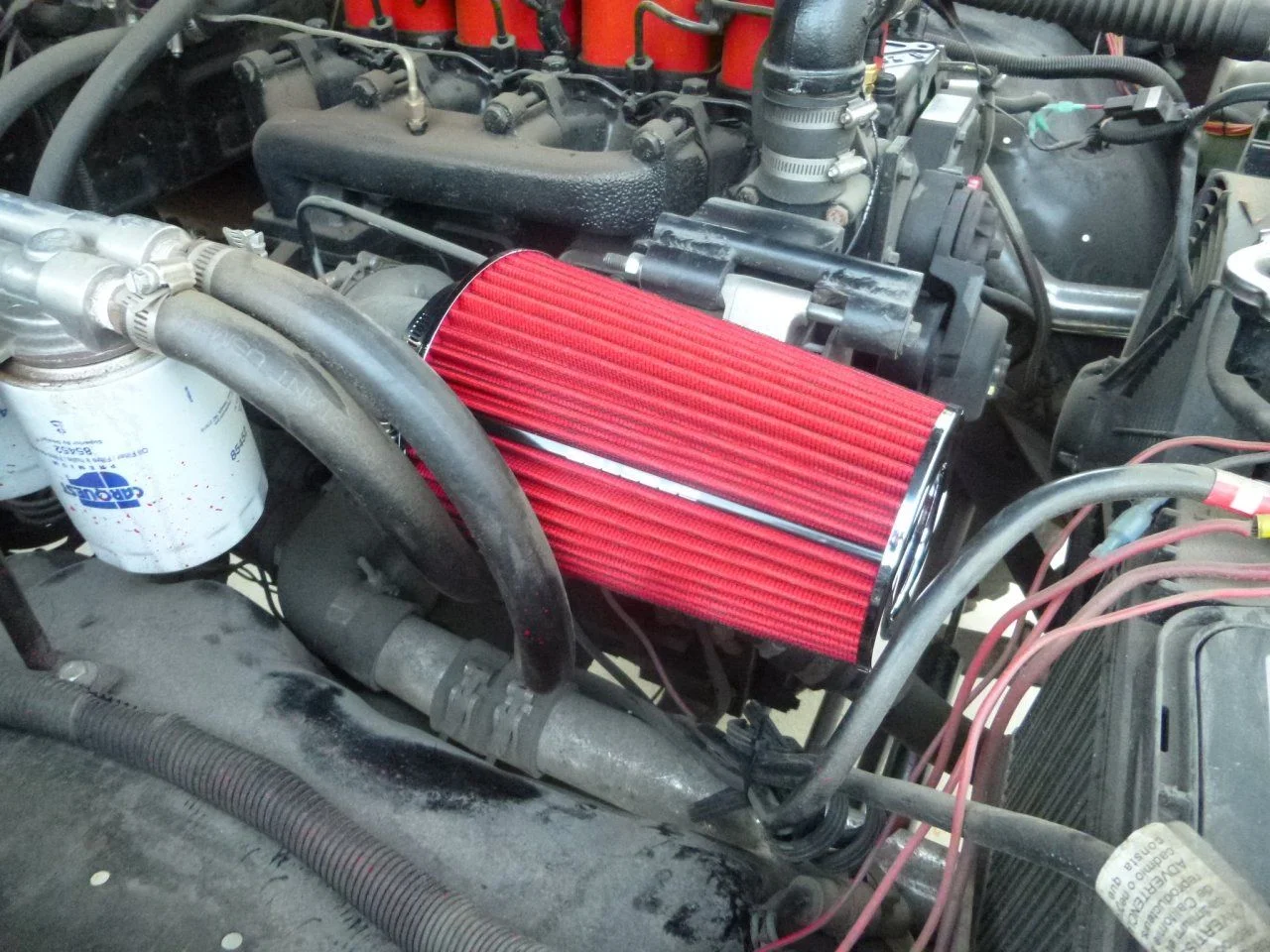

POD filter/air filter?? no issues in 19 months and 24mpg on avg... I'm happy with them.
J
You just haven't driven enough. Those filters not filter out contaminants nearly as well as a paper filter. In addition, the surface area is not as large as the paper filter that came on the 4BT from the factory, meaning that they clog faster.
Only reason I'm running one is because I haven't saved up my pennies for a donaldson yet.
