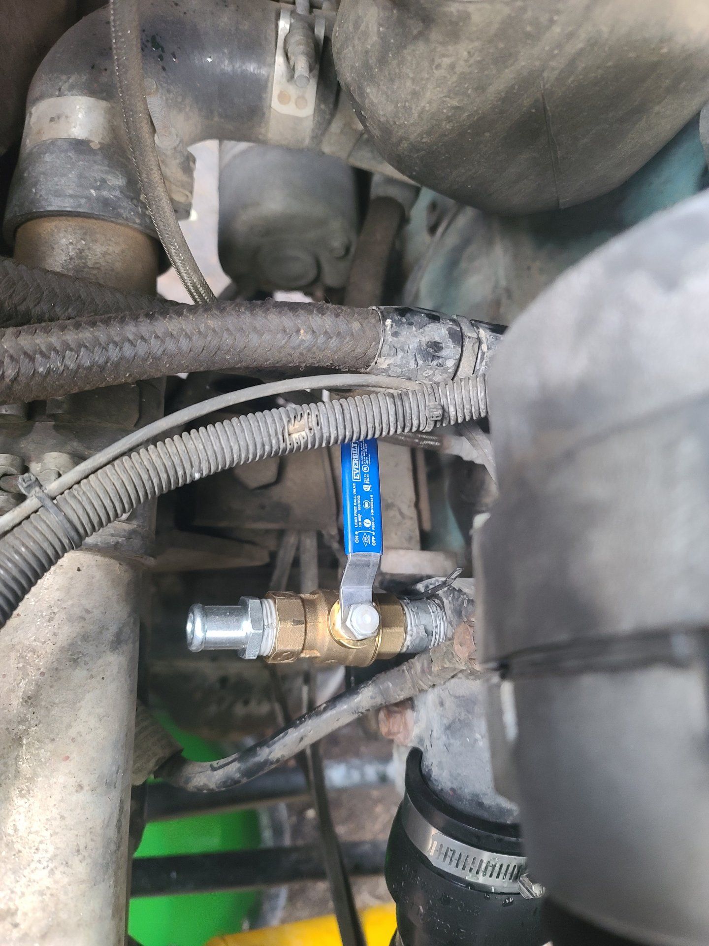

Alright well since the engine pissed out all it's coolant Friday. I decided today to an additional fix. Heater hoses.....On a 4BT one is supposed to come off of the thermostat housing to supply the delightful 220° during the winter. The other is supposed to be connected to outlet housing (keeps the flow faster). This engine had that hose going back into the head through a pipe (picture of it in my hand) that was put in a freeze spot instead of going to the outlet side of the engine. I also put a cutoff valve in to save my nuts from sweating so much during the summer. I also did more plumbing today. In the pictures you can see a T fitting that I added. For now it has a plug in it. On 4/6BTs there is usually a drain cock at the highest point for burping the system. I will add that later.
So if you have been following this since the beginning, you know heating has always been an issue with this vehicle. Well now I have pretty much replaced everything except for the radiator, top hose, and thermostat.
You used a Fernco flexible coupling and PVC s40 for your coolant line, s40 pvc max temp is 73F and only to be used on cold water :rolleyes: o_O
Well damn it. Hopefully it will last till I can get a steel adapter. :censor:
So far it hasn't sprang a leak after getting iy up to 220.
Got any recommendations @Hojack ?
Thanks @Hojack. I got to work this morning and measured the hose adapter/hose that came off of it Saturday. I just can't seem to find an adapter that goes from 2.25" to 1.5". I think if it will last a little while, I will get a hold of a machine shop and get that made. God custom parts are so damn expensive.
Here for your entertainment @GLTHFJ60.
Better @Hojack?
I guess the hump on the galv street 90 would work with a hose clamp but I’d use a barbed hose adapter instead of the 1-1/4” galv nipple.
Yeah I am going to shave down the ridges on the fitting that are used to help tighten the fitting ( had to get rid of the 90 and use a straight), paint it to look perdy and help from rusting, and use hose clamps to let the lips act like a nipple flaring.
I know I know... to help prevent nipple flaring, I should use pasties. :couchpotato:
