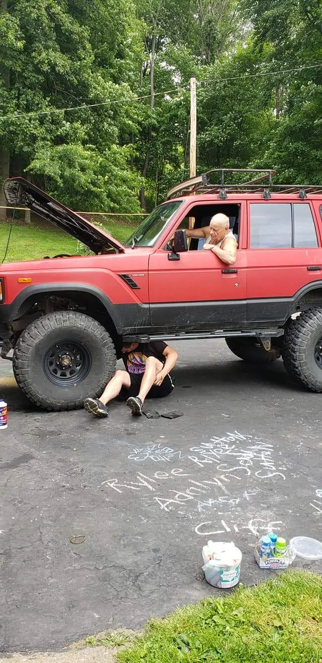

Ok I started by driving from Maryland to Ohio to stop for a couple days to see family. Well first was the brakes needed some attention. TJ was a 🍑 and had pads, rotors, and rear shoes w/ hardware. So I took a day with my grandpa and got to work. We did pads, rotors, got new calipers, and balanced the tires a little bit.

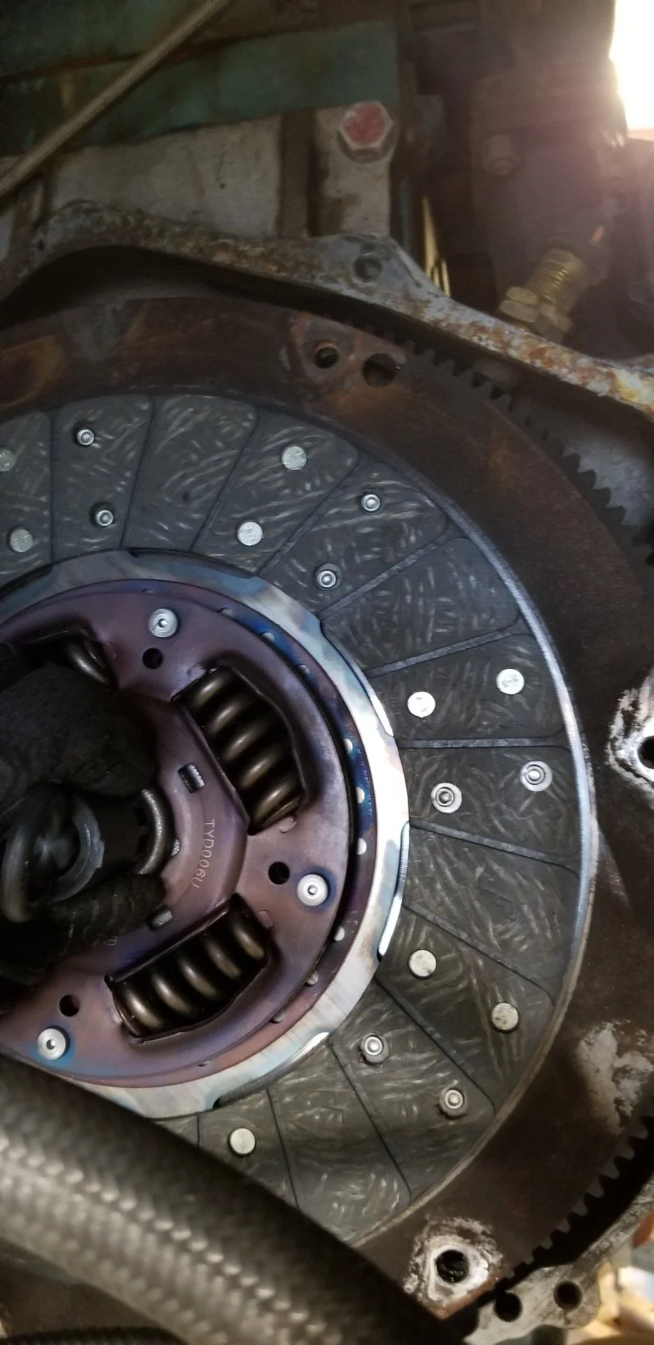

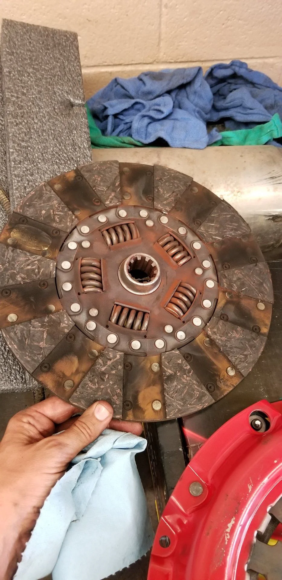

Well I have been working on it here and there. First that had to go (and it did because a gas clutch on a diesel doesn't hold up well). Luckly I was done wheeling and off the mountain when the clutch finally died.
Well I got a hold of of South Bend gave the measurements of the splines and clutch surface. Got a clutch sent to me rated for over 600 ft lbs. Put a new air filter on it. Changed all the fluids and Gossamer was rolling black again.

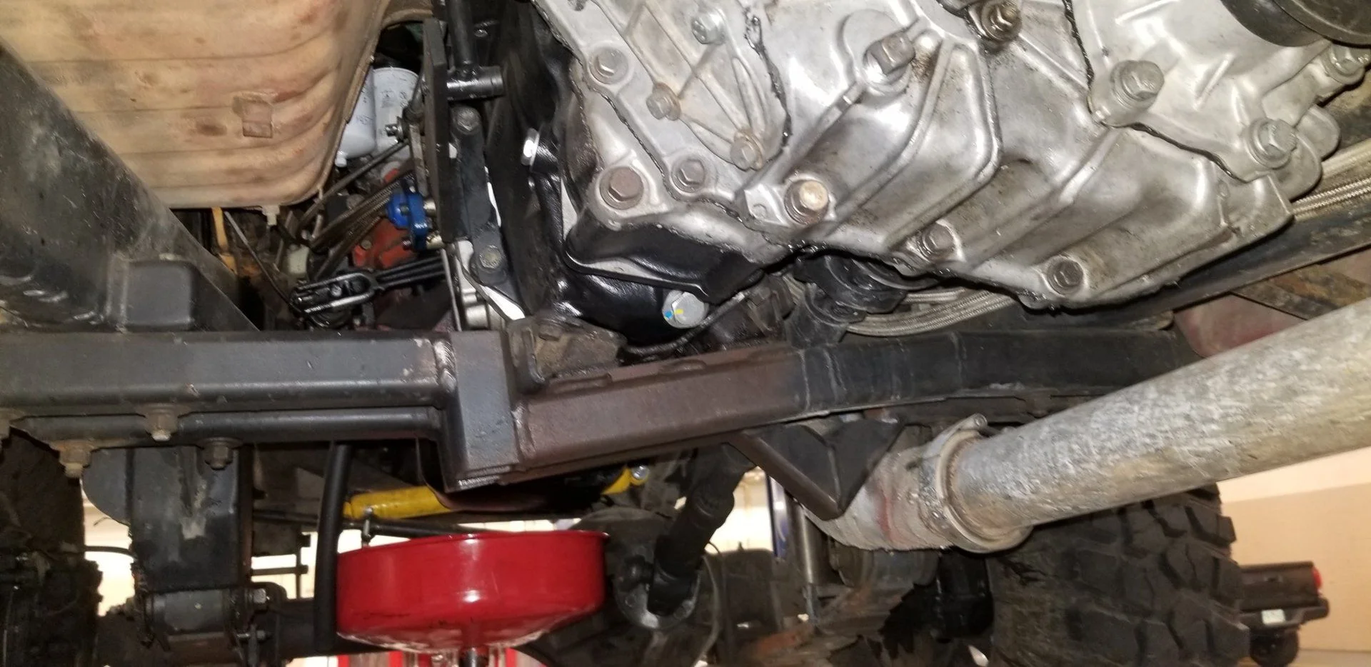

Well finally got it going strong. Well then another problem started happening. The H/L selector shaft in the transfer case kept falling in it. Yeah the one the linkage holds up. There was one day of wheeling it fell in 3 different times. Lucky for me I like to take tools and fluids wheeling. Kept pulling that side plate off the transfer case and using a magnet and pry bar I got it back in.
