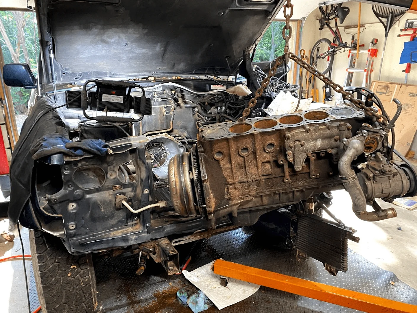

I pulled it into the garage, disconnected the trans from the engine, and pulled the later two weekends ago.

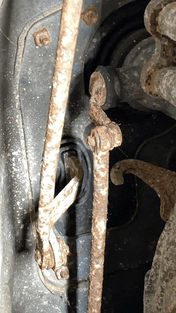

Rust is such a pain in the ass. I haven't found any in the body worth mentioning (less in fact than a couple of "rust free" 80's I've had before) but all of the fasteners underneath are of course a struggle. This is the transmission and transfer case linkage.

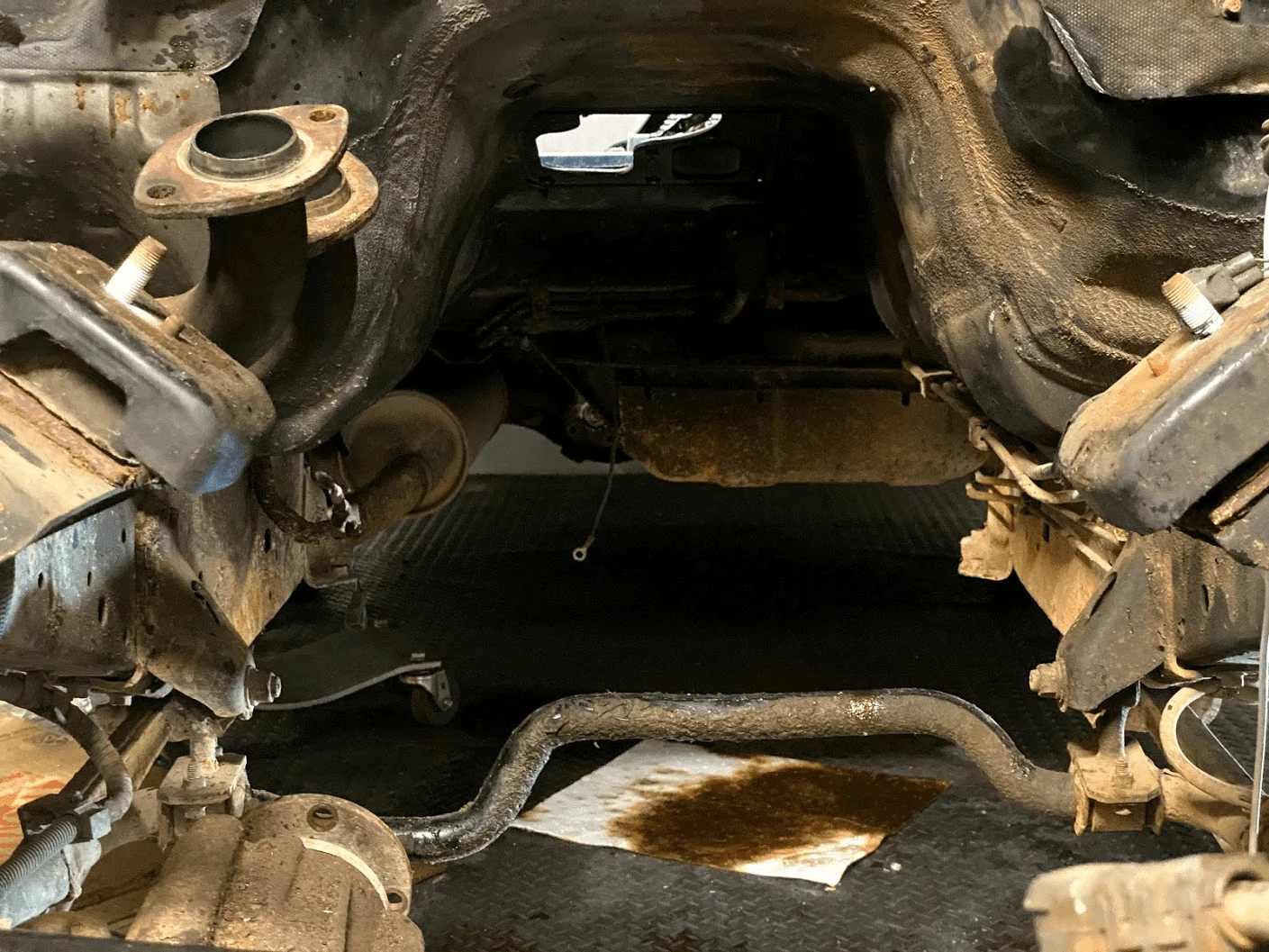

So this is how Goose Poop sits now, ready for my Land Cruiser Shop LS mounts, the $500 quarry truck 4.8 with cam and springs that was my first LS build, a marks adapter and craigslist 4l80e. I've gone with Holly instead of an unlocked stock ECU and harness.
